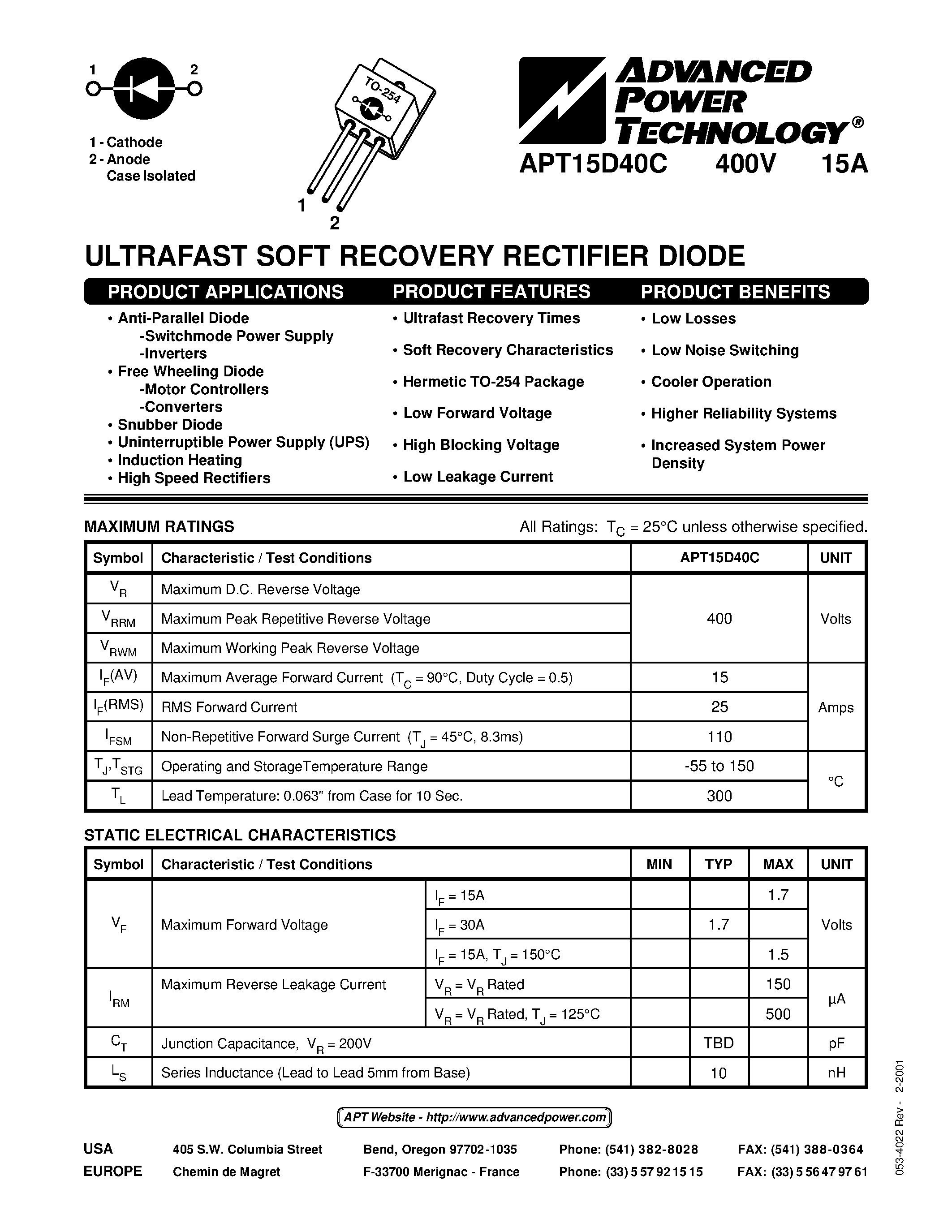

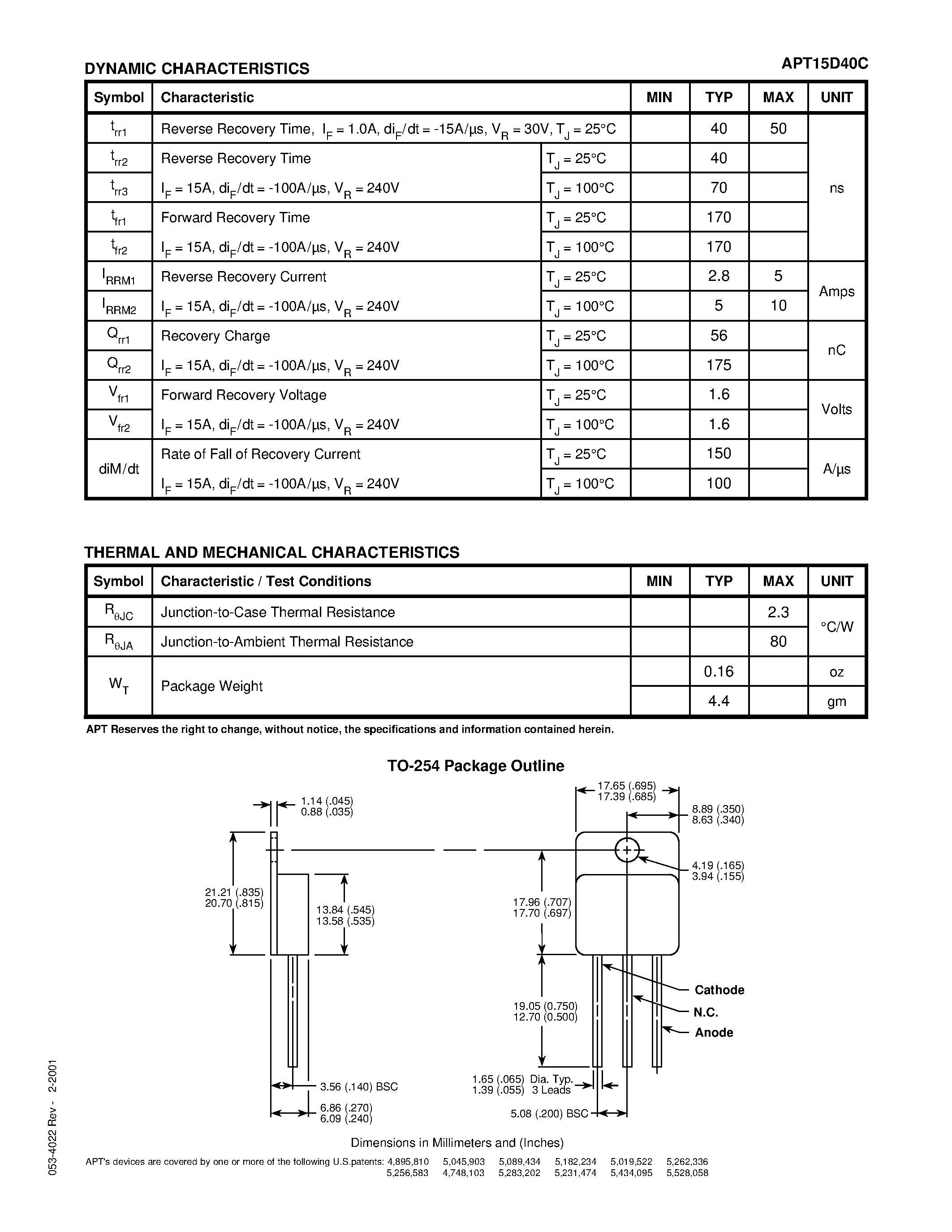

APT15D30C-ULTRAFAST SOFT RECOVERY RECTIFIER DIODE
Description:ULTRAFAST SOFT RECOVERY RECTIFIER DIODE
Others with the same file: APT15D30C
Datasheet APT15D30C - ULTRAFAST SOFT RECOVERY RECTIFIER DIODE page 1
Datasheet APT15D30C - ULTRAFAST SOFT RECOVERY RECTIFIER DIODE page 2
