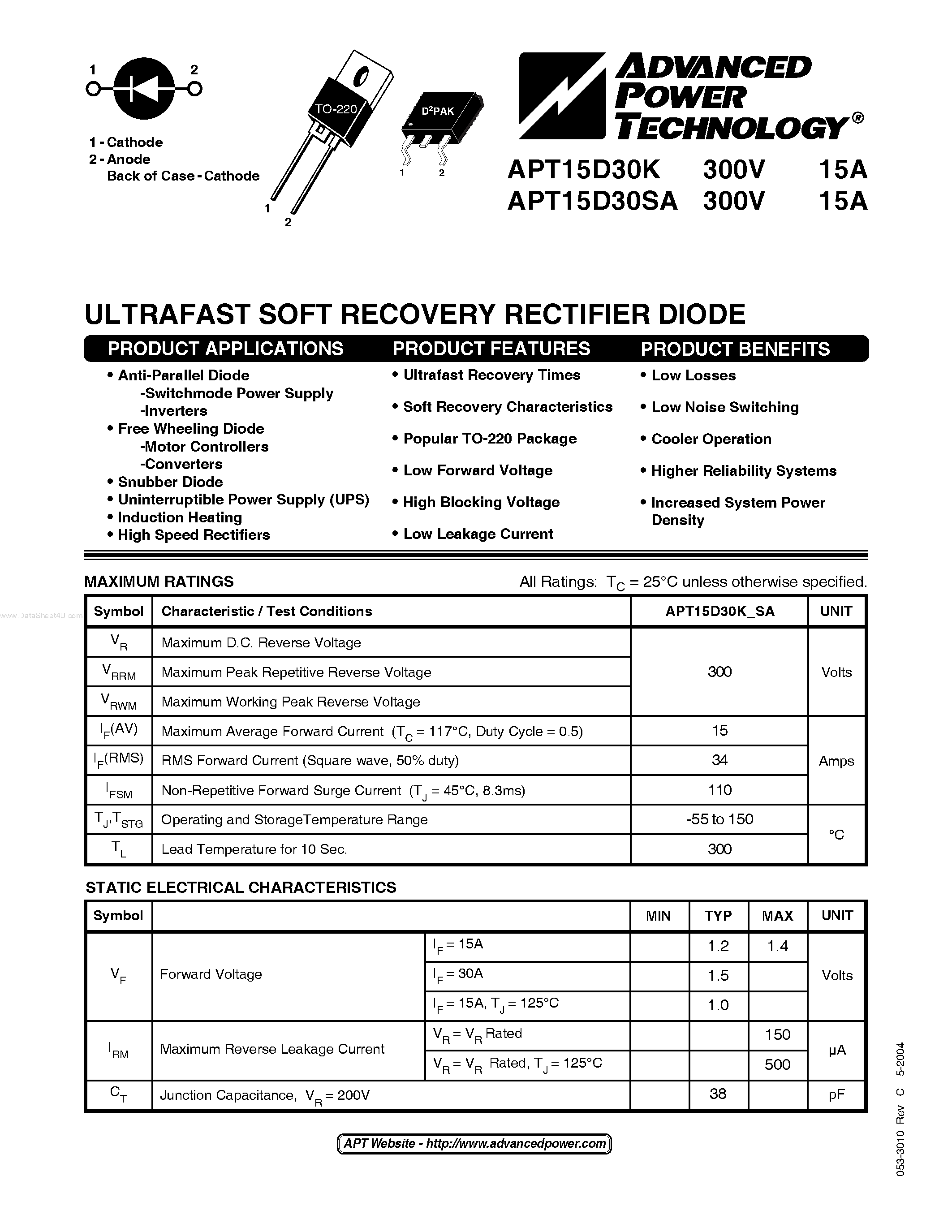

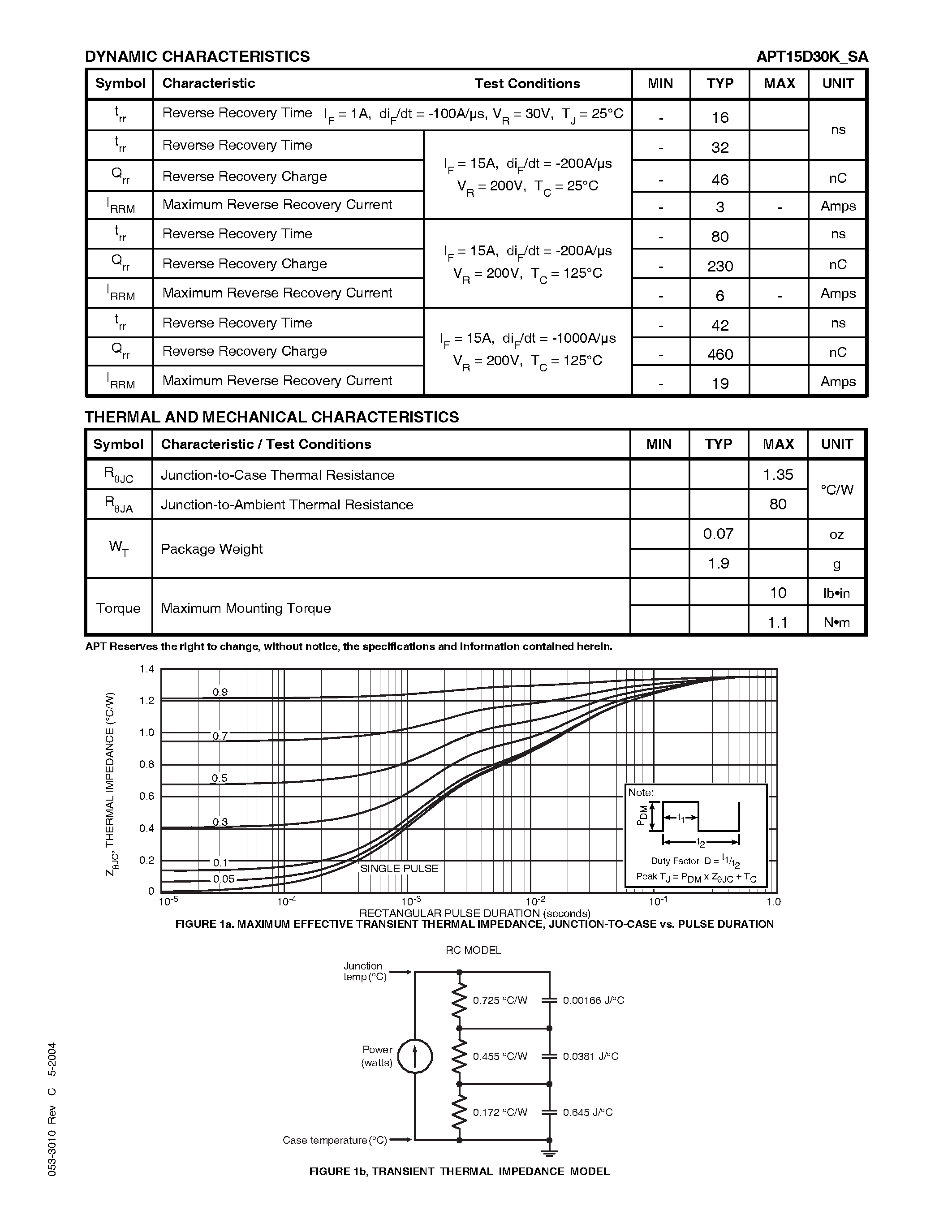

APT15D30SA-ULTRAFAST SOFT RECOVERY RECTIFIER DIODE
Description:ULTRAFAST SOFT RECOVERY RECTIFIER DIODE
Others with the same file: APT15D30SA
Datasheet APT15D30SA - ULTRAFAST SOFT RECOVERY RECTIFIER DIODE page 1
Datasheet APT15D30SA - ULTRAFAST SOFT RECOVERY RECTIFIER DIODE page 2
