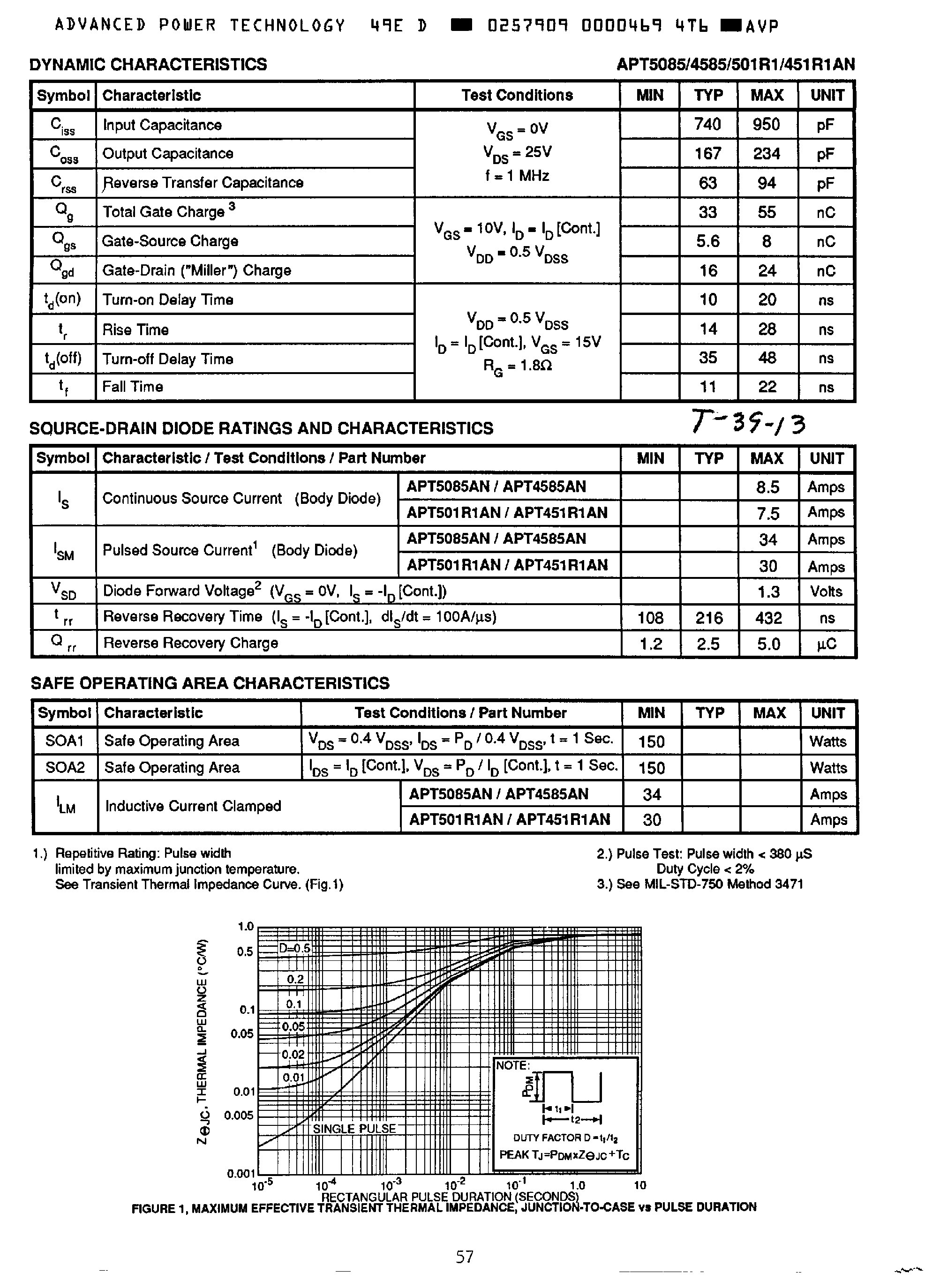

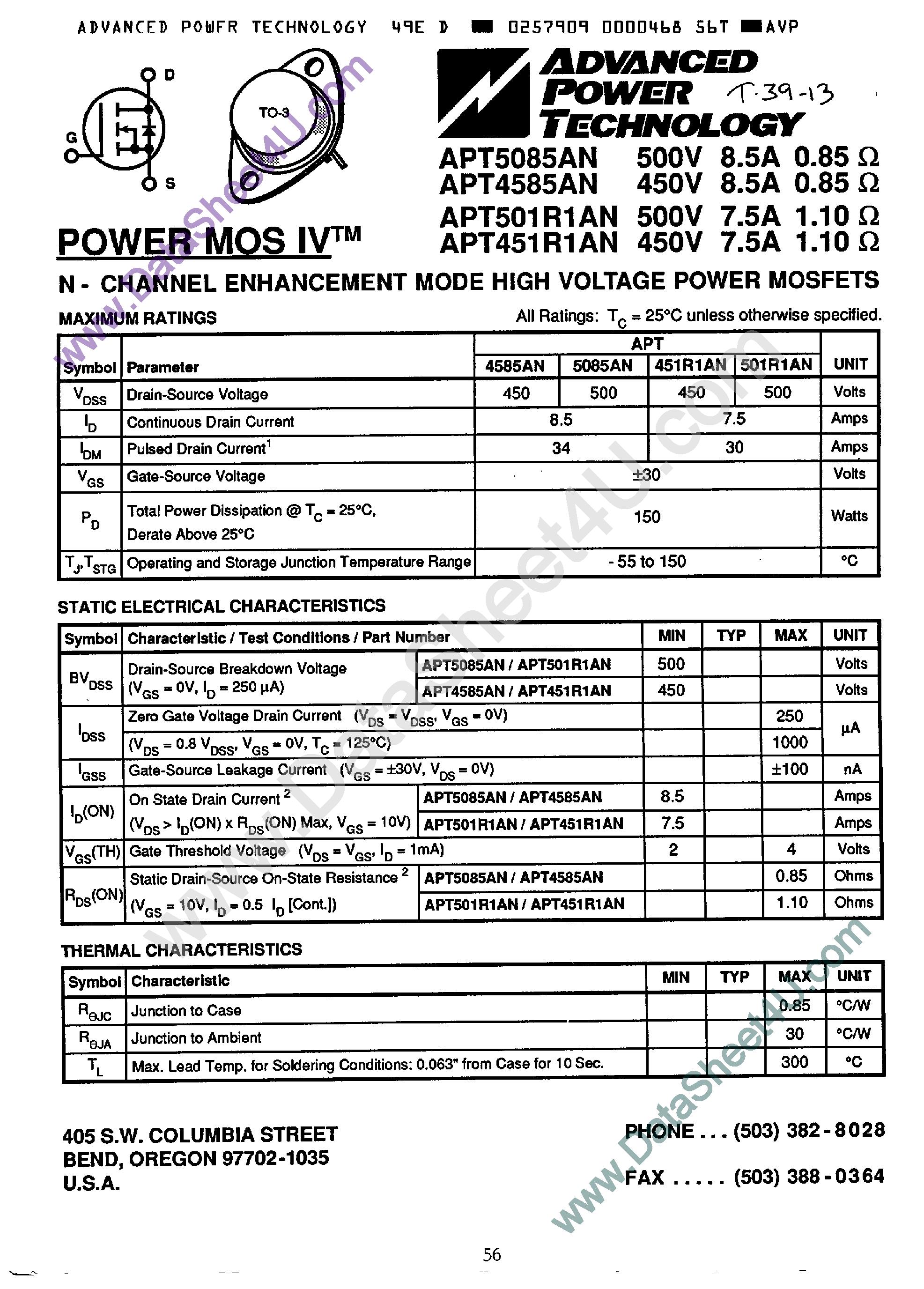

APT451R1AN-(APT5085AN / APT4585AN / APT501R1AN / APT451R1AN) N-Channel Enhancement Mode High Voltage Power MOSFET
Description:(APT5085AN / APT4585AN / APT501R1AN / APT451R1AN) N-Channel Enhancement Mode High Voltage Power MOSFET
Others with the same file: APT451R1AN | APT4585AN
APT501R1AN | APT5085AN
Datasheet APT451R1AN - (APT5085AN / APT4585AN / APT501R1AN / APT451R1AN) N-Channel Enhancement Mode High Voltage Power MOSFET page 1
Datasheet APT451R1AN - (APT5085AN / APT4585AN / APT501R1AN / APT451R1AN) N-Channel Enhancement Mode High Voltage Power MOSFET page 2
