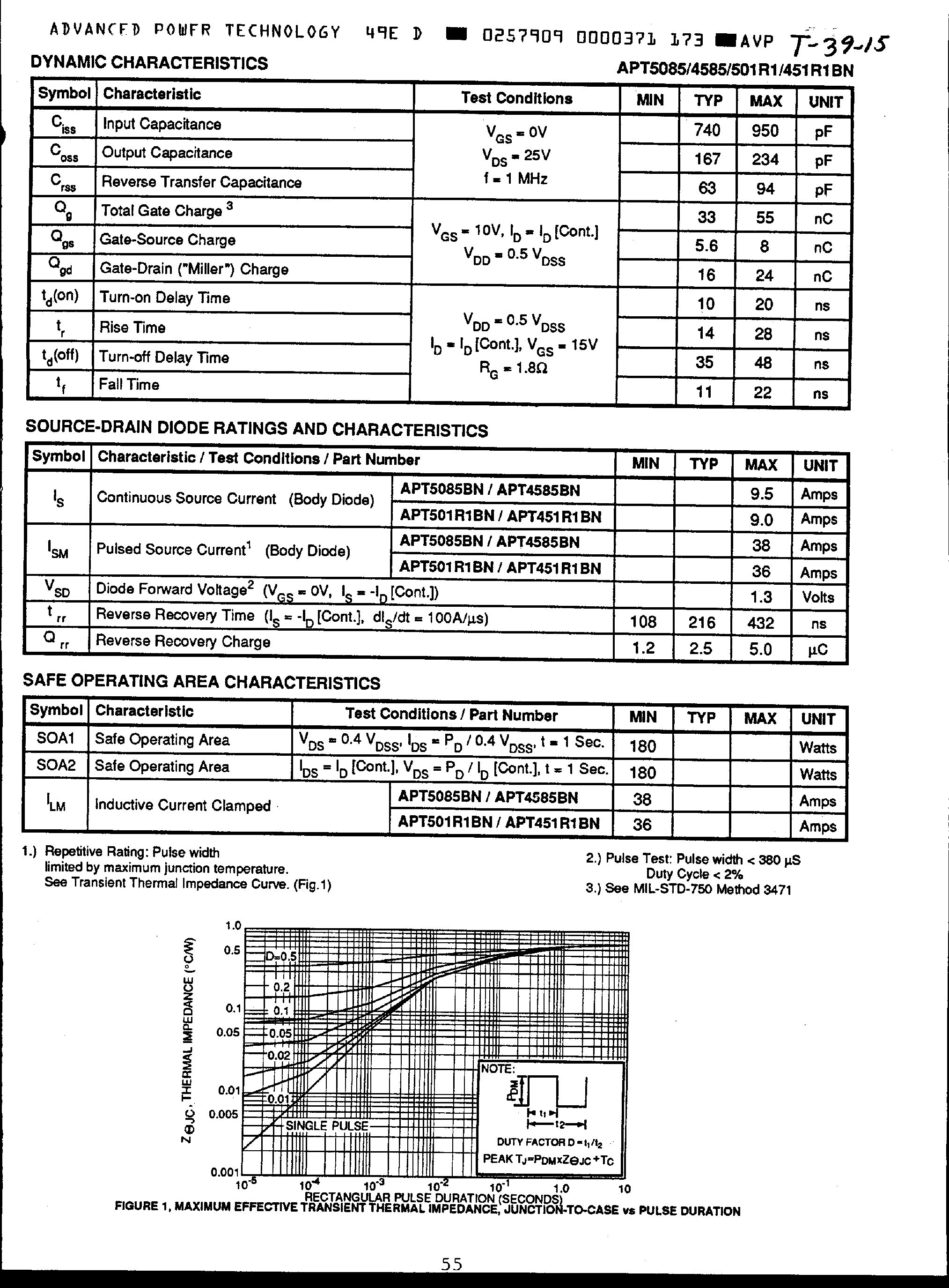

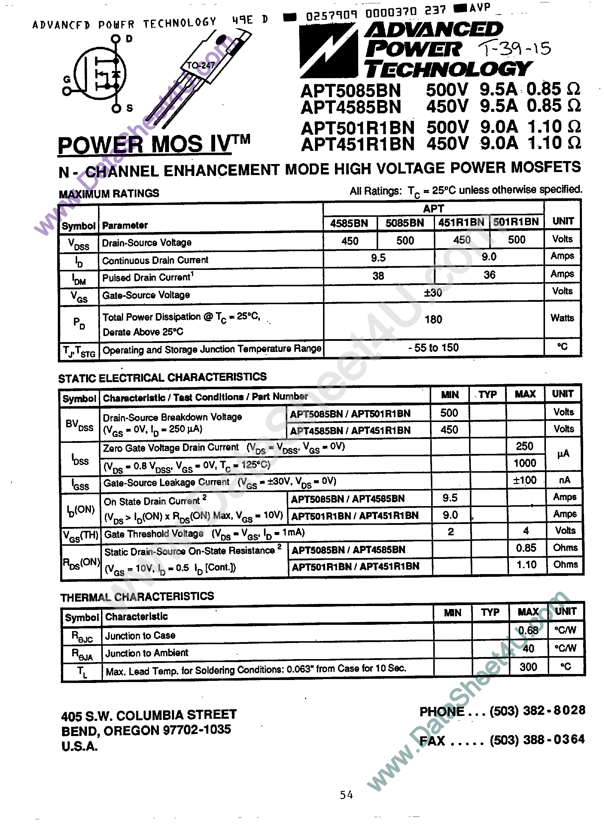

APT451R1BN-(APT5085BN / APT4585BN / APT501R1BN / APT451R1BN) N-Channel Enhancement Mode High Voltage Power MOSFET
Description:(APT5085BN / APT4585BN / APT501R1BN / APT451R1BN) N-Channel Enhancement Mode High Voltage Power MOSFET
