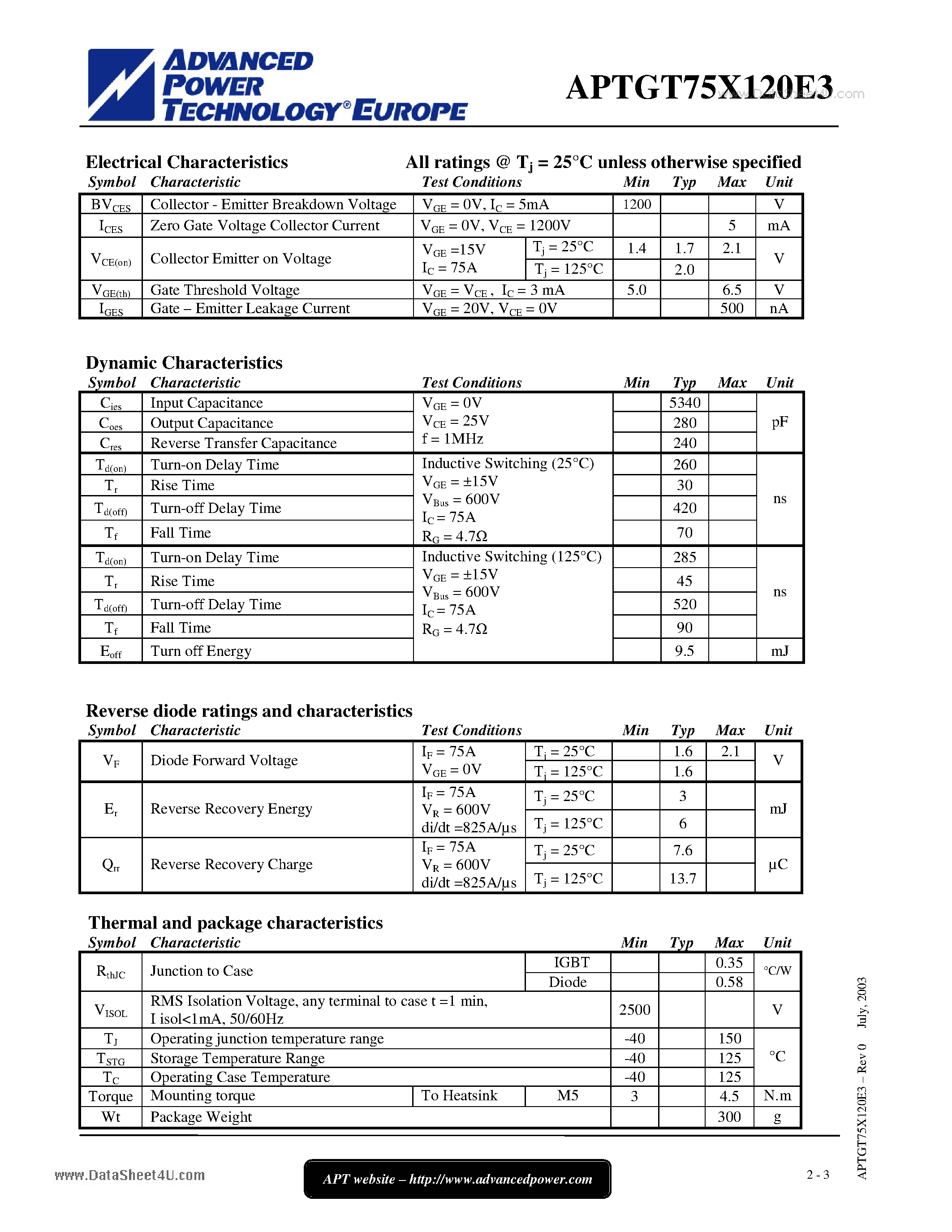

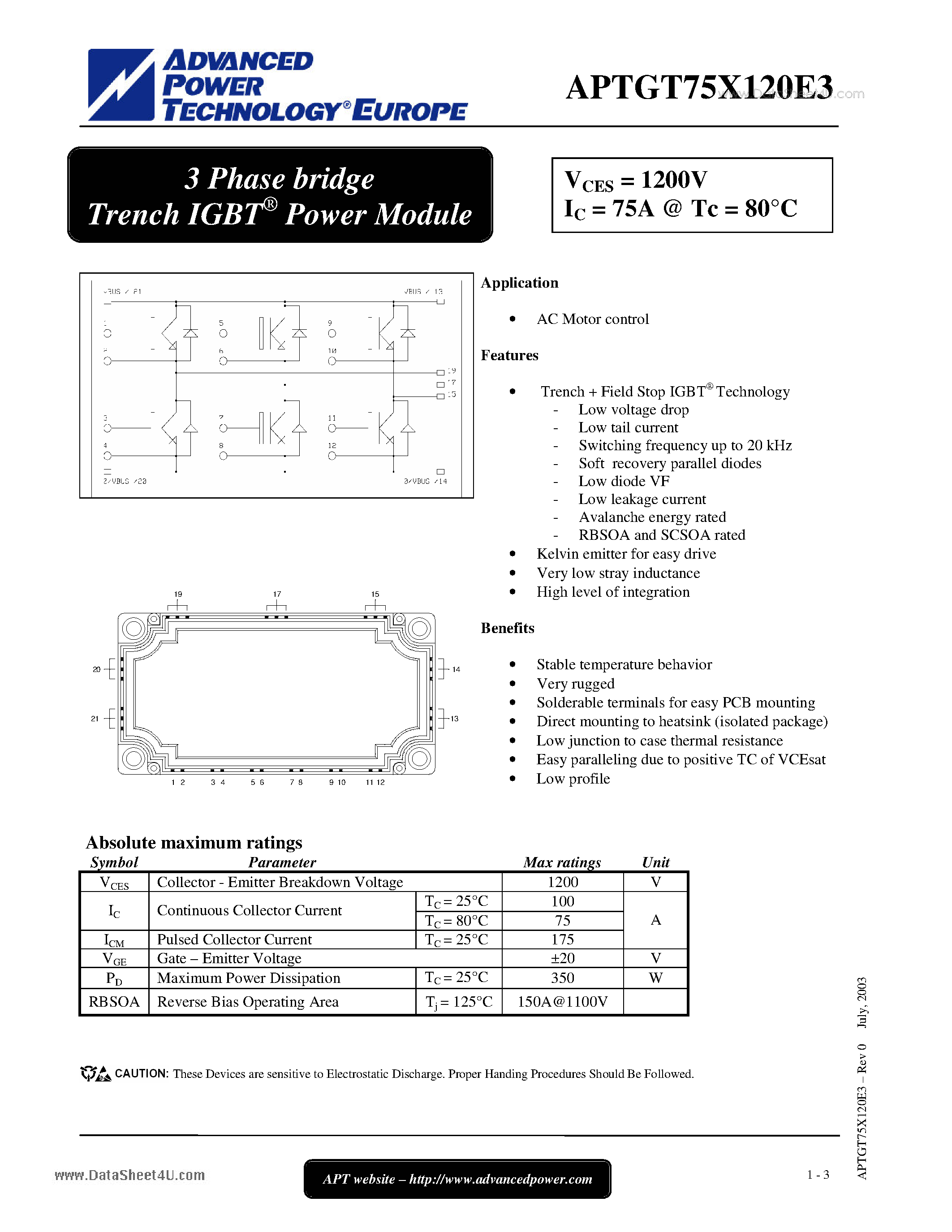

Datasheet APTGT75X120E3 - 3 Phase bridge Trench IGBT Power Module page 1
Datasheet APTGT75X120E3 - 3 Phase bridge Trench IGBT Power Module page 2
