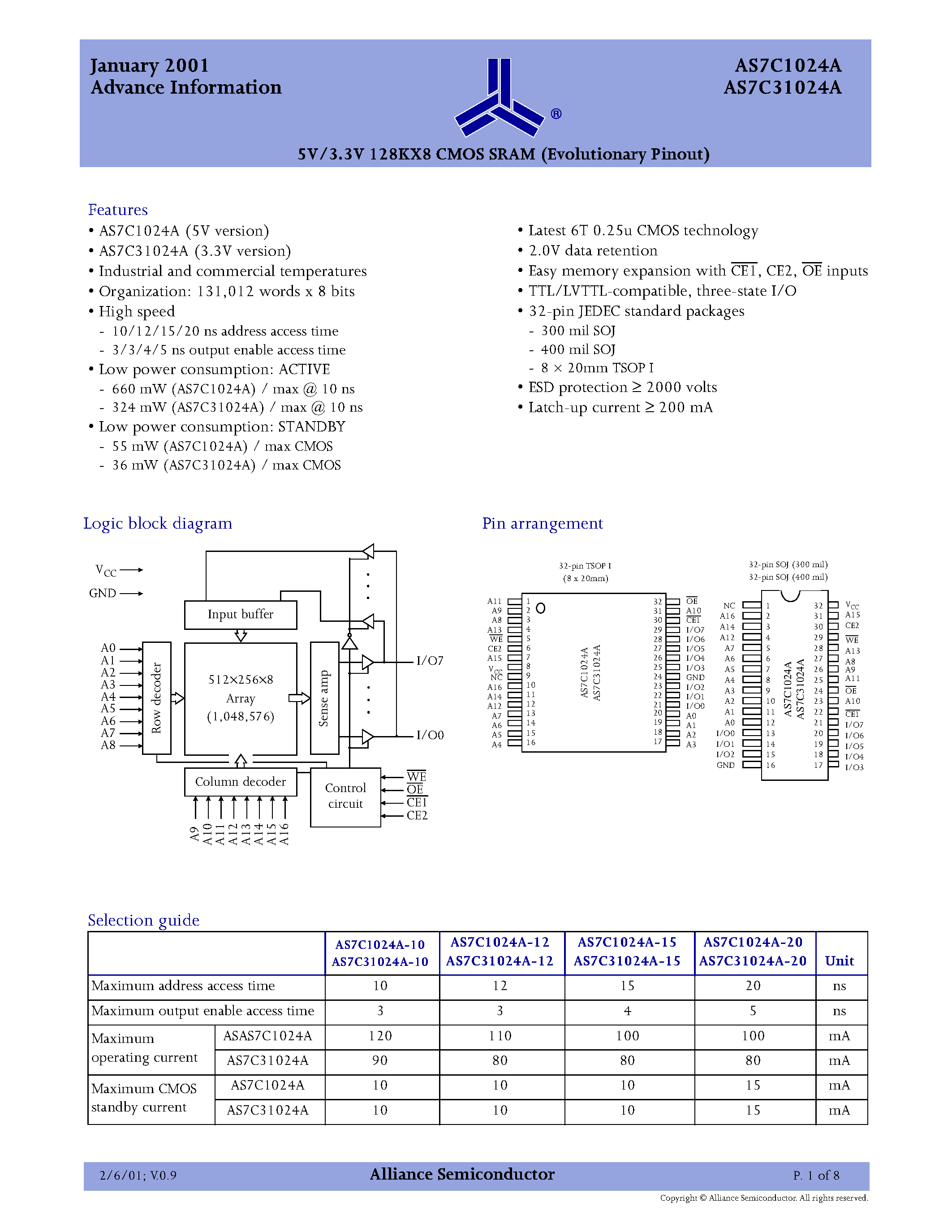

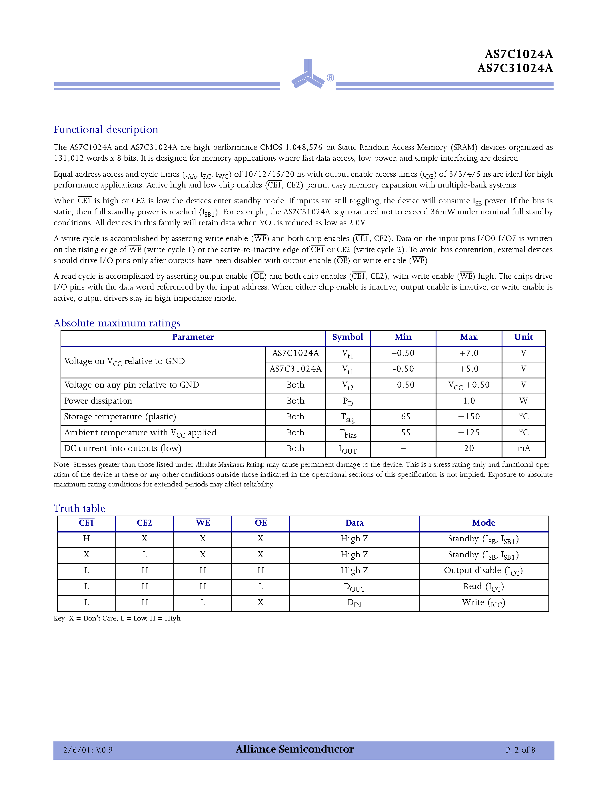

AS7C31024A-12TC-5V/3.3V 128KX8 CMOS SRAM (Evolutionary Pinout)
Producer:ETC
Description:5V/3.3V 128KX8 CMOS SRAM (Evolutionary Pinout)
Others with the same file: AS7C31024A-12TC
Datasheet AS7C31024A-12TC - 5V/3.3V 128KX8 CMOS SRAM (Evolutionary Pinout) page 1
Datasheet AS7C31024A-12TC - 5V/3.3V 128KX8 CMOS SRAM (Evolutionary Pinout) page 2
