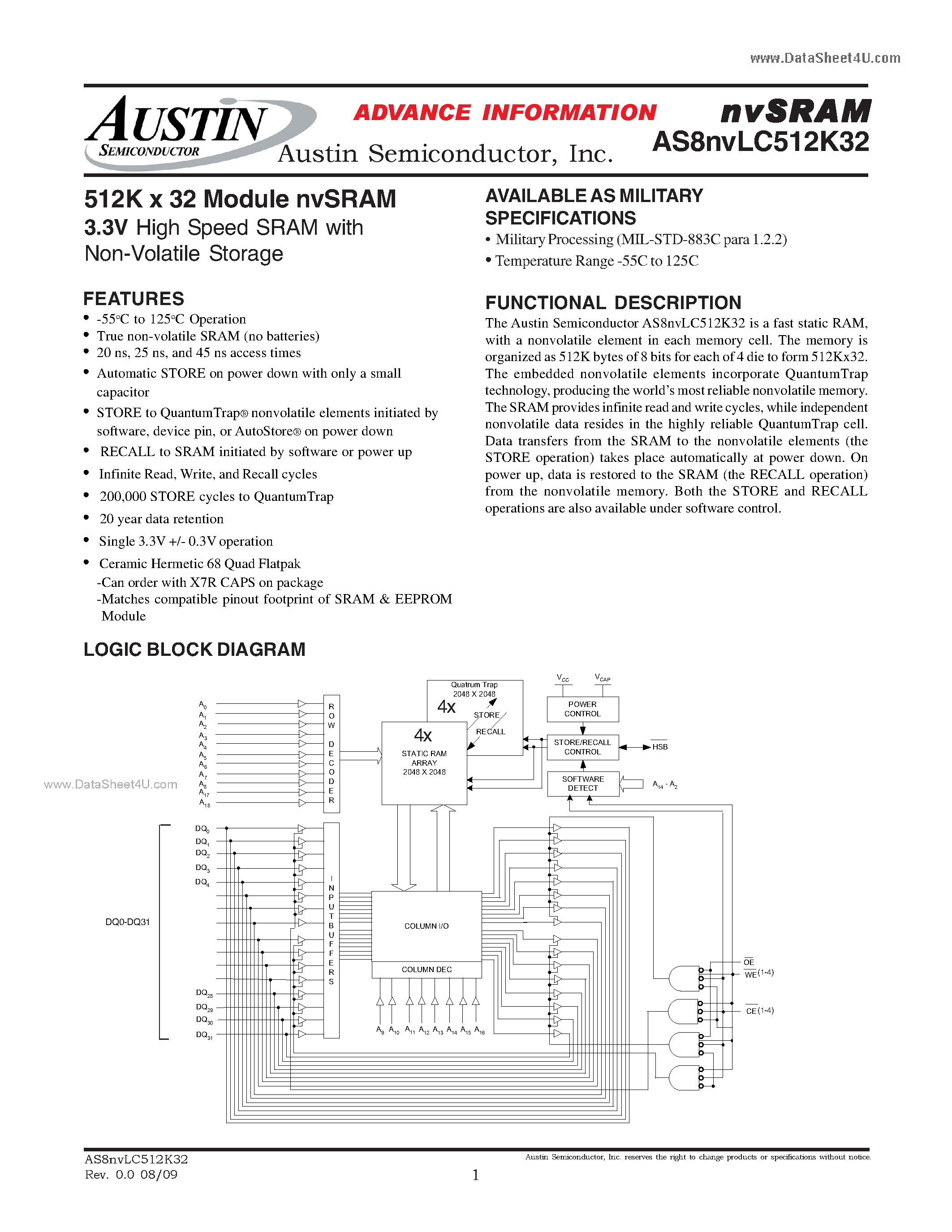

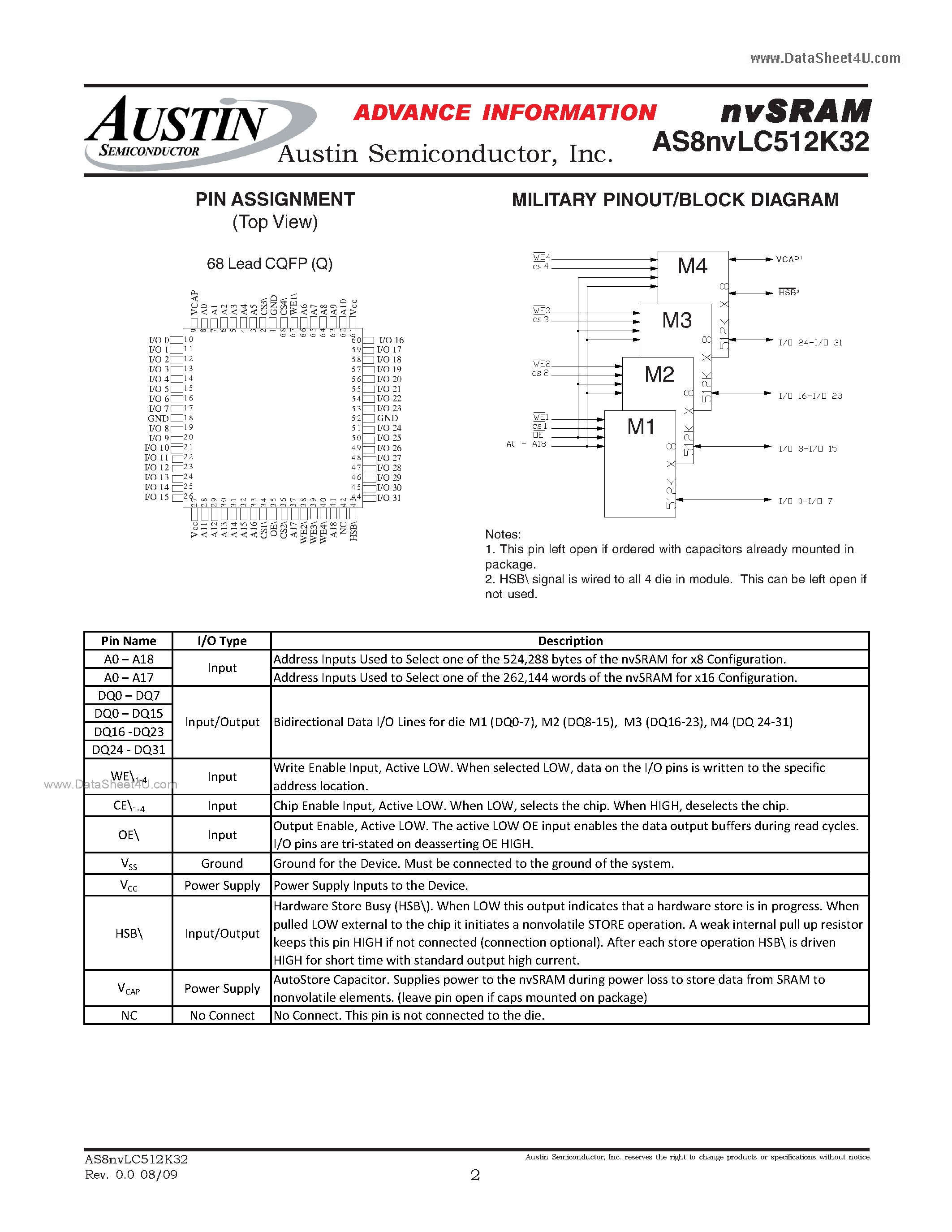

AS8NVLC512K32-512K x 32 Module nvSRAM 3.3V High Speed SRAM with Non-Volatile Storage
Producer:Austin Semiconductor
Description:512K x 32 Module nvSRAM 3.3V High Speed SRAM with Non-Volatile Storage
