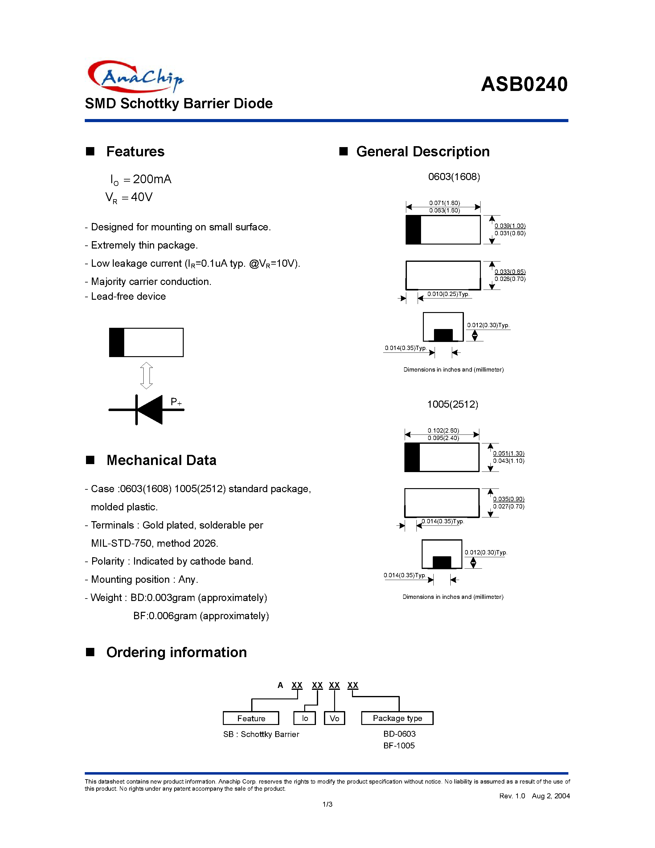

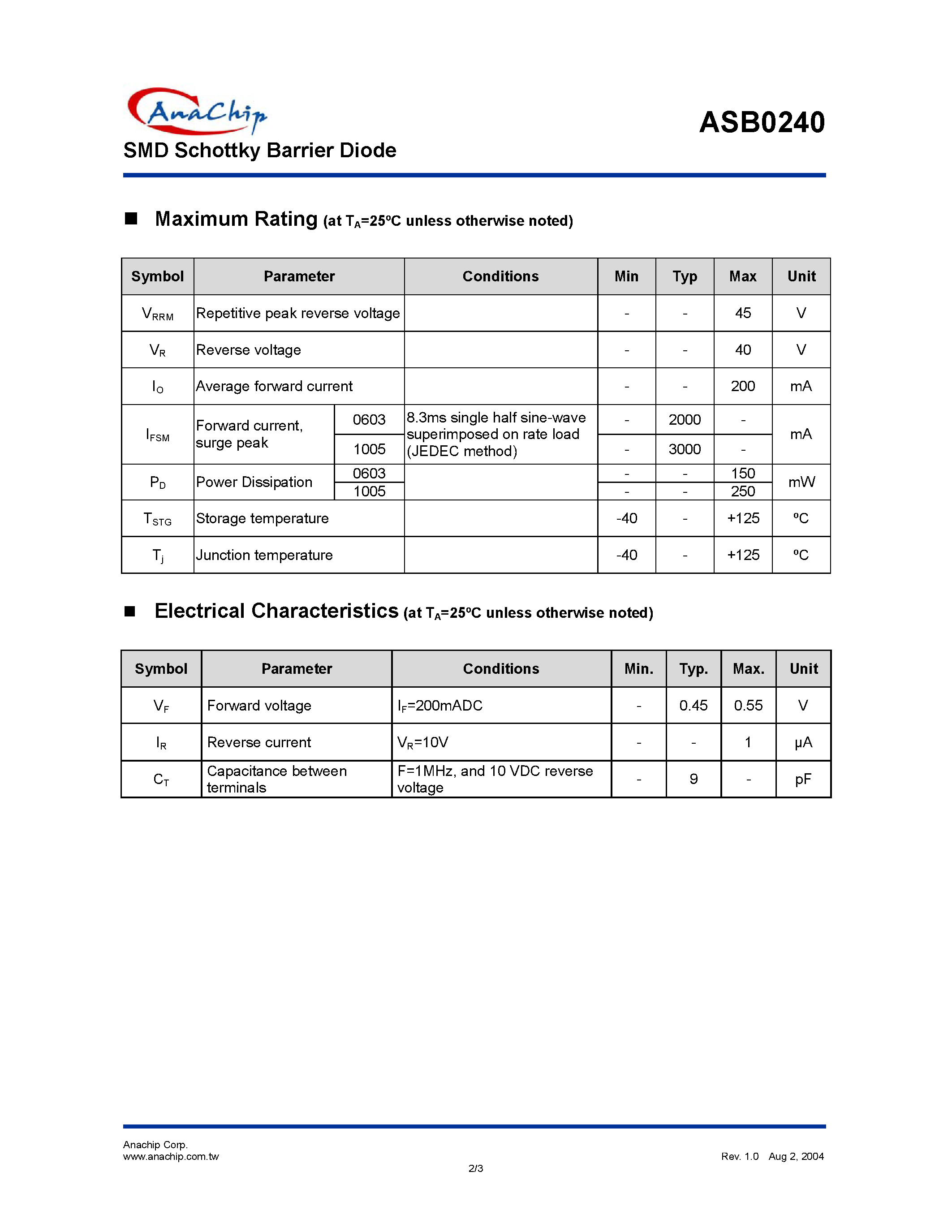

ASBI0V0BD-0603-SMD Schottky Barrier Diode
Producer:ETC
Description:SMD Schottky Barrier Diode
Others with the same file: ASBI0V0BD-0603
Datasheet ASBI0V0BD-0603 - SMD Schottky Barrier Diode page 1
Datasheet ASBI0V0BD-0603 - SMD Schottky Barrier Diode page 2
