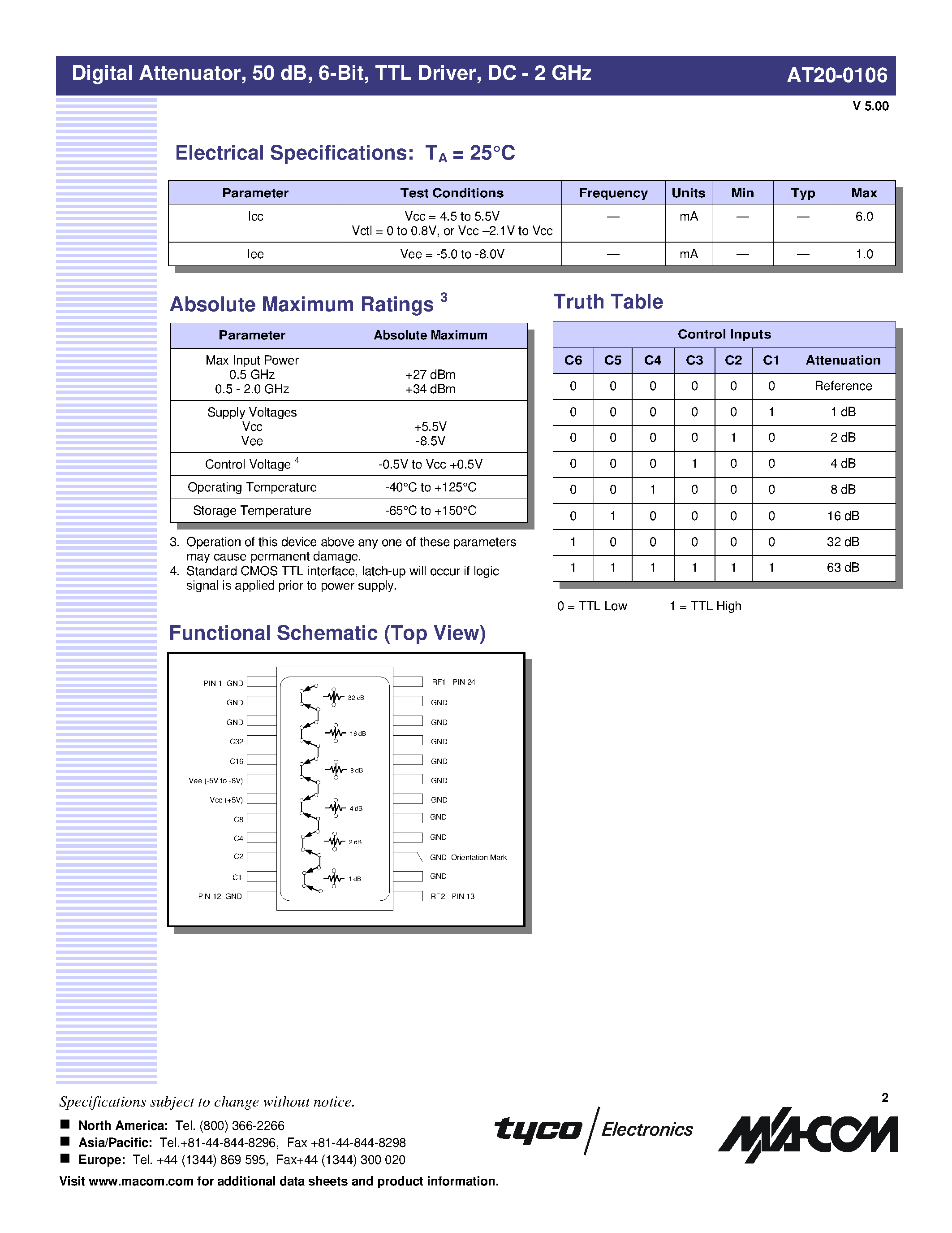

AT20-0106-Digital Attenuator/ 50 dB/ 6-Bit/ TTL Driver/ DC - 2 GHz
Producer:Tyco Electronics
Description:Digital Attenuator/ 50 dB/ 6-Bit/ TTL Driver/ DC - 2 GHz
