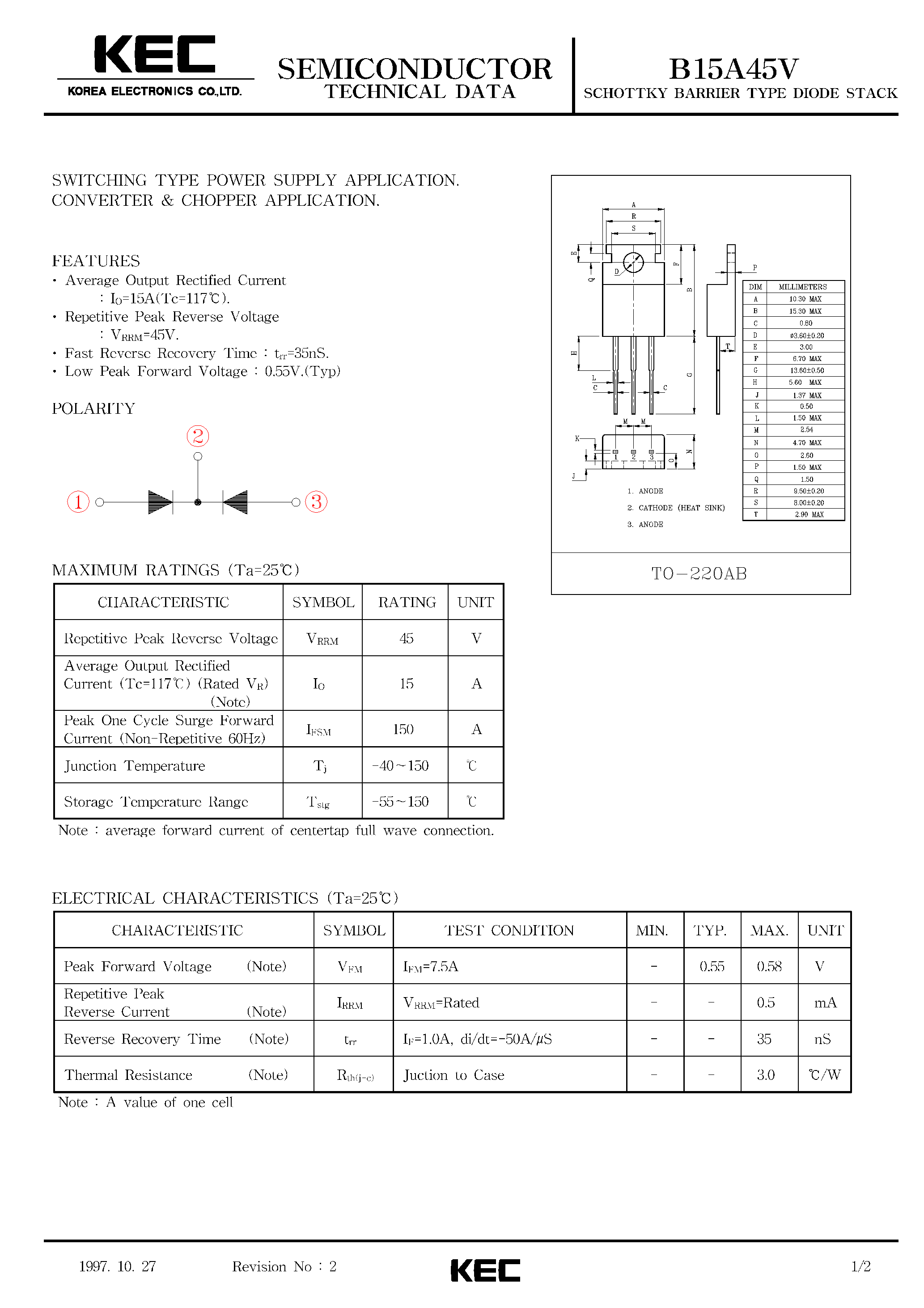

B15A45V-SCHOTTKY BARRIER TYPE DIODE STACK (SWITCHING TYPE POWER SUPPLY/ CONVERTER & CHOPPER)
Producer:KEC(Korea Electronics)
Description:SCHOTTKY BARRIER TYPE DIODE STACK (SWITCHING TYPE POWER SUPPLY/ CONVERTER & CHOPPER)
Others with the same file: B15A45V
