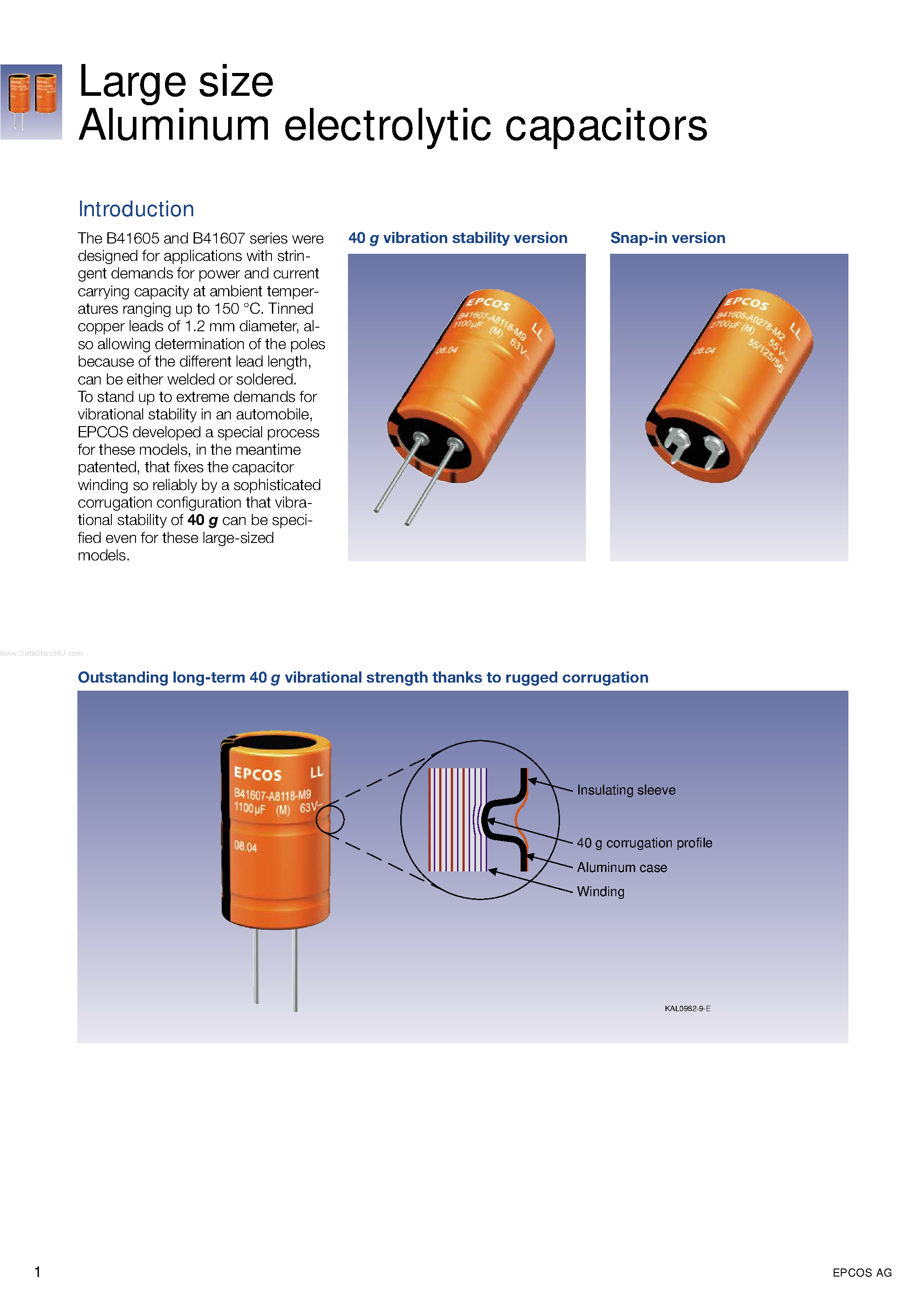

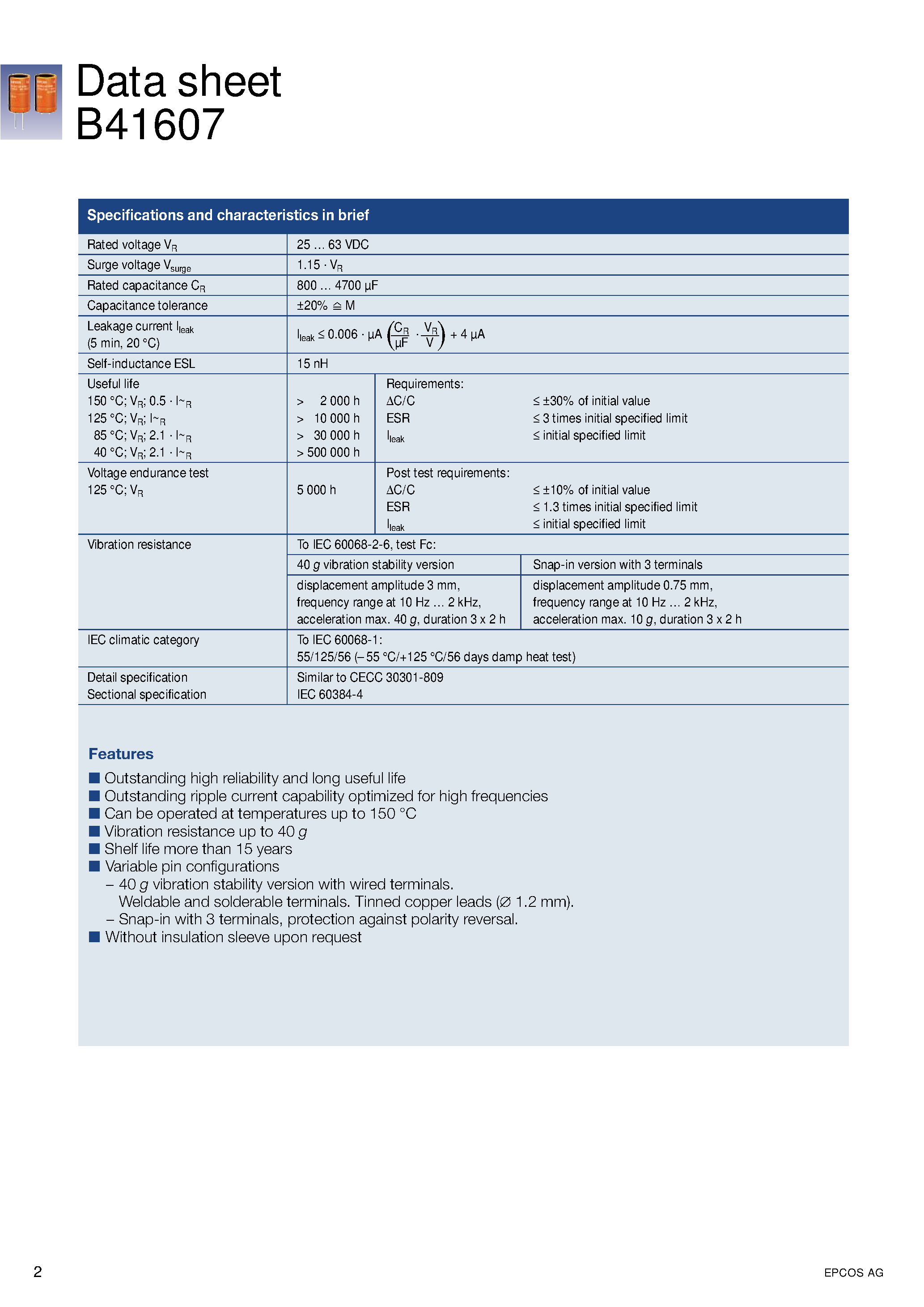

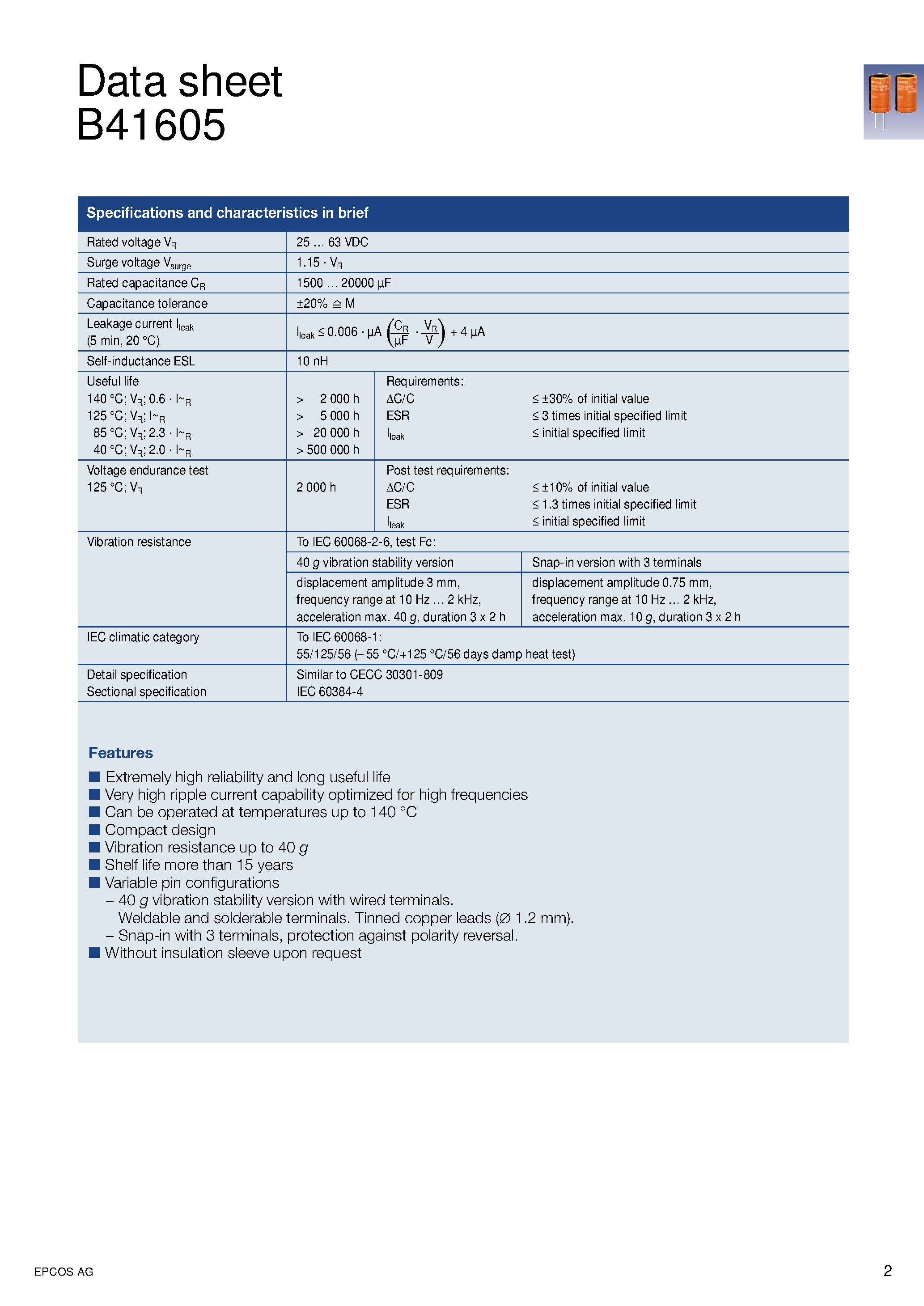

B41605-Large size Aluminum electrolytic capacitors
Producer:EPCOS
Description:Large size Aluminum electrolytic capacitors
Others with the same file: B41605
Datasheet B41605 - Large size Aluminum electrolytic capacitors page 1
Datasheet B41605 - Large size Aluminum electrolytic capacitors page 2
