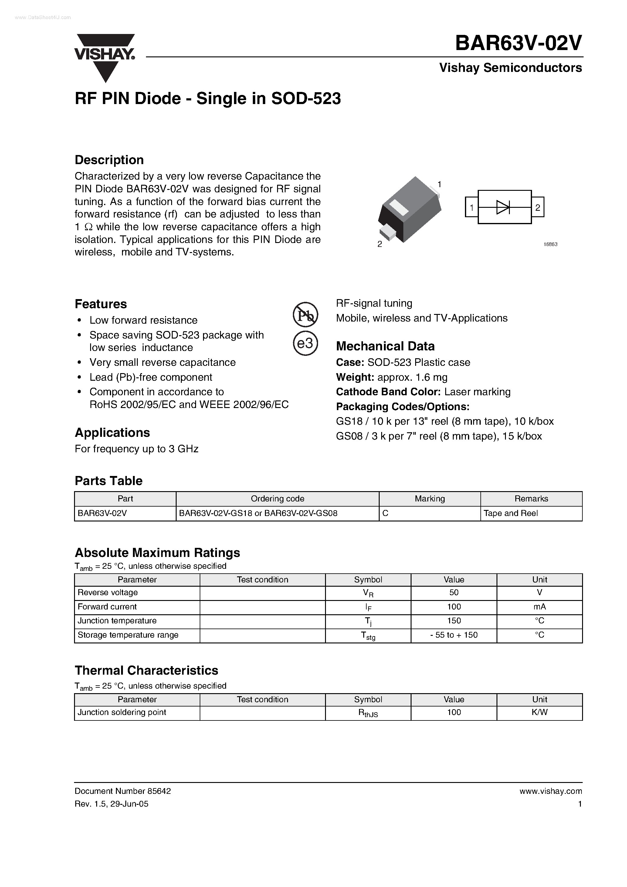

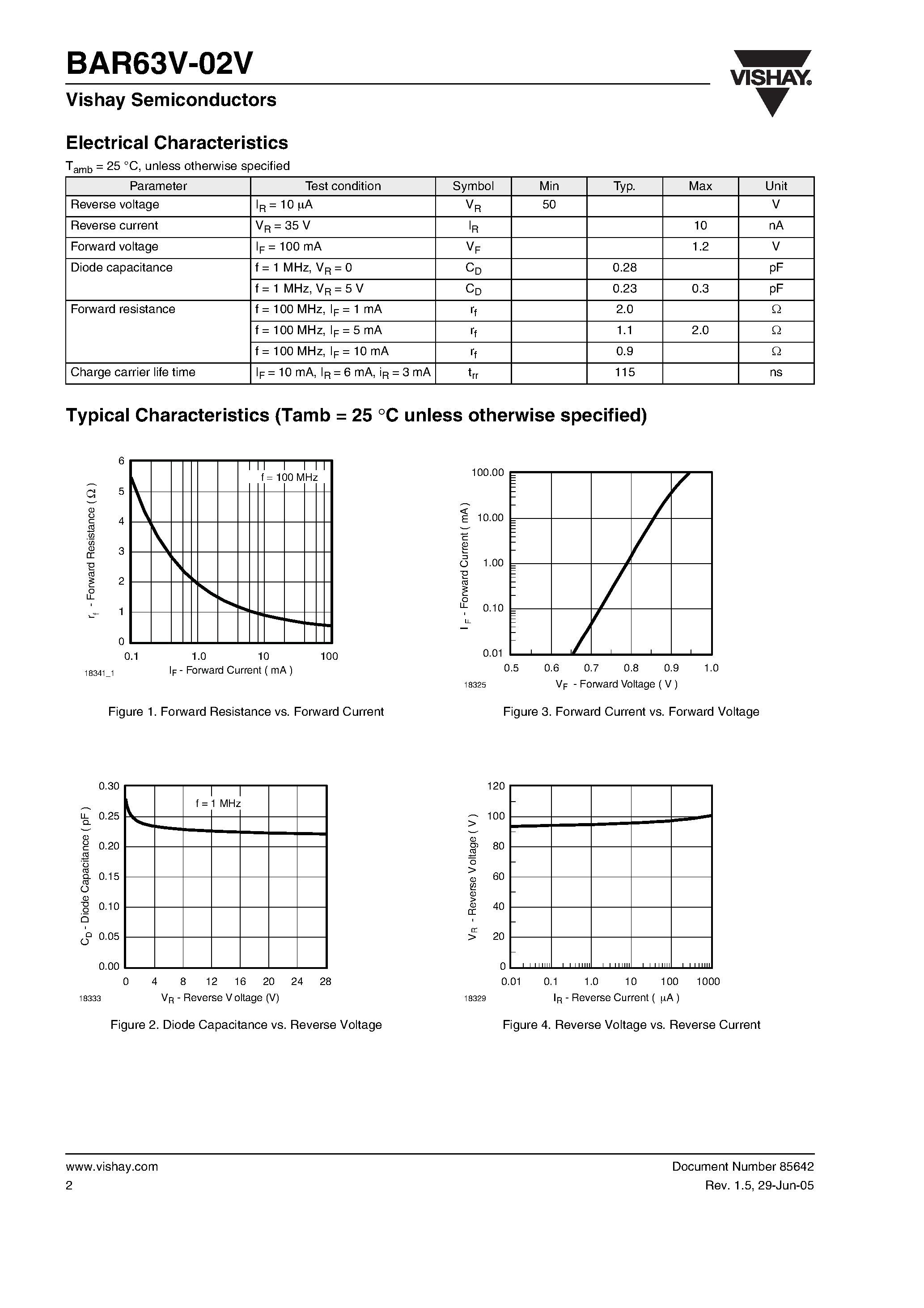

BAR63V-02V-RF PIN Diode
Producer:Vishay Siliconix
Description:RF PIN Diode
Others with the same file: BAR63V-02V
Datasheet BAR63V-02V - RF PIN Diode page 1
Datasheet BAR63V-02V - RF PIN Diode page 2
