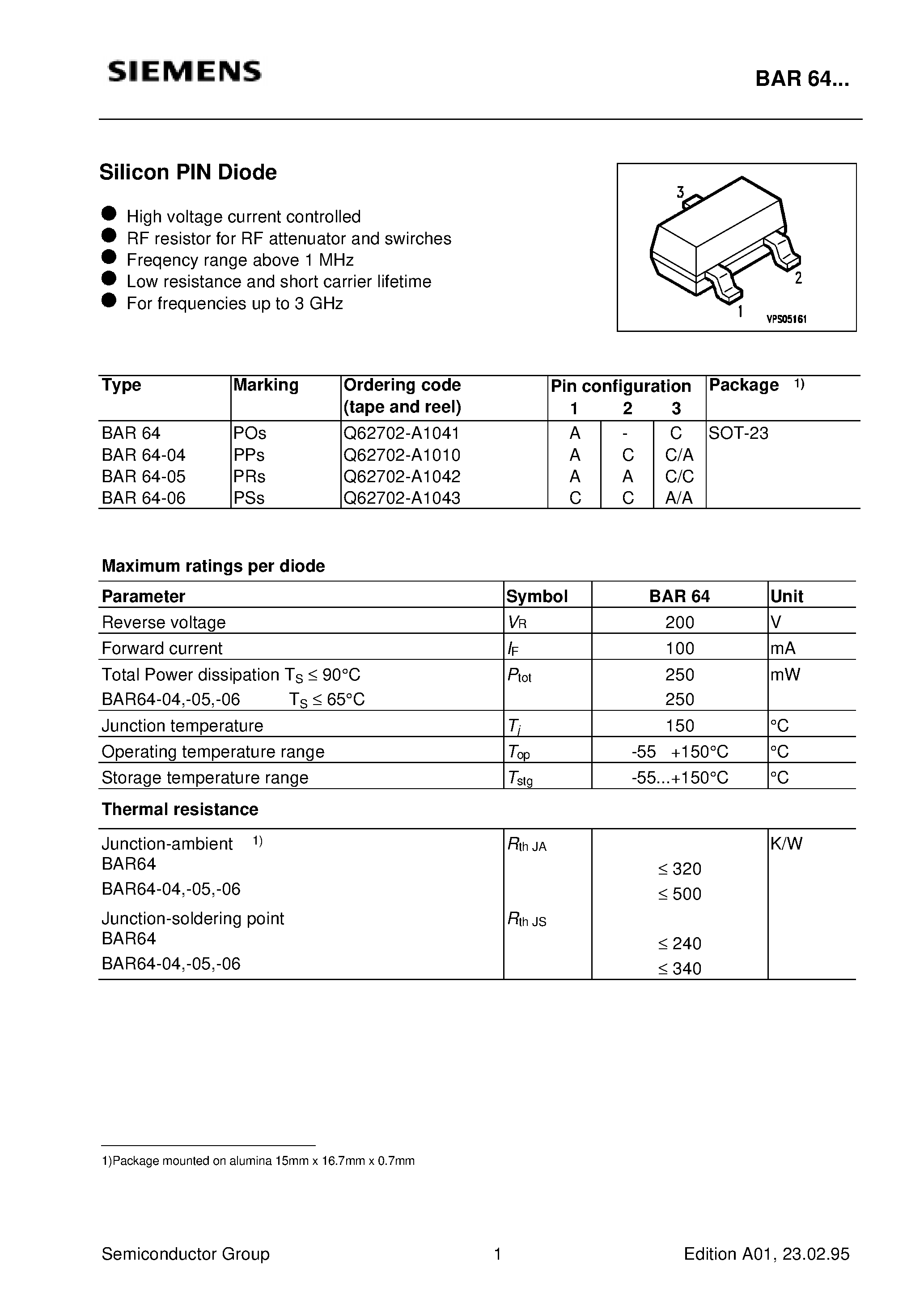

Description:Silicon PIN Diode (High voltage current controlled RF resistor for RF attenuator and swirches Freqency range above 1 MHz)

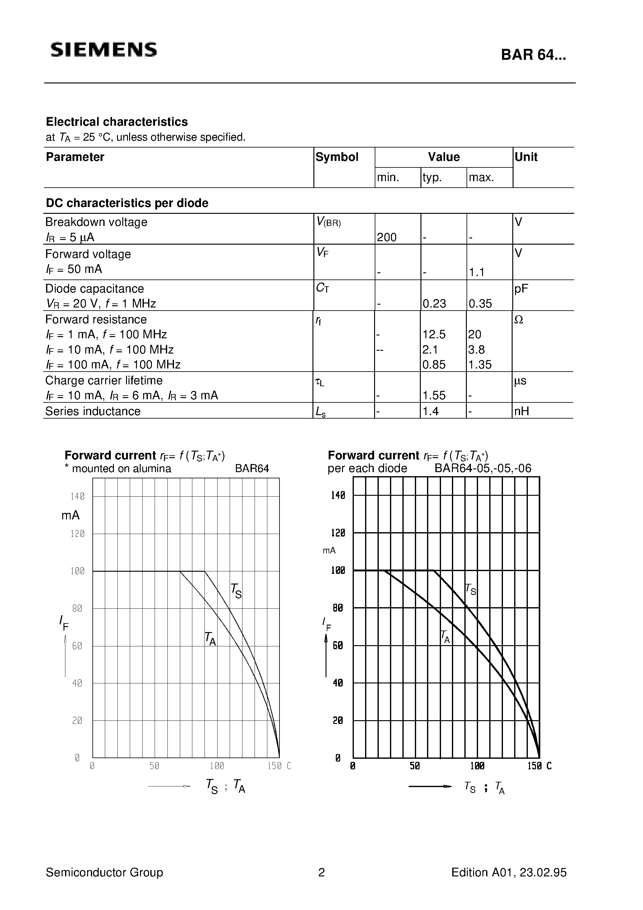

Datasheet BAR64-04 - Silicon PIN Diode (High voltage current controlled RF resistor for RF attenuator and swirches Freqency range above 1 MHz) page 1

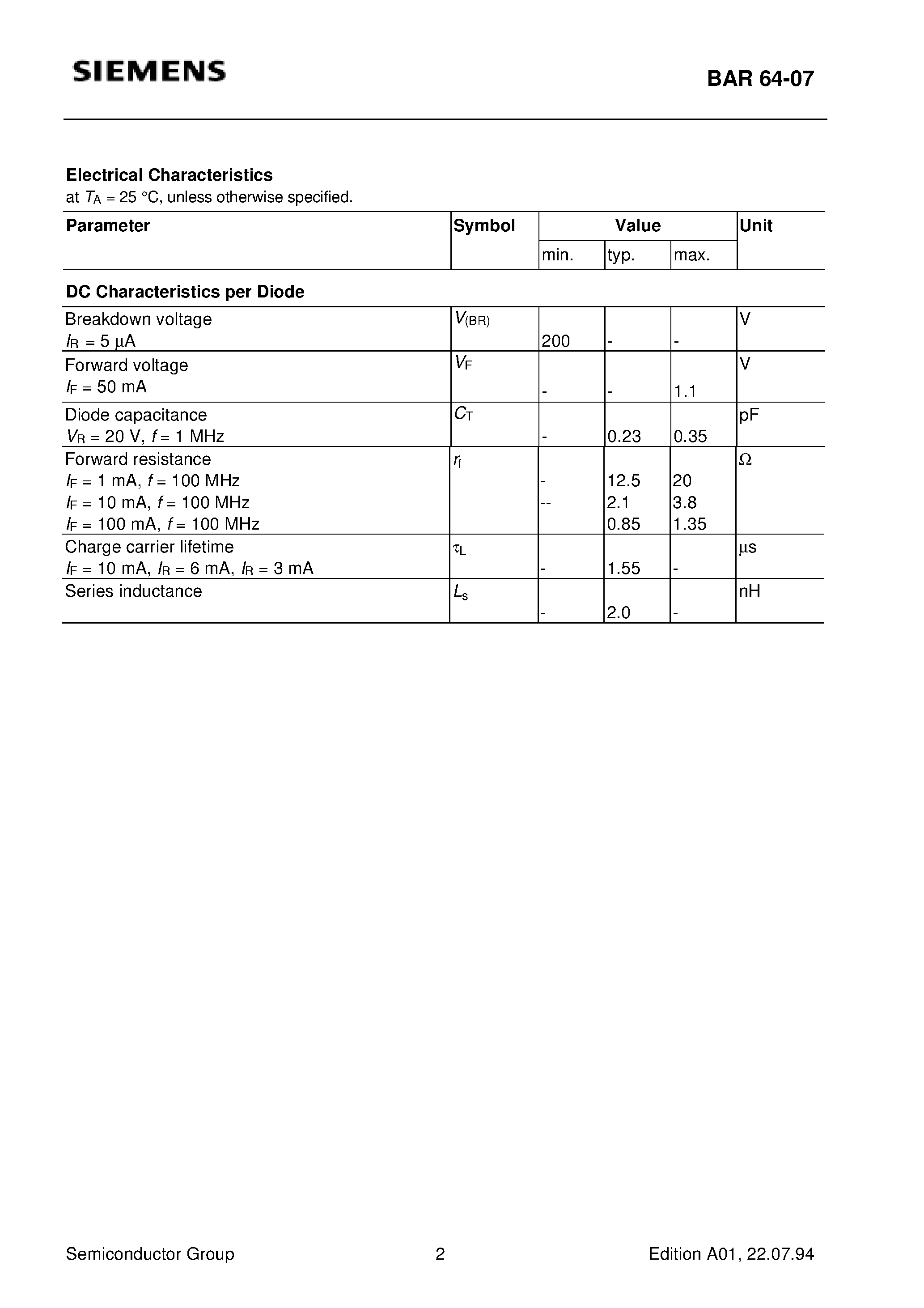

Datasheet BAR64-04 - Silicon PIN Diode (High voltage current controlled RF resistor for RF attenuator and swirches Freqency range above 1 MHz) page 2
