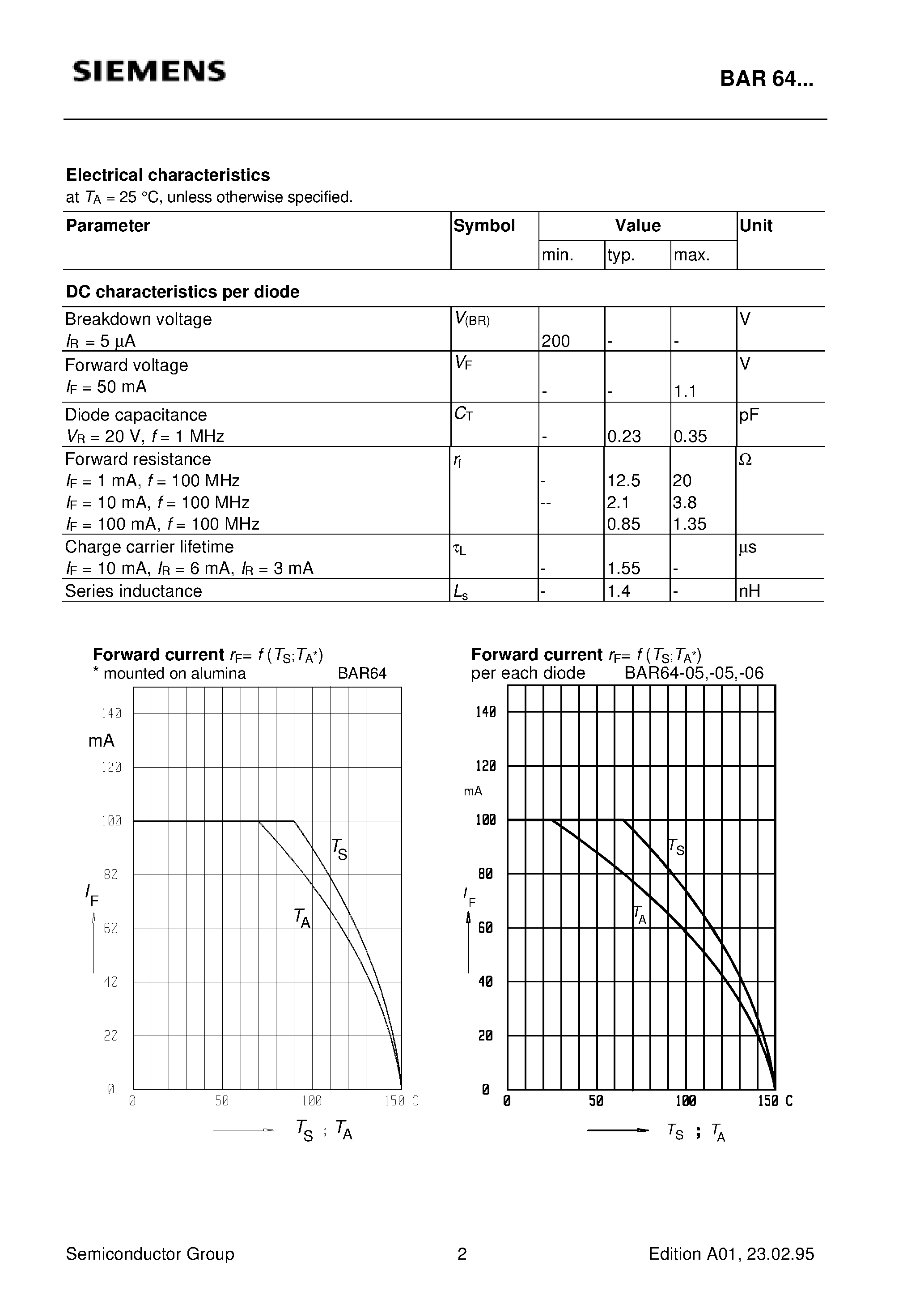

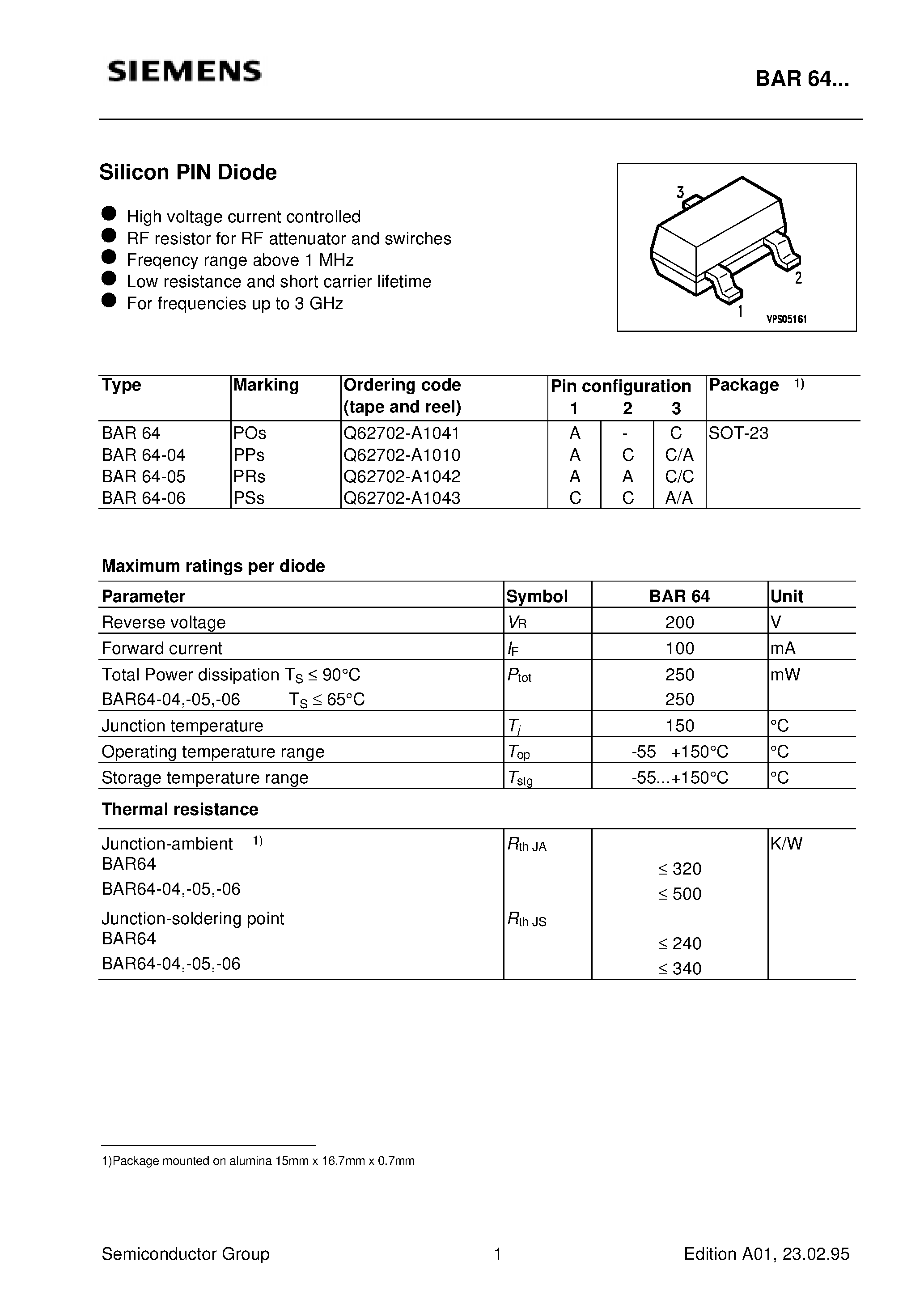

BAR64-Silicon PIN Diode (High voltage current controlled RF resistor for RF attenuator and swirches Freqency range above 1 MHz)
Description:Silicon PIN Diode (High voltage current controlled RF resistor for RF attenuator and swirches Freqency range above 1 MHz)
Others with the same file: BAR64
Datasheet BAR64 - Silicon PIN Diode (High voltage current controlled RF resistor for RF attenuator and swirches Freqency range above 1 MHz) page 1
Datasheet BAR64 - Silicon PIN Diode (High voltage current controlled RF resistor for RF attenuator and swirches Freqency range above 1 MHz) page 2
