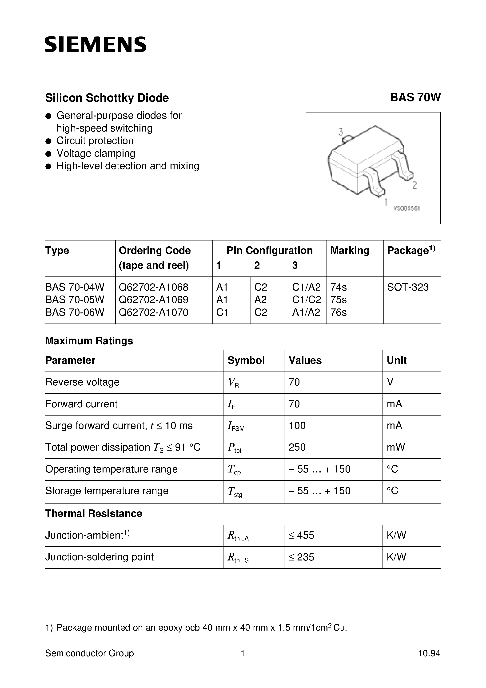

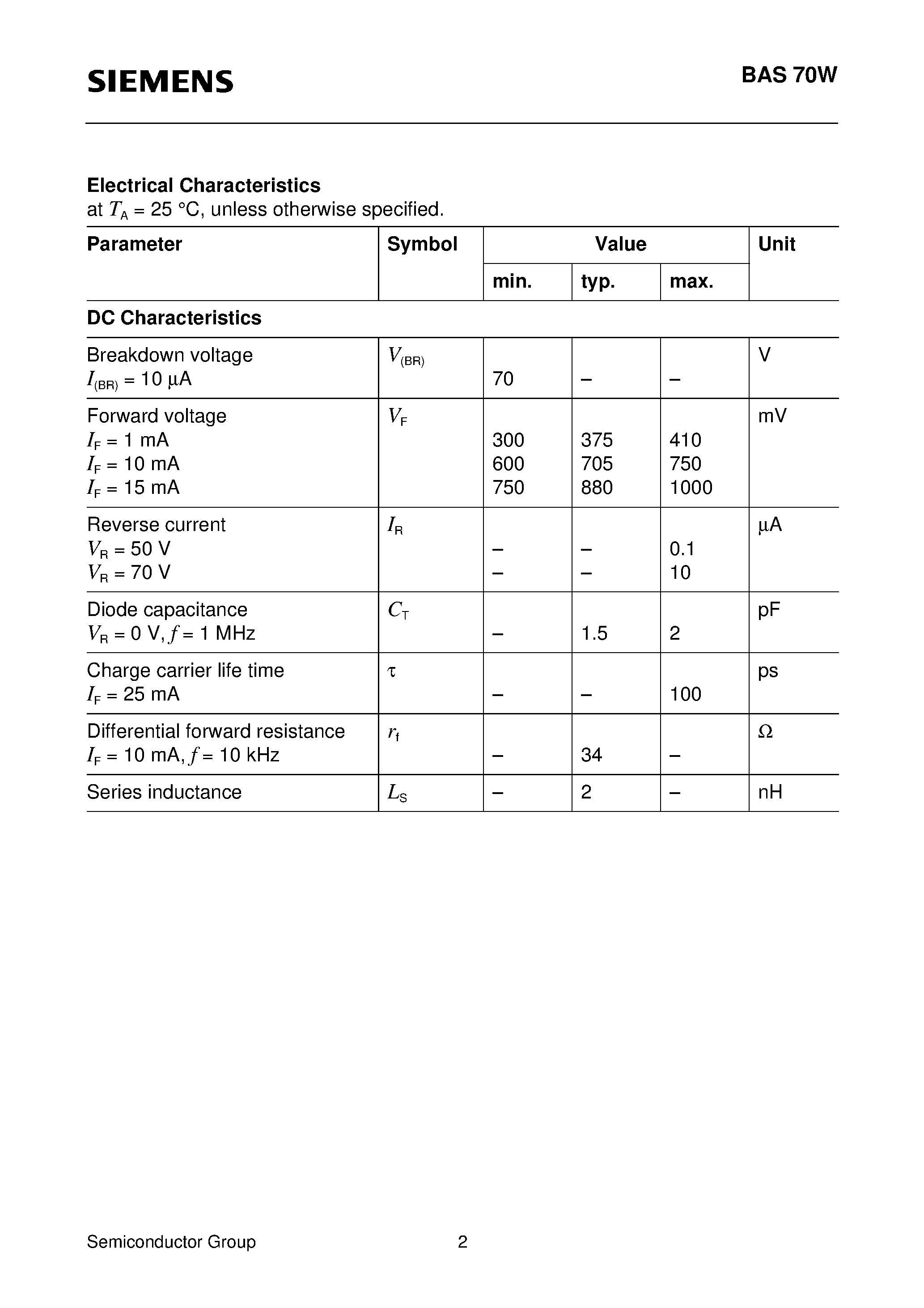

BAS70-04W-Silicon Schottky Diode (General-purpose diodes for high-speed switching Circuit protection Voltage clamping)
Description:Silicon Schottky Diode (General-purpose diodes for high-speed switching Circuit protection Voltage clamping)
Others with the same file: BAS70-04W
Datasheet BAS70-04W - Silicon Schottky Diode (General-purpose diodes for high-speed switching Circuit protection Voltage clamping) page 1
Datasheet BAS70-04W - Silicon Schottky Diode (General-purpose diodes for high-speed switching Circuit protection Voltage clamping) page 2
