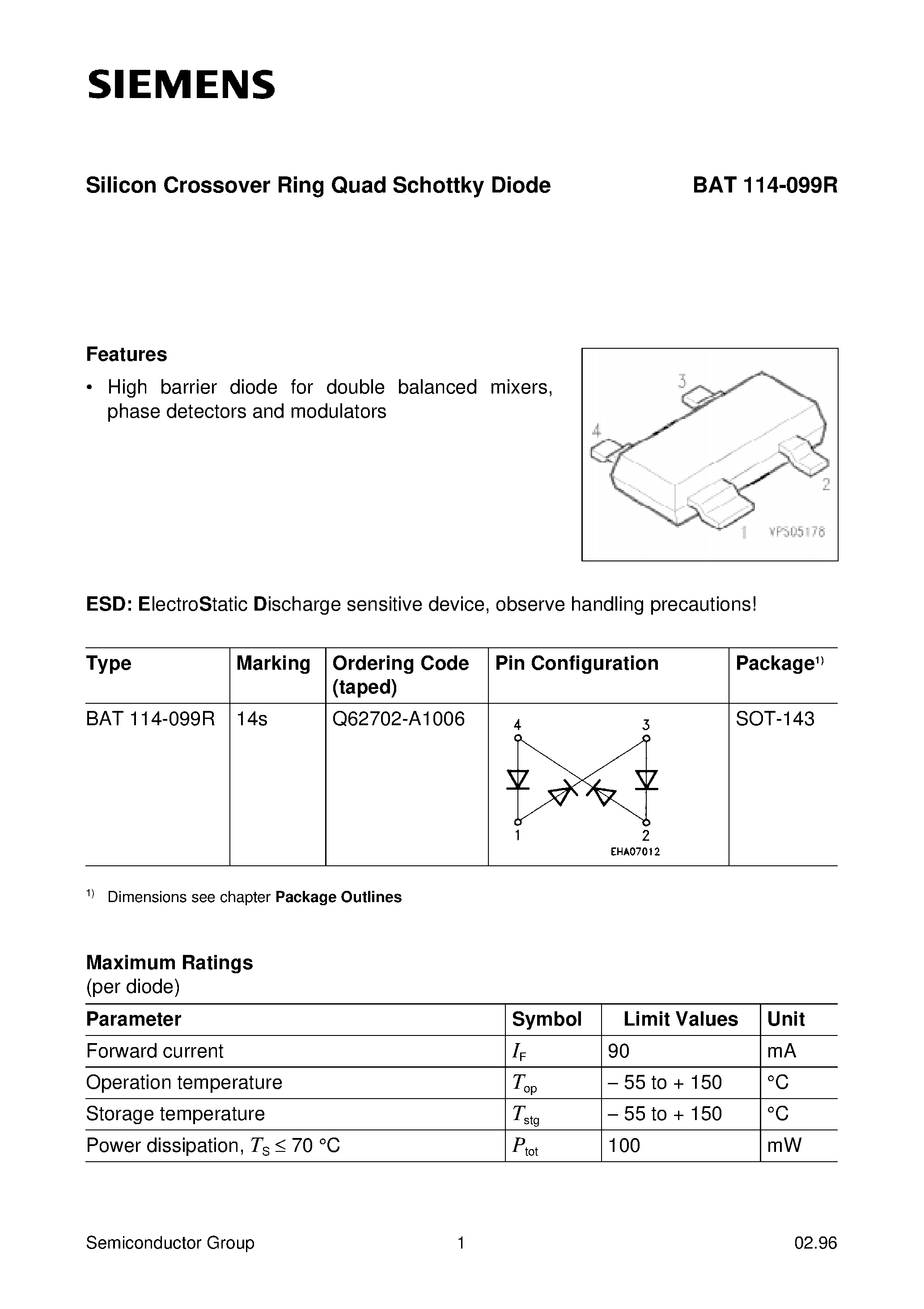

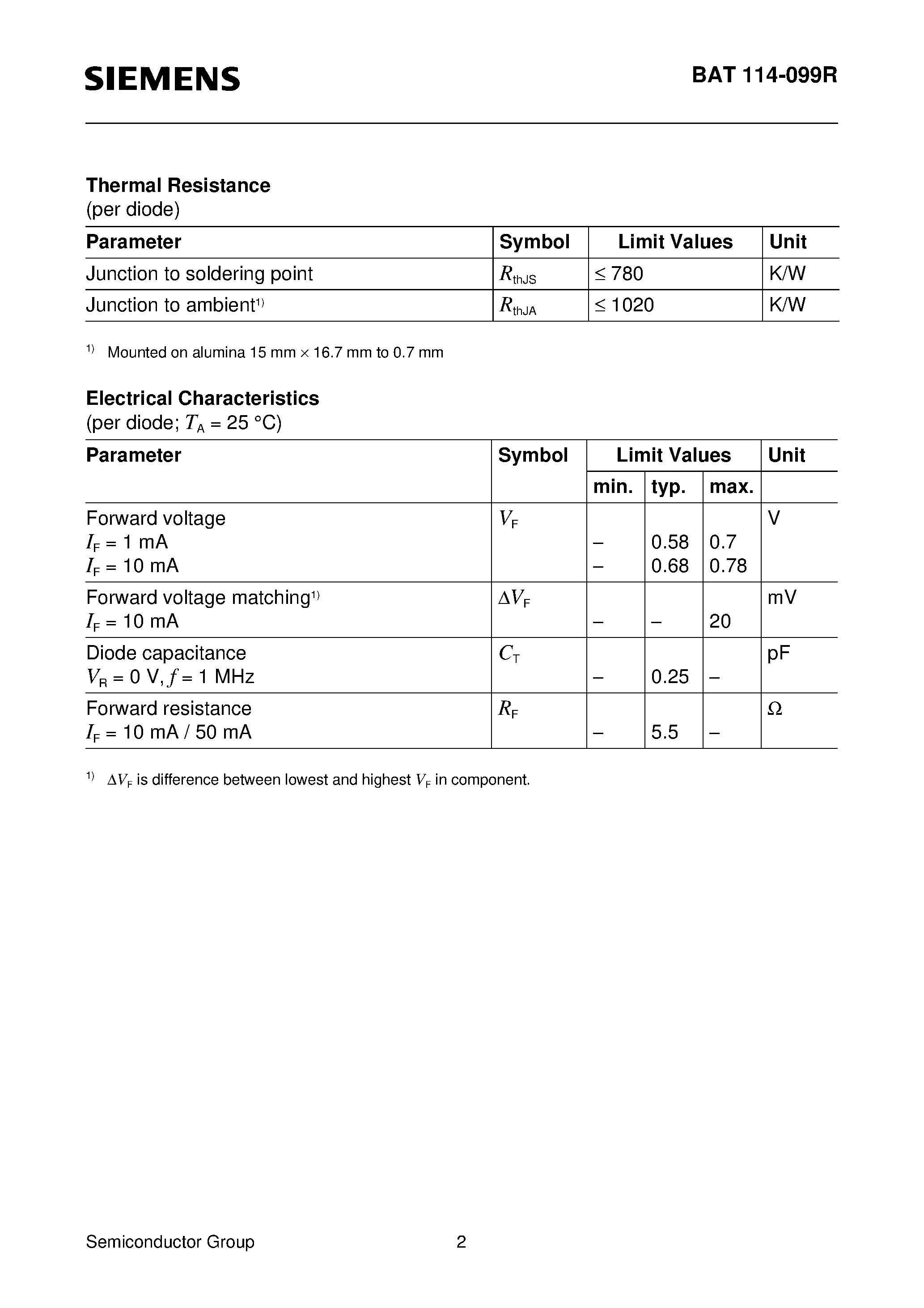

BAT114-099R-Silicon Crossover Ring Quad Schottky Diode (High barrier diode for double balanced mixers/ phase detectors and modulators)
Description:Silicon Crossover Ring Quad Schottky Diode (High barrier diode for double balanced mixers/ phase detectors and modulators)
Others with the same file: BAT114-099R
Datasheet BAT114-099R - Silicon Crossover Ring Quad Schottky Diode (High barrier diode for double balanced mixers/ phase detectors and modulators) page 1
Datasheet BAT114-099R - Silicon Crossover Ring Quad Schottky Diode (High barrier diode for double balanced mixers/ phase detectors and modulators) page 2
