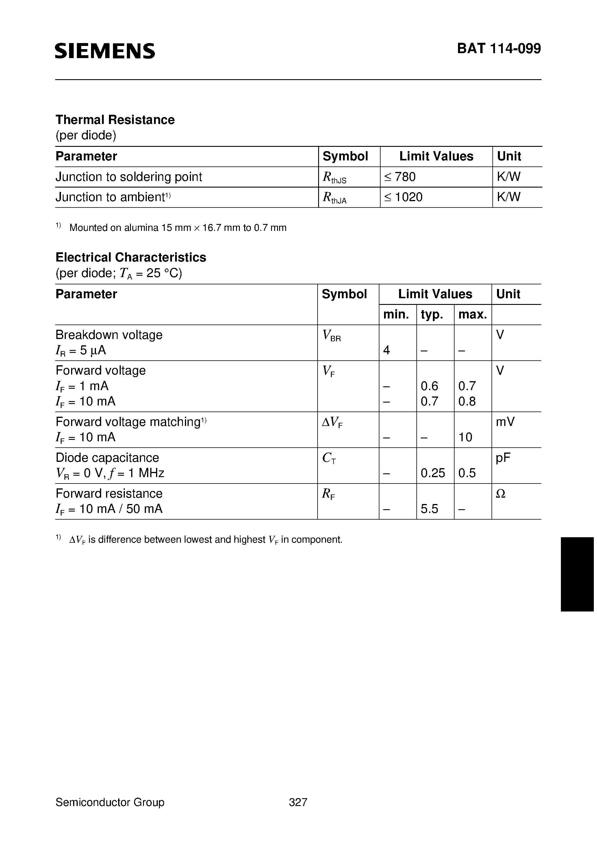

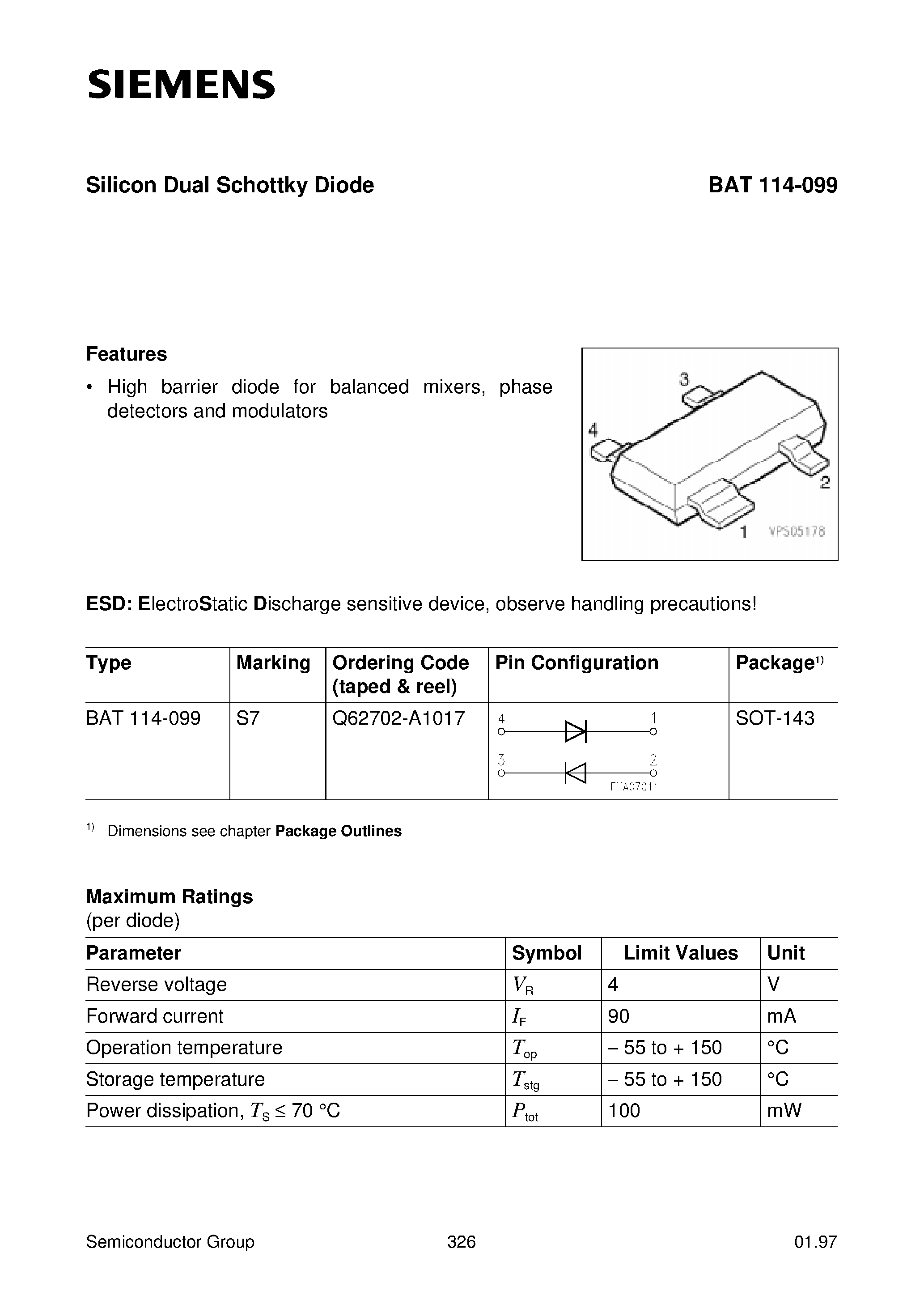

BAT114-099-Silicon Dual Schottky Diode (High barrier diode for balanced mixers/ phase detectors and modulators)
Description:Silicon Dual Schottky Diode (High barrier diode for balanced mixers/ phase detectors and modulators)

Datasheet BAT114-099 - Silicon Dual Schottky Diode (High barrier diode for balanced mixers/ phase detectors and modulators) page 1
Datasheet BAT114-099 - Silicon Dual Schottky Diode (High barrier diode for balanced mixers/ phase detectors and modulators) page 2
