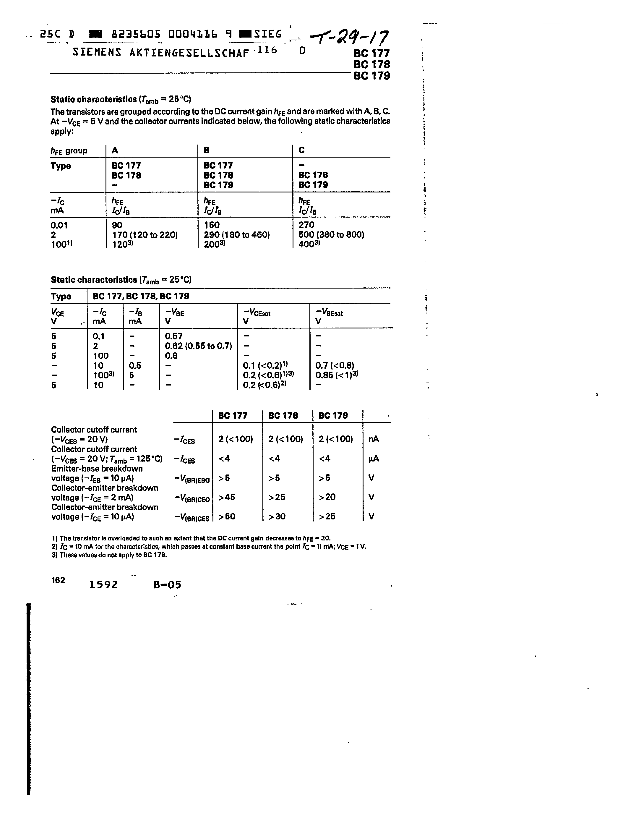

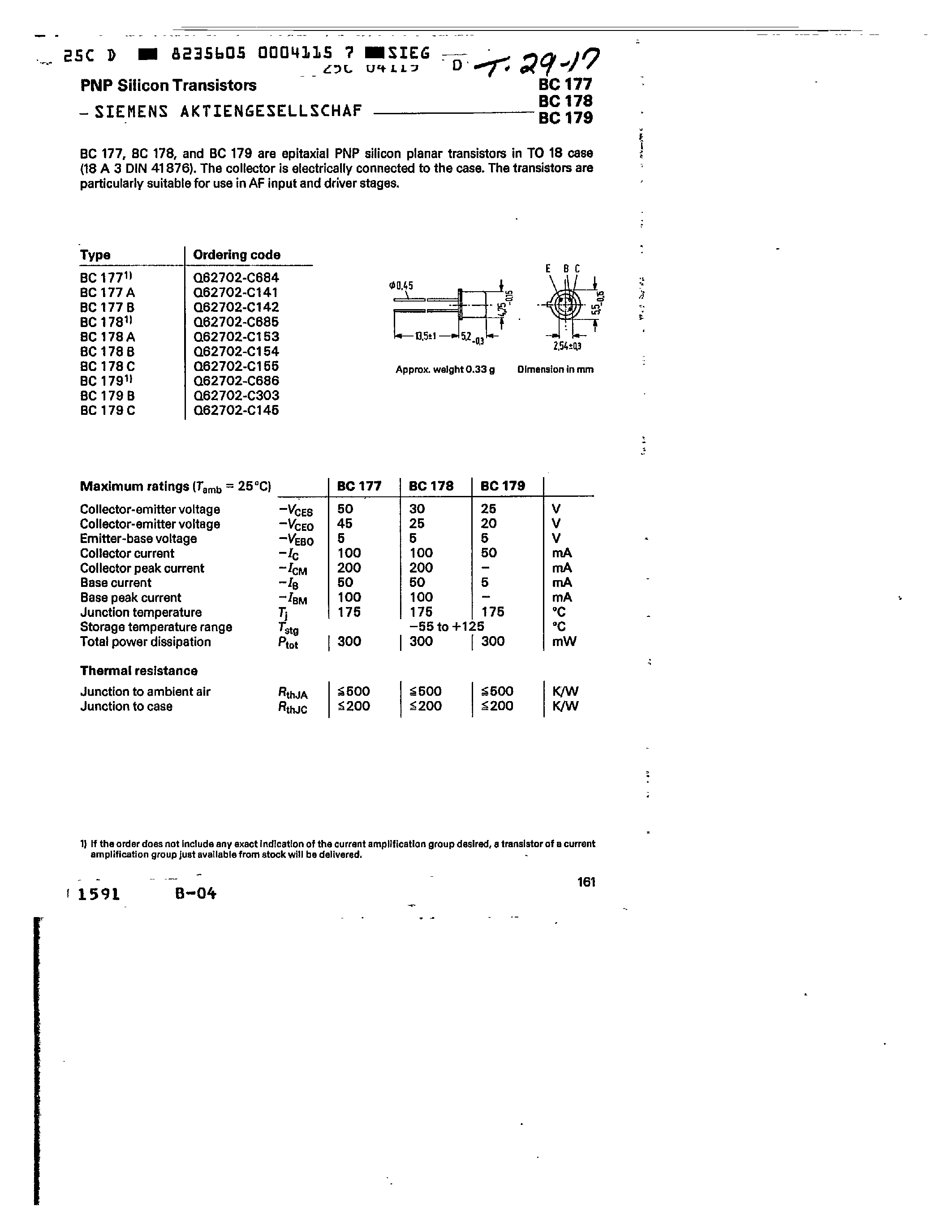

BC177A-PNP SILICON TRANSISTORS
Producer:Siemens Group
Description:PNP SILICON TRANSISTORS
Others with the same file: BC177A
Datasheet BC177A - PNP SILICON TRANSISTORS page 1
Datasheet BC177A - PNP SILICON TRANSISTORS page 2
