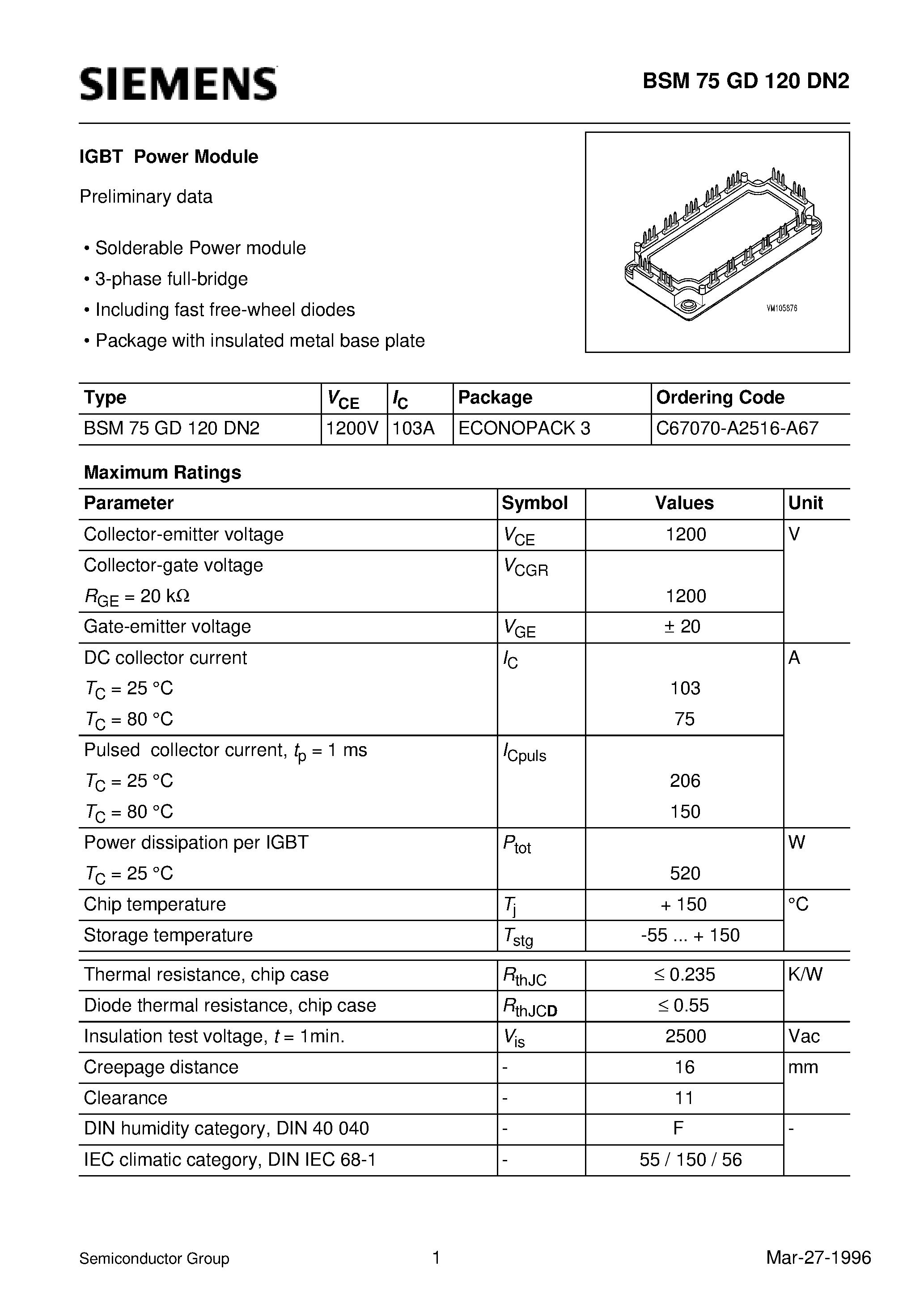

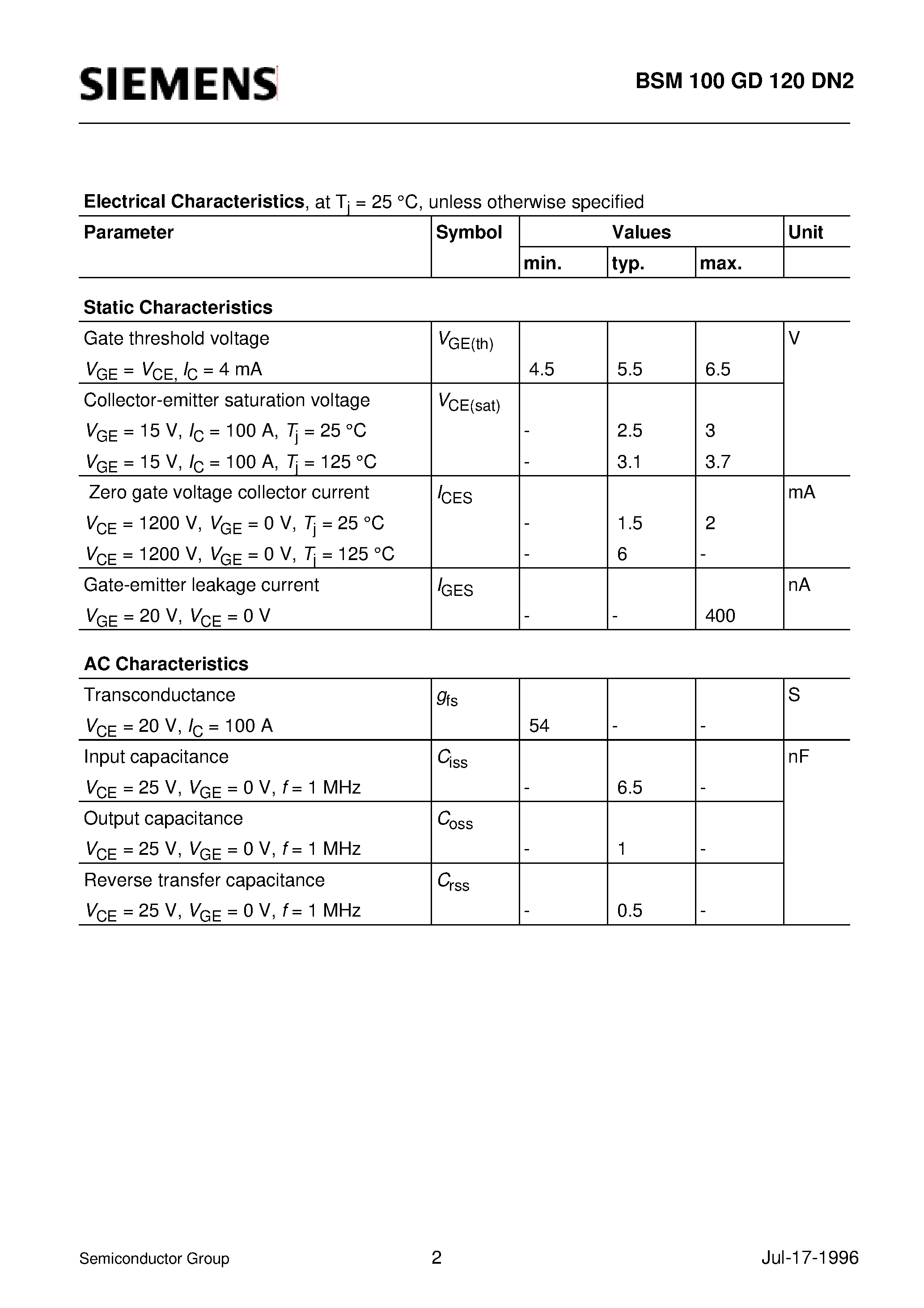

BSM100GD120DN2-IGBT Power Module (Solderable Power module 3-phase full-bridge Including fast free-wheel diodes)
Description:IGBT Power Module (Solderable Power module 3-phase full-bridge Including fast free-wheel diodes)
Others with the same file: BSM100GD120DN2
Datasheet BSM100GD120DN2 - IGBT Power Module (Solderable Power module 3-phase full-bridge Including fast free-wheel diodes) page 1
Datasheet BSM100GD120DN2 - IGBT Power Module (Solderable Power module 3-phase full-bridge Including fast free-wheel diodes) page 2
