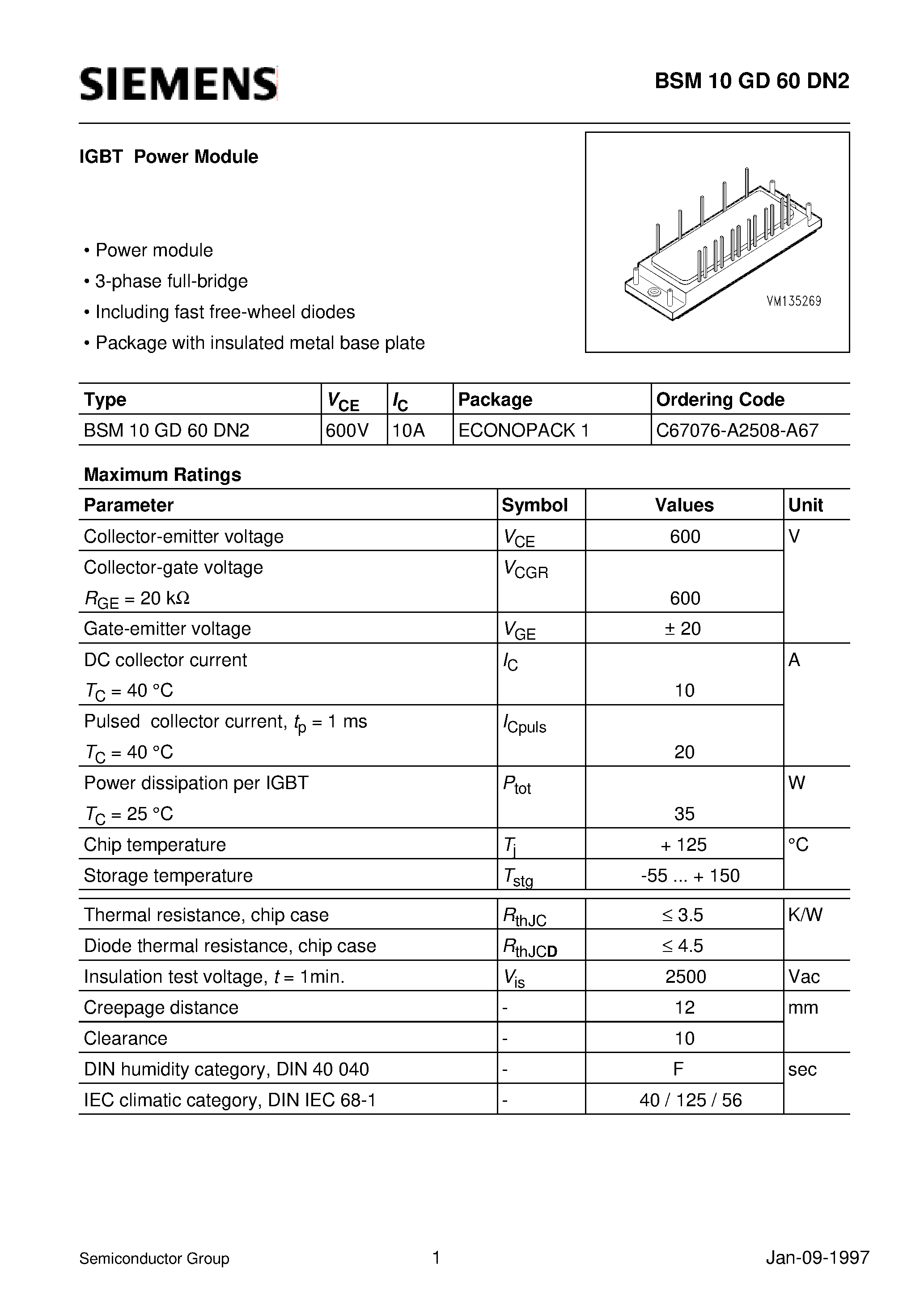

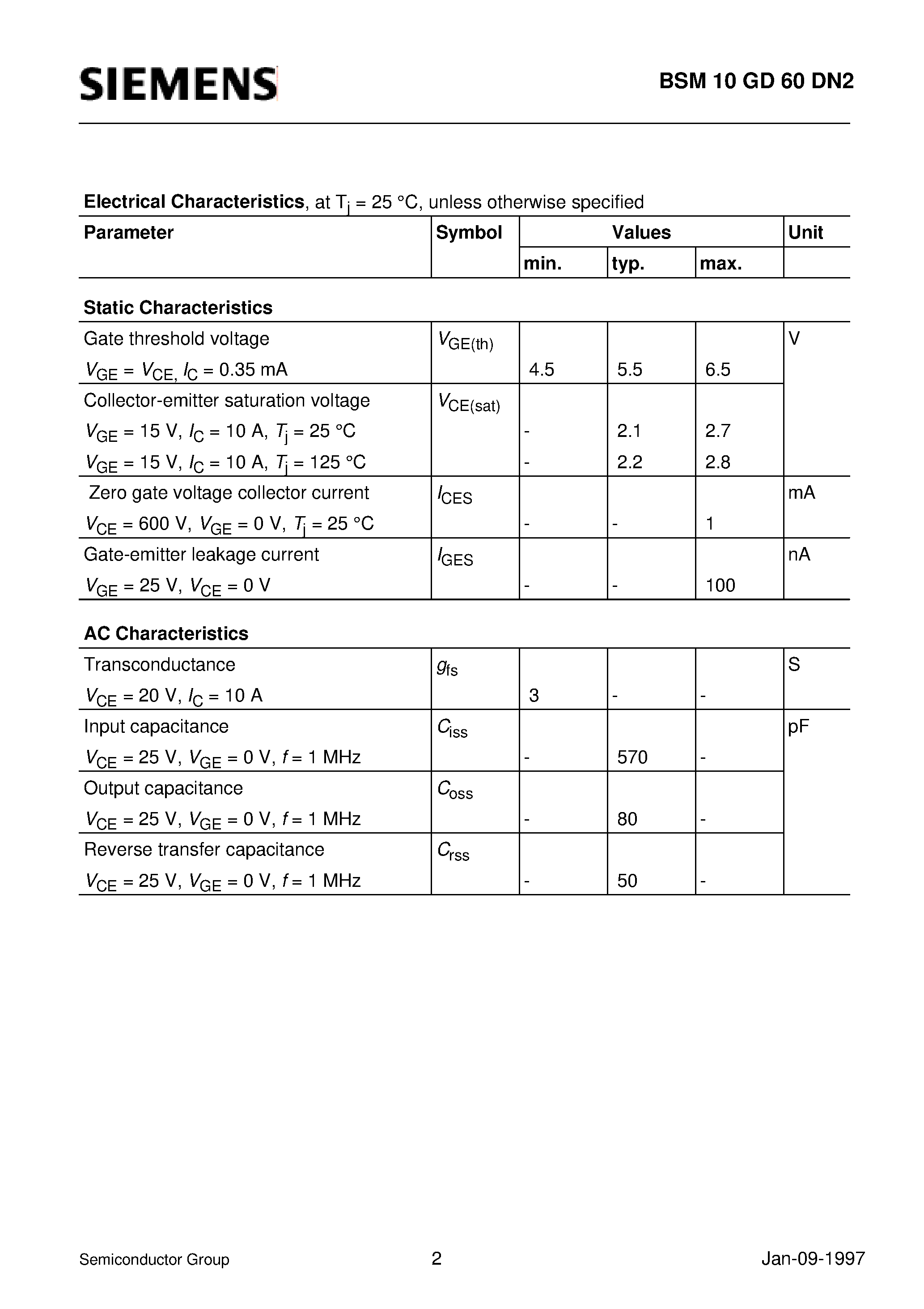

BSM10GD60DN2-IGBT Power Module (Power module 3-phase full-bridge Including fast free-wheel diodes
Description:IGBT Power Module (Power module 3-phase full-bridge Including fast free-wheel diodes
Others with the same file: BSM10GD60DN2
Datasheet BSM10GD60DN2 - IGBT Power Module (Power module 3-phase full-bridge Including fast free-wheel diodes page 1
Datasheet BSM10GD60DN2 - IGBT Power Module (Power module 3-phase full-bridge Including fast free-wheel diodes page 2
