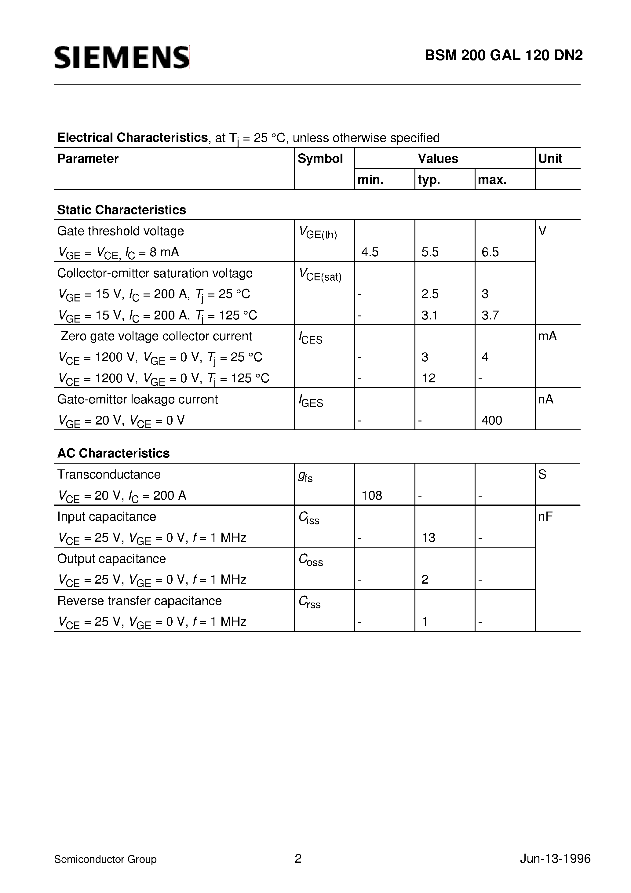

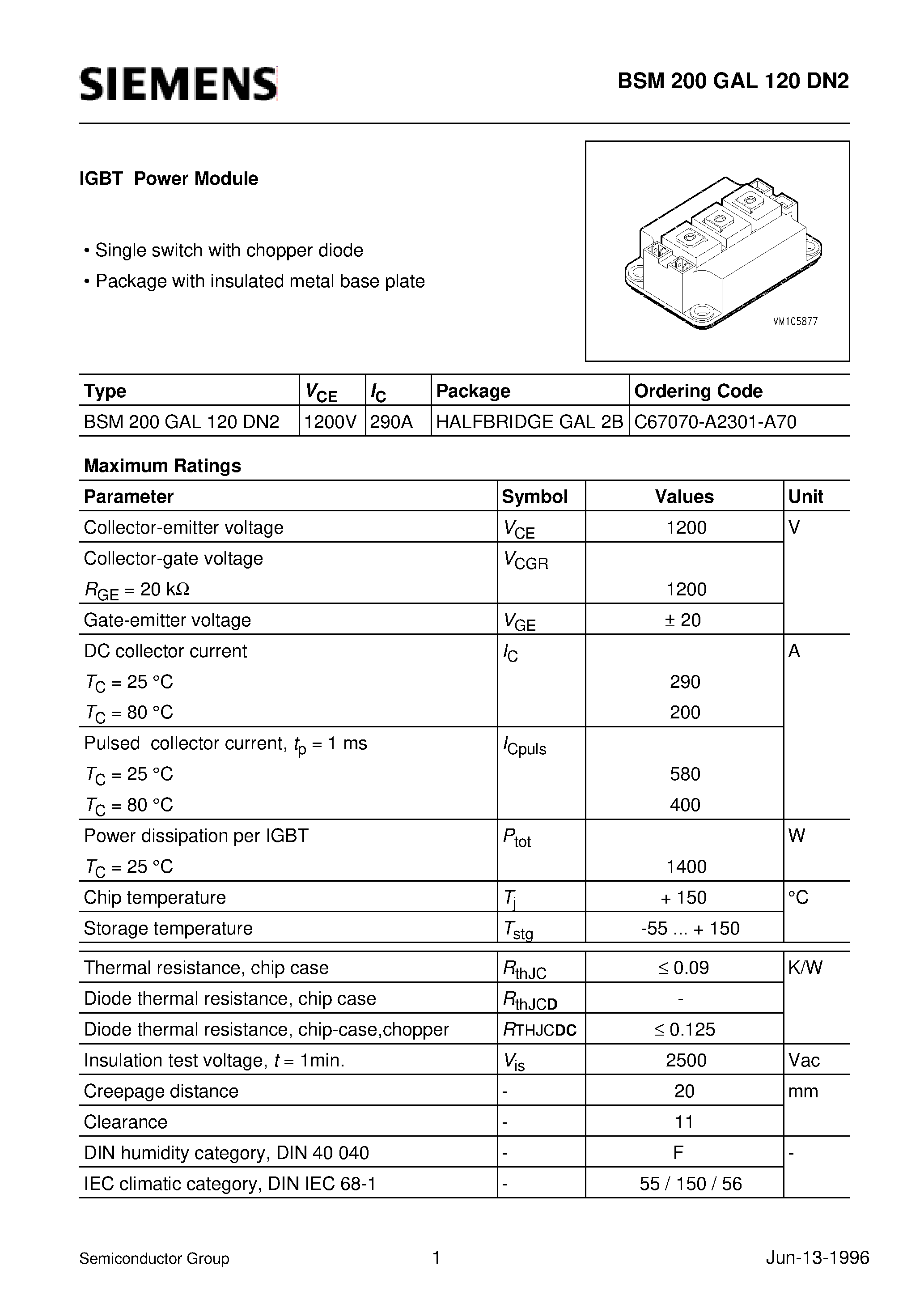

Datasheet BSM200GAL120DN2 - IGBT Power Module (Single switch with chopper diode Package with insulated metal base plate) page 1
Datasheet BSM200GAL120DN2 - IGBT Power Module (Single switch with chopper diode Package with insulated metal base plate) page 2
