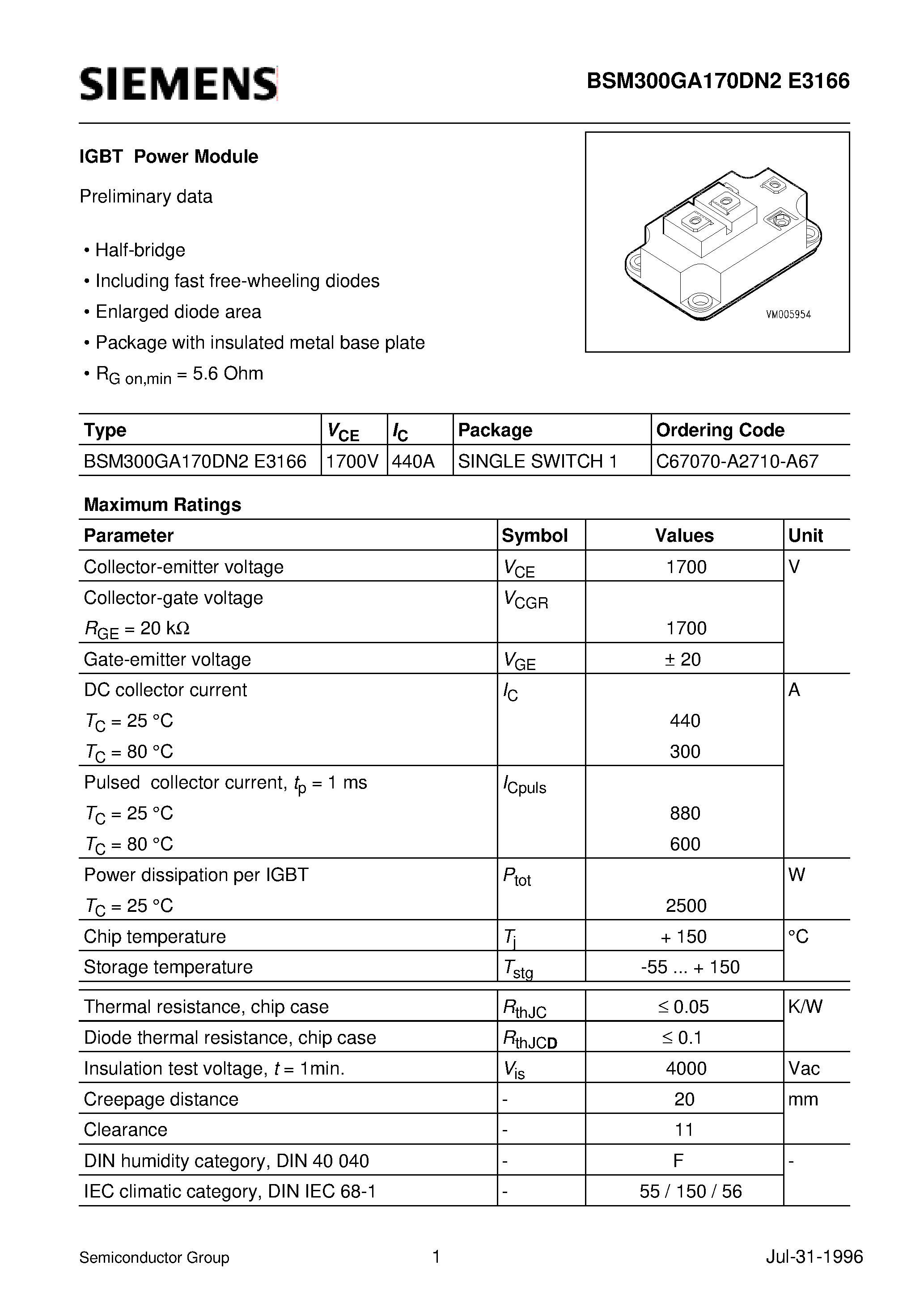

BSM300GA170DN2E3166-IGBT Power Module (Half-bridge Including fast free-wheeling diodes Enlarged diode area)
Description:IGBT Power Module (Half-bridge Including fast free-wheeling diodes Enlarged diode area)
Others with the same file: BSM300GA170DN2E3166
Datasheet BSM300GA170DN2E3166 - IGBT Power Module (Half-bridge Including fast free-wheeling diodes Enlarged diode area) page 1

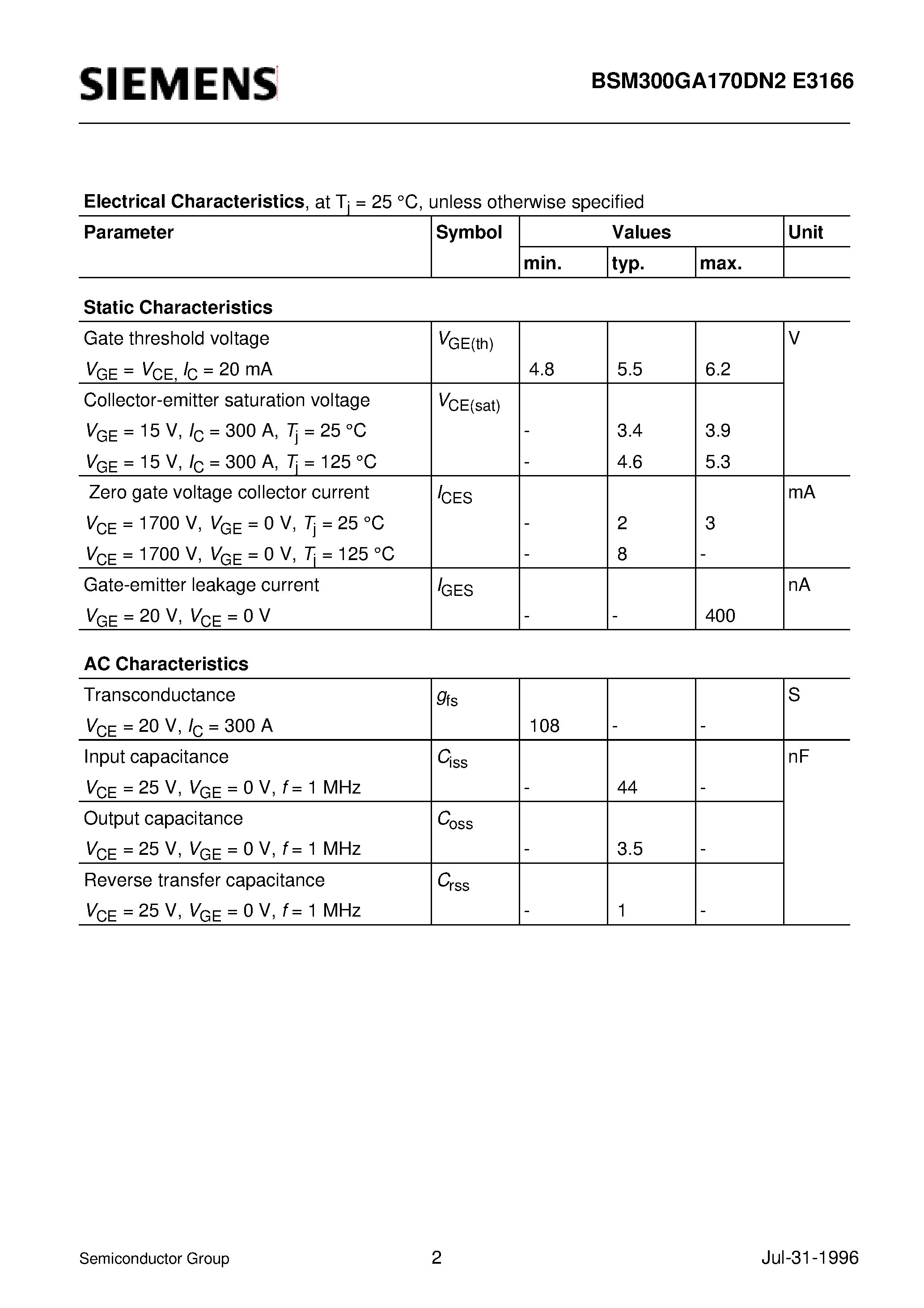

Datasheet BSM300GA170DN2E3166 - IGBT Power Module (Half-bridge Including fast free-wheeling diodes Enlarged diode area) page 2
