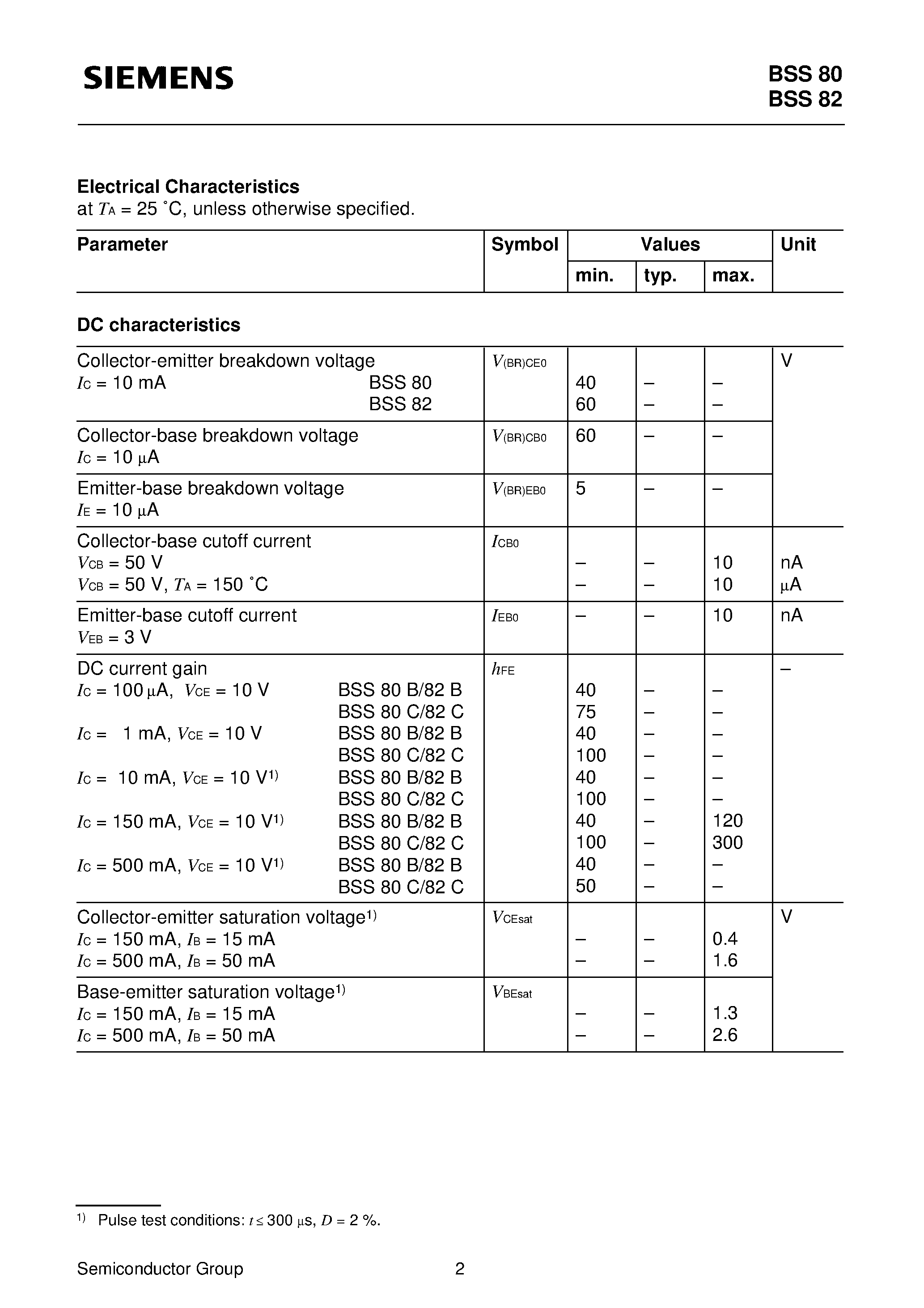

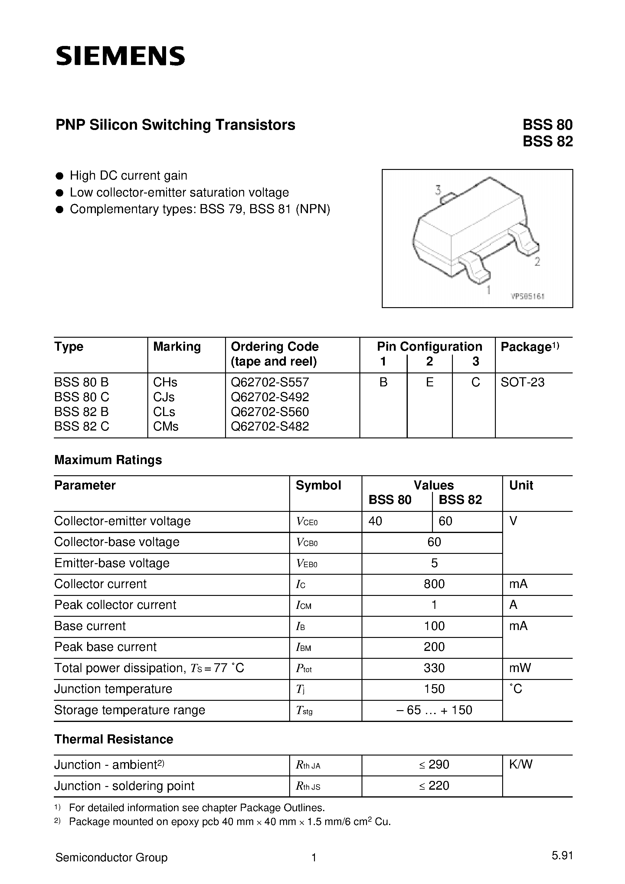

BSS80B-PNP Silicon Switching Transistors (High DC current gain Low collector-emitter saturation voltage)
Description:PNP Silicon Switching Transistors (High DC current gain Low collector-emitter saturation voltage)
Others with the same file: BSS80B
Datasheet BSS80B - PNP Silicon Switching Transistors (High DC current gain Low collector-emitter saturation voltage) page 1
Datasheet BSS80B - PNP Silicon Switching Transistors (High DC current gain Low collector-emitter saturation voltage) page 2
