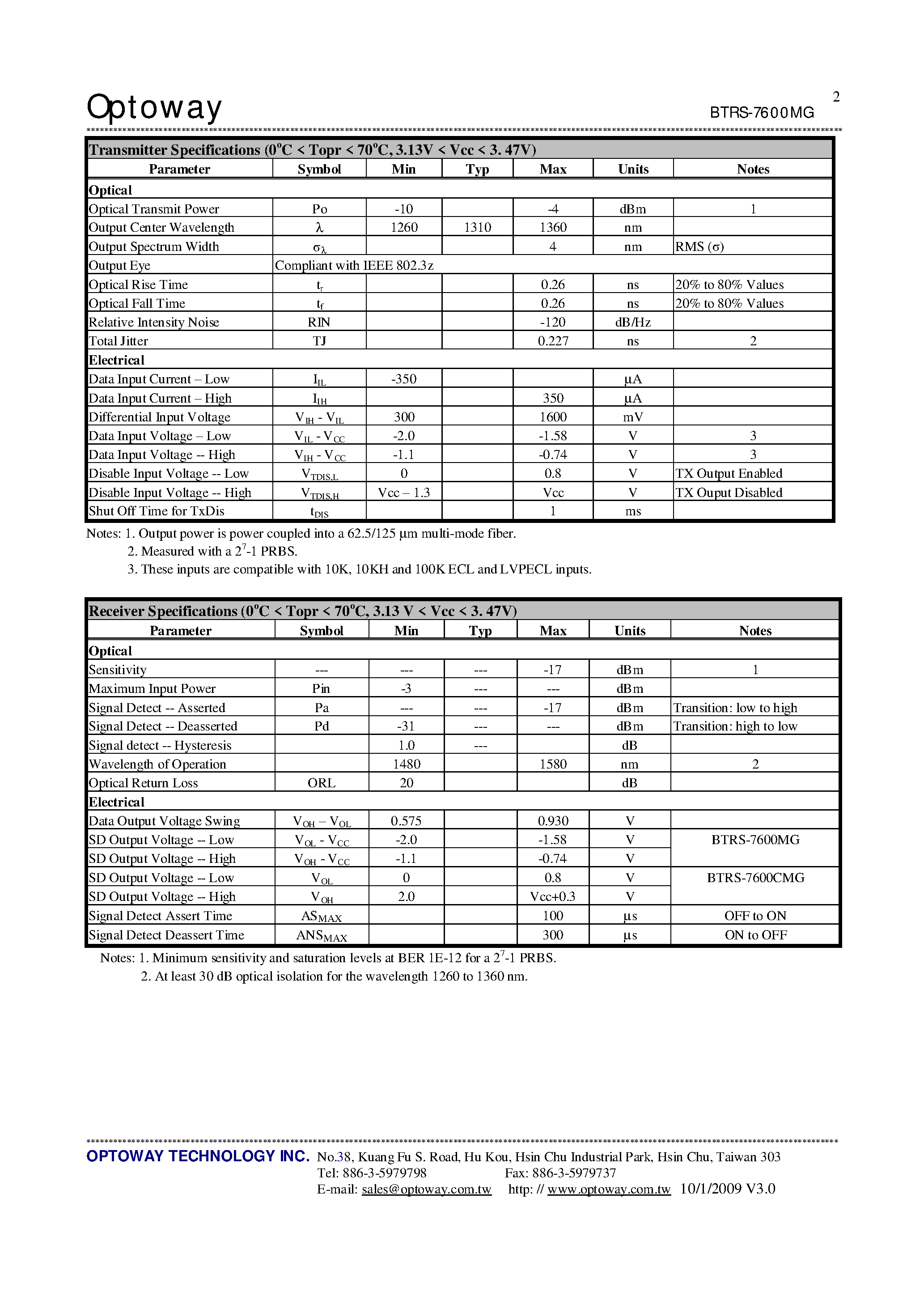

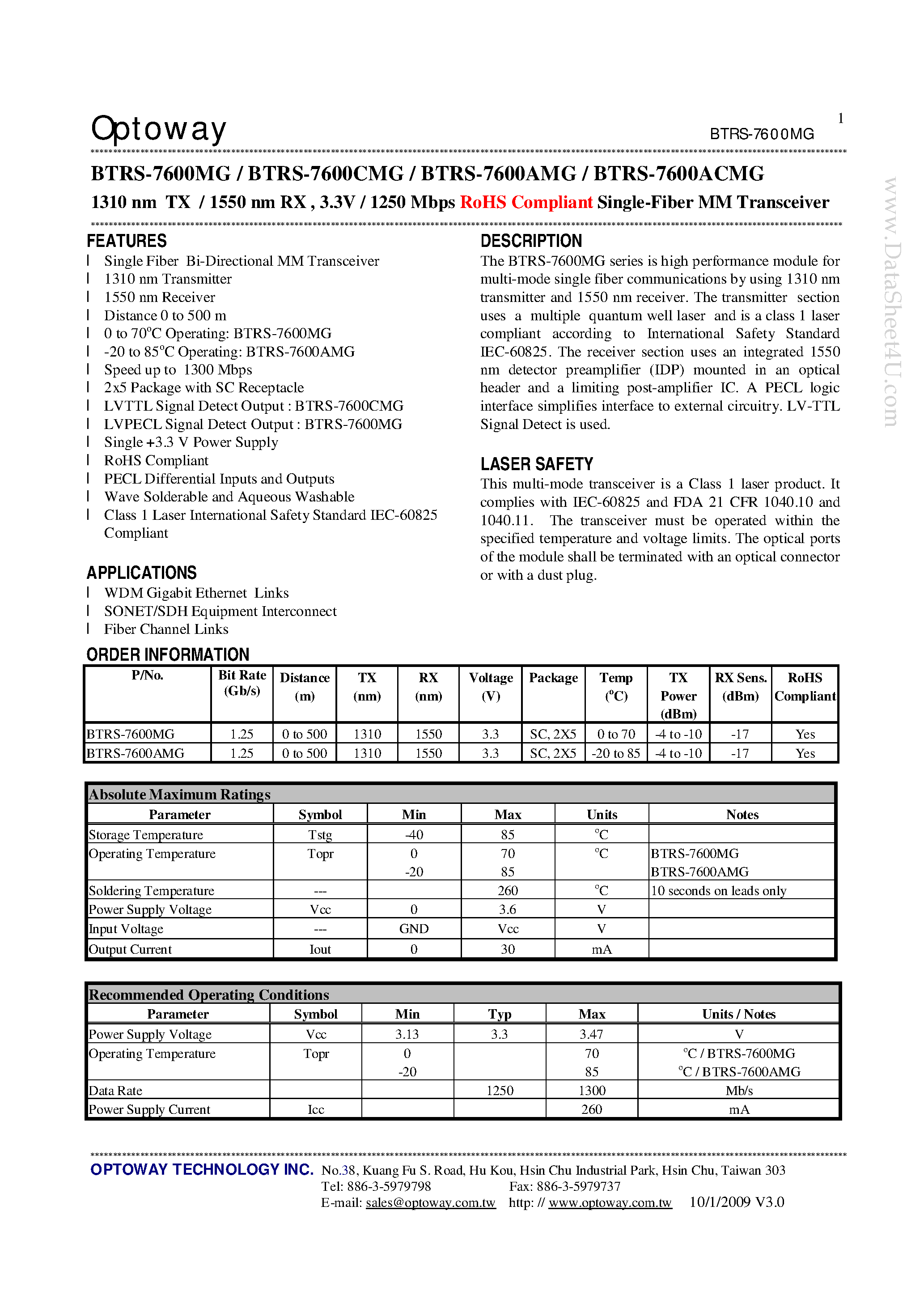

BTRS-7600ACMG-1310 nm TX / 1550 nm RX 3.3V / 1250 Mbps RoHS Compliant Single-Fiber MM Transceiver
Producer:Optoway Technology
Description:1310 nm TX / 1550 nm RX 3.3V / 1250 Mbps RoHS Compliant Single-Fiber MM Transceiver
Others with the same file: BTRS-7600ACMG | BTRS-7600AMG
BTRS-7600CMG | BTRS-7600MG
Datasheet BTRS-7600ACMG - 1310 nm TX / 1550 nm RX 3.3V / 1250 Mbps RoHS Compliant Single-Fiber MM Transceiver page 1
Datasheet BTRS-7600ACMG - 1310 nm TX / 1550 nm RX 3.3V / 1250 Mbps RoHS Compliant Single-Fiber MM Transceiver page 2
