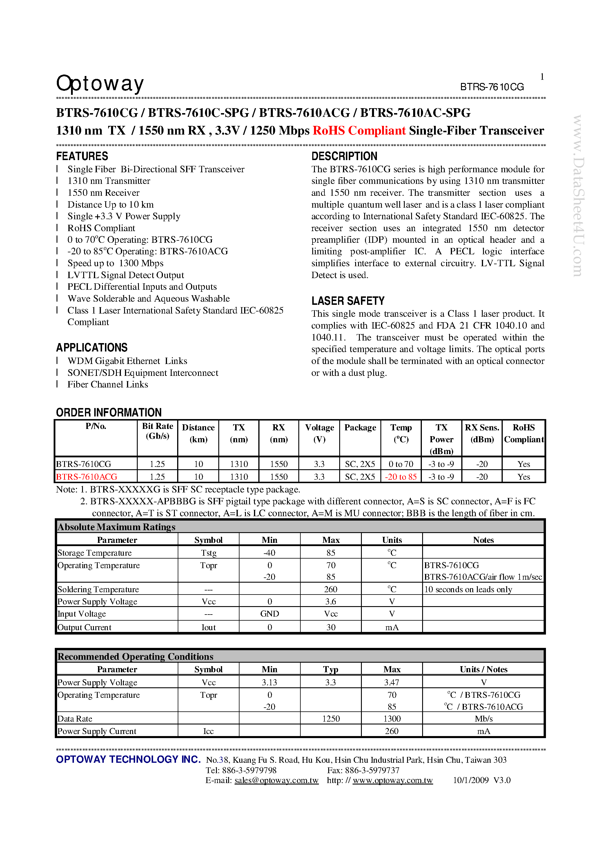

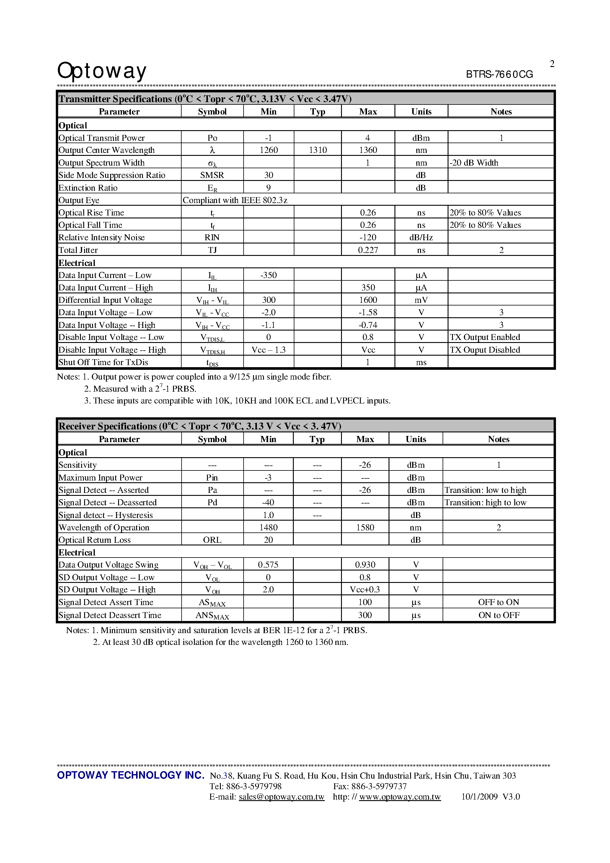

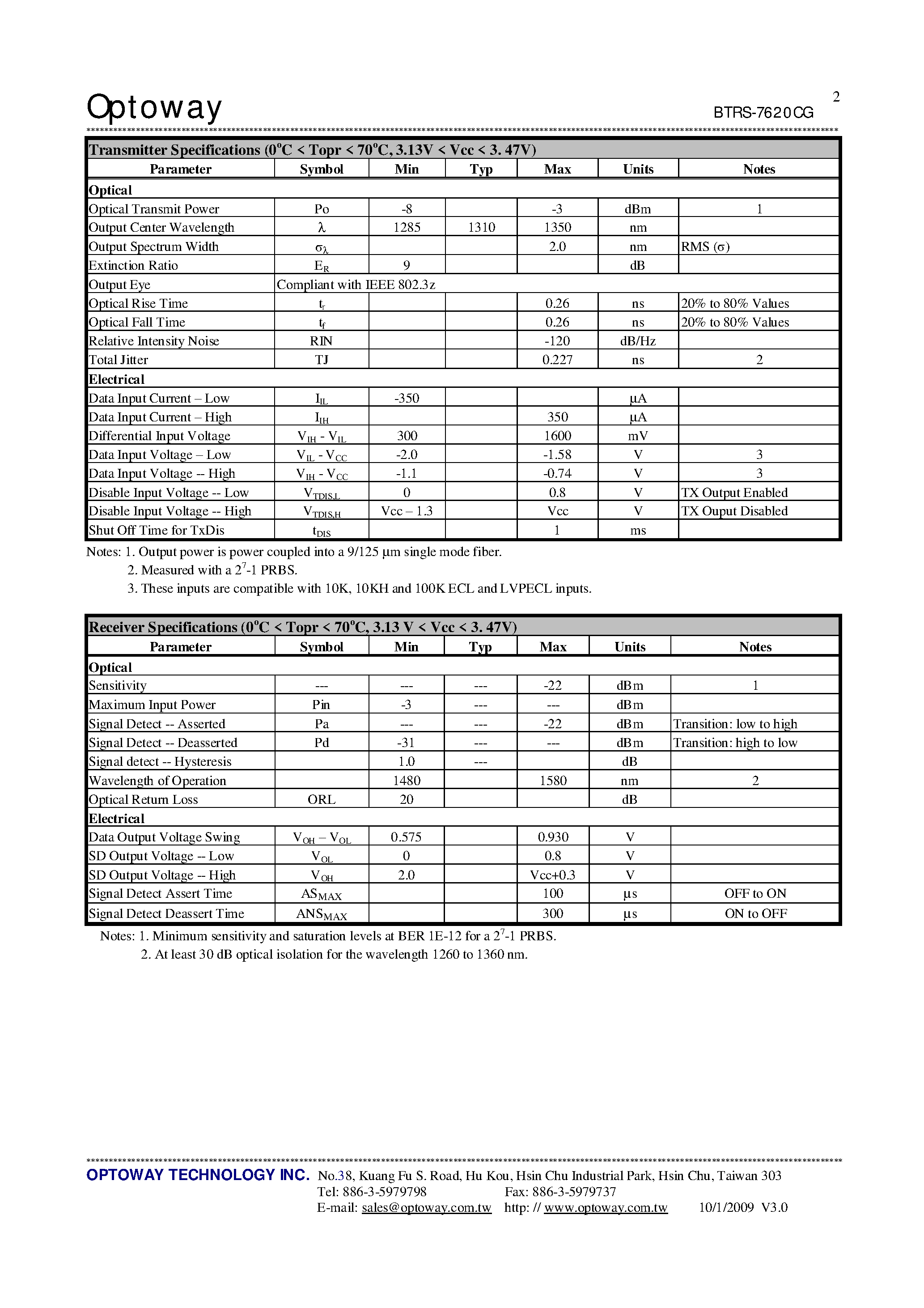

BTRS-7610AC-SPG-1310 nm TX / 1550 nm RX 3.3V / 1250 Mbps RoHS Compliant Single-Fiber Transceiver
Producer:Optoway Technology
Description:1310 nm TX / 1550 nm RX 3.3V / 1250 Mbps RoHS Compliant Single-Fiber Transceiver
