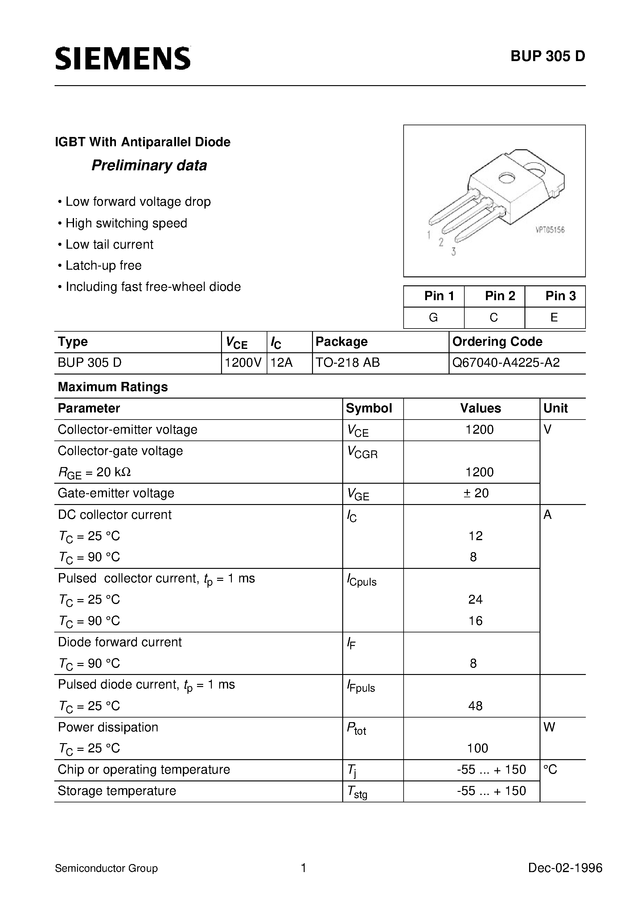

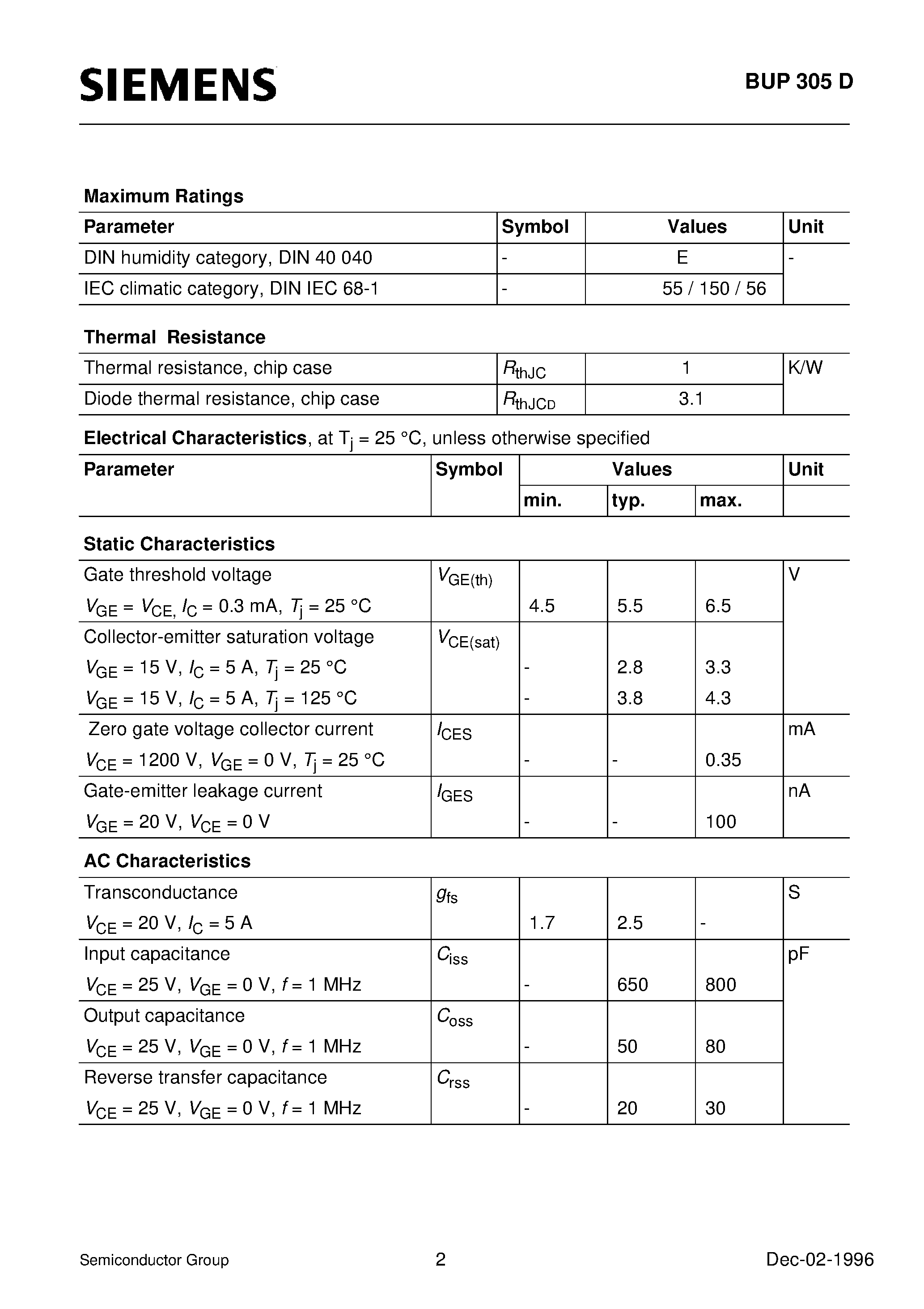

BUP305-IGBT With Antiparallel Diode (Low forward voltage drop High switching speed Low tail current Latch-up free Including fast free-wheel diode)
Description:IGBT With Antiparallel Diode (Low forward voltage drop High switching speed Low tail current Latch-up free Including fast free-wheel diode)
Others with the same file: BUP305
Datasheet BUP305 - IGBT With Antiparallel Diode (Low forward voltage drop High switching speed Low tail current Latch-up free Including fast free-wheel diode) page 1
Datasheet BUP305 - IGBT With Antiparallel Diode (Low forward voltage drop High switching speed Low tail current Latch-up free Including fast free-wheel diode) page 2
