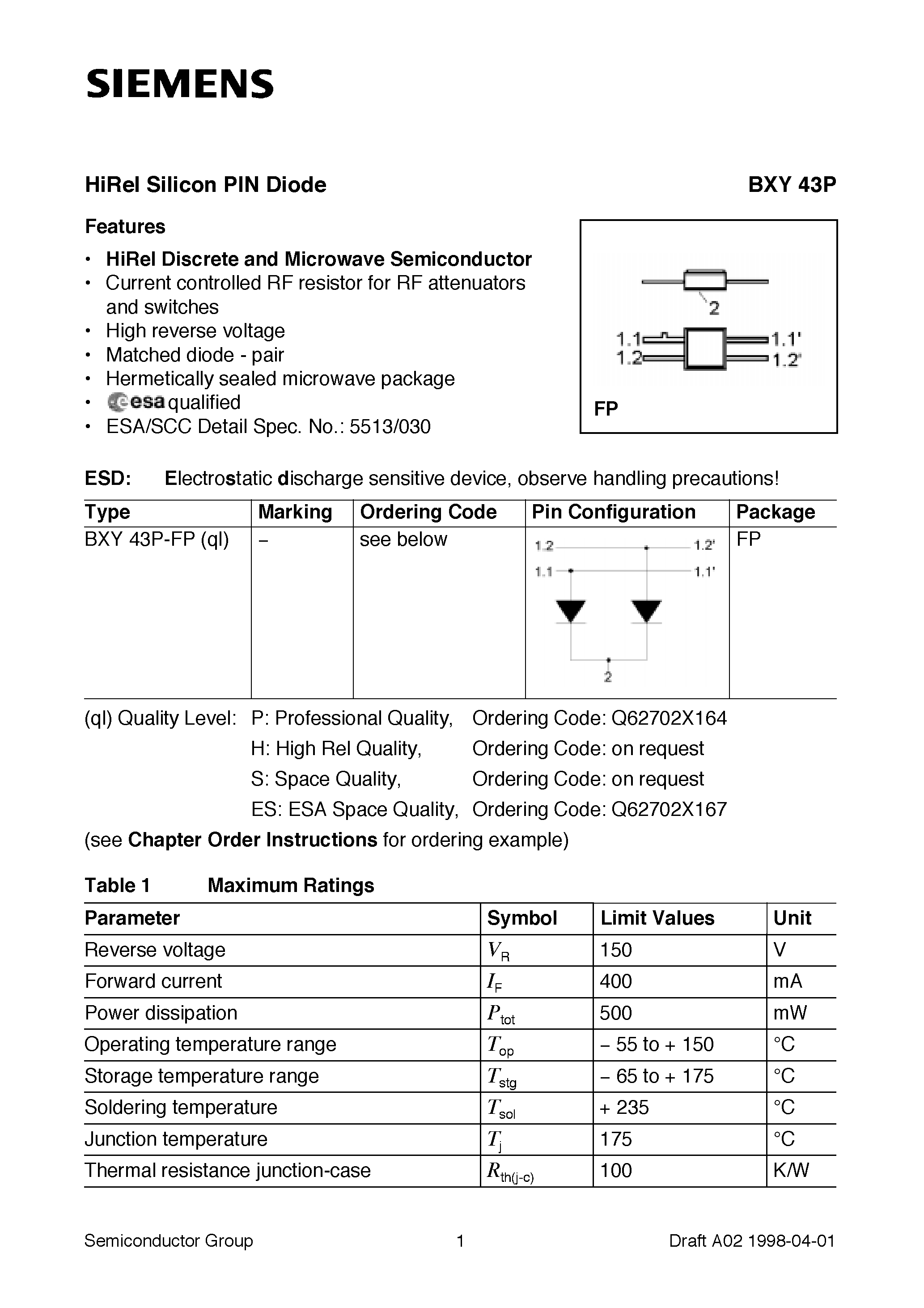

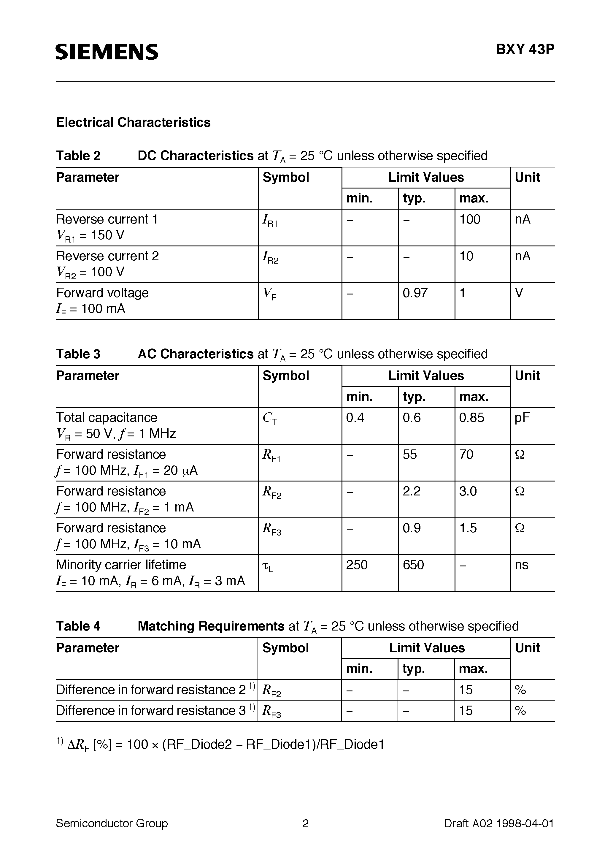

BXY43P-FP-HiRel Silicon PIN Diode (HiRel Discrete and Microwave Semiconductor Current controlled RF resistor for RF attenuators and switches)
Description:HiRel Silicon PIN Diode (HiRel Discrete and Microwave Semiconductor Current controlled RF resistor for RF attenuators and switches)
Others with the same file: BXY43P-FP
Datasheet BXY43P-FP - HiRel Silicon PIN Diode (HiRel Discrete and Microwave Semiconductor Current controlled RF resistor for RF attenuators and switches) page 1
Datasheet BXY43P-FP - HiRel Silicon PIN Diode (HiRel Discrete and Microwave Semiconductor Current controlled RF resistor for RF attenuators and switches) page 2
