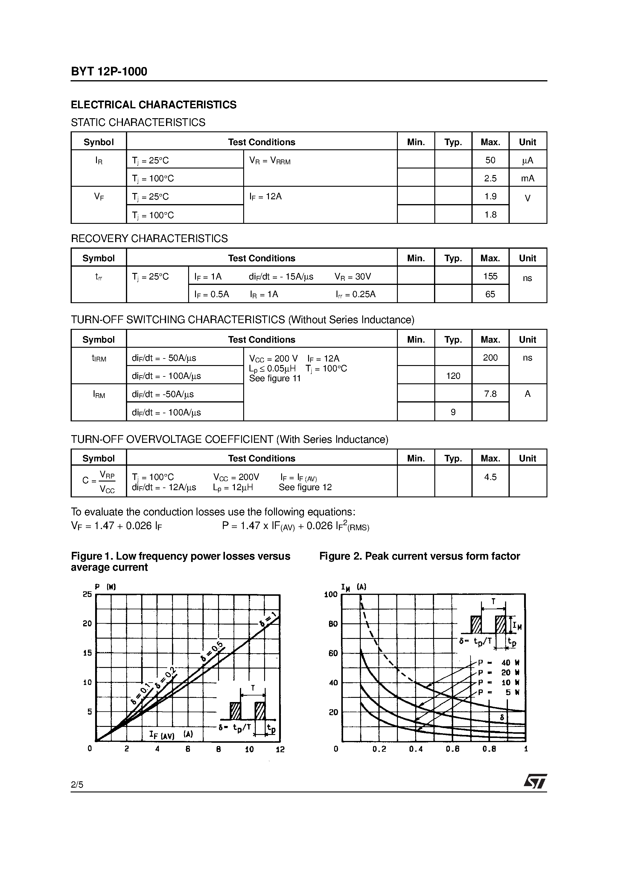

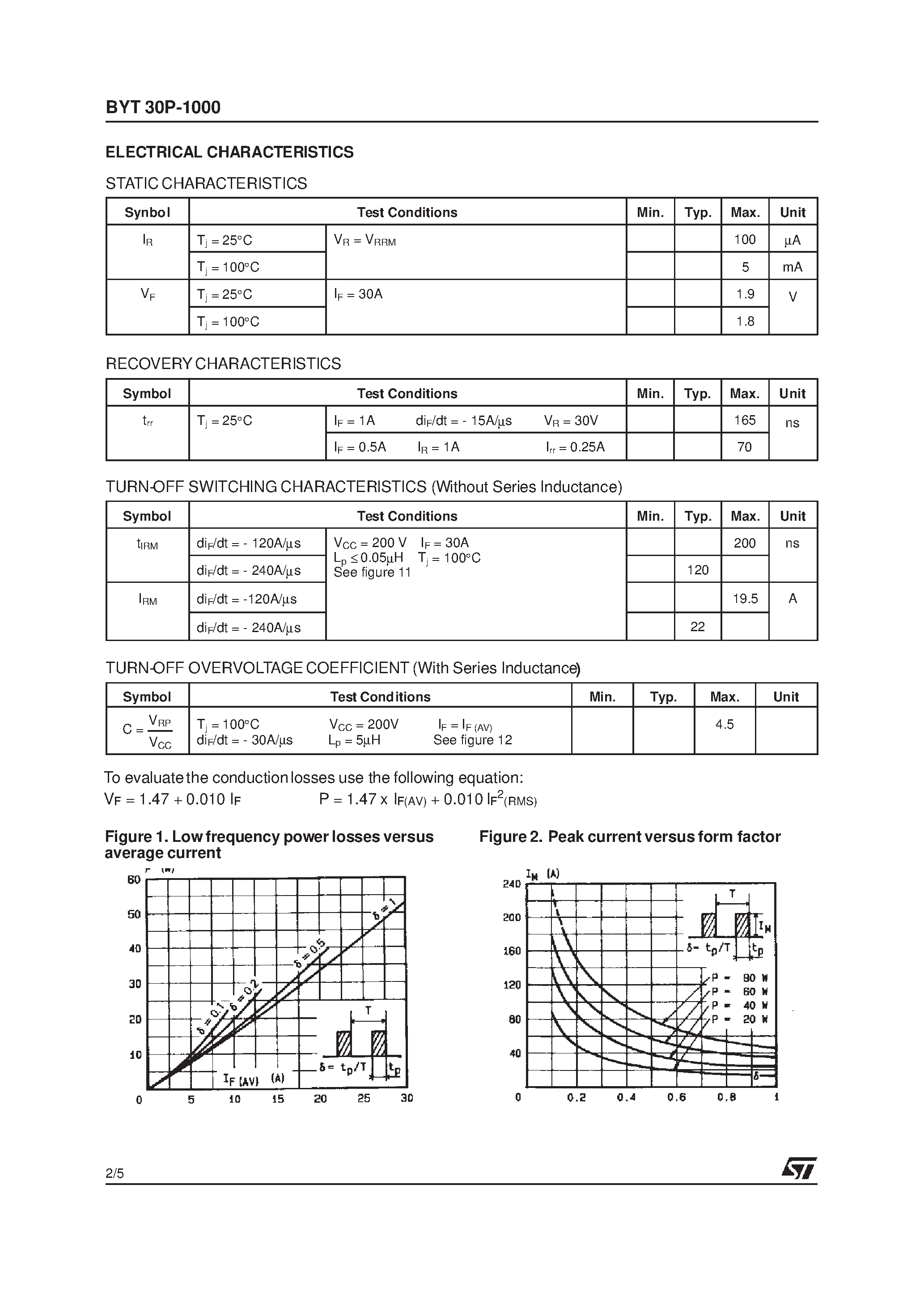

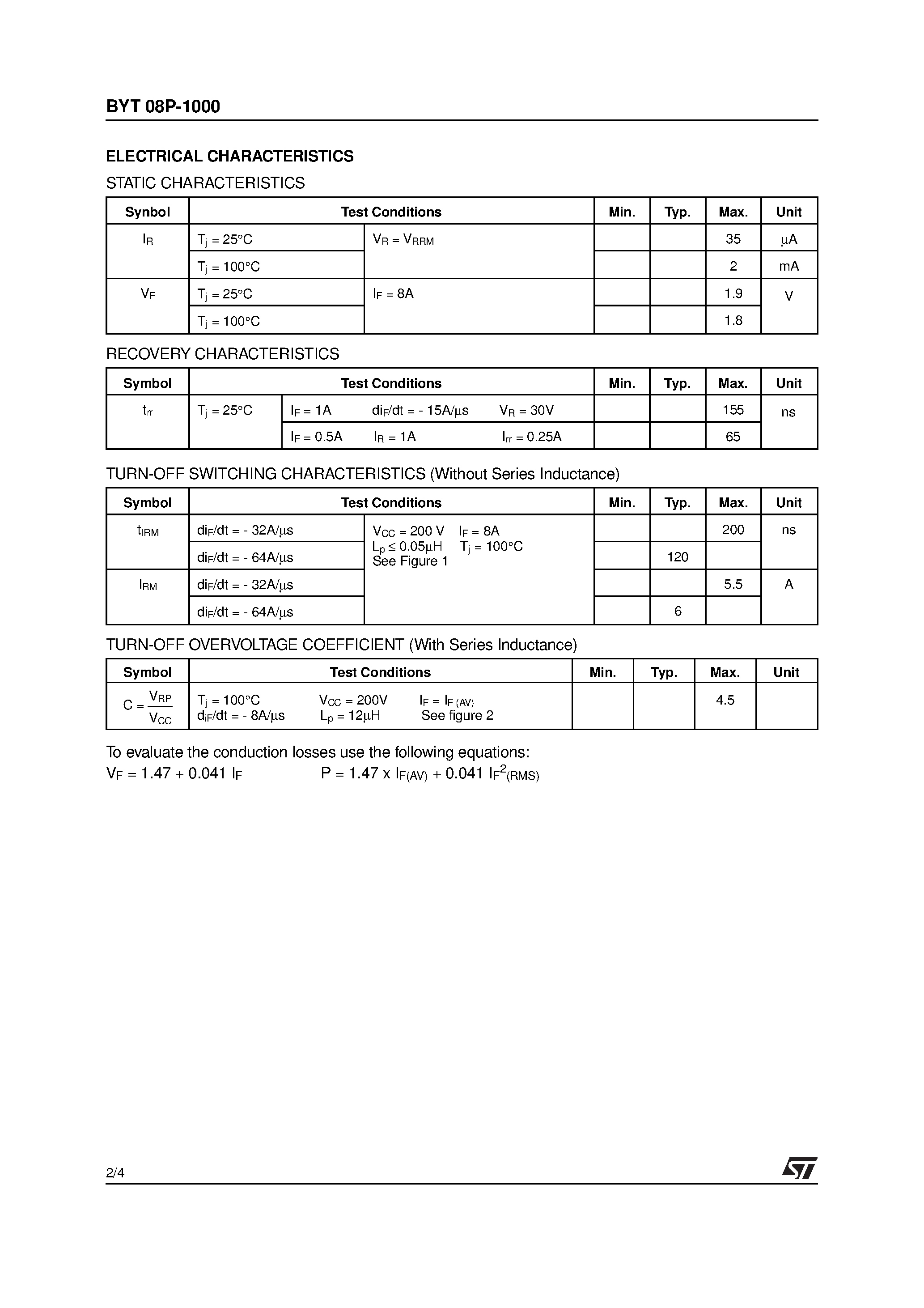

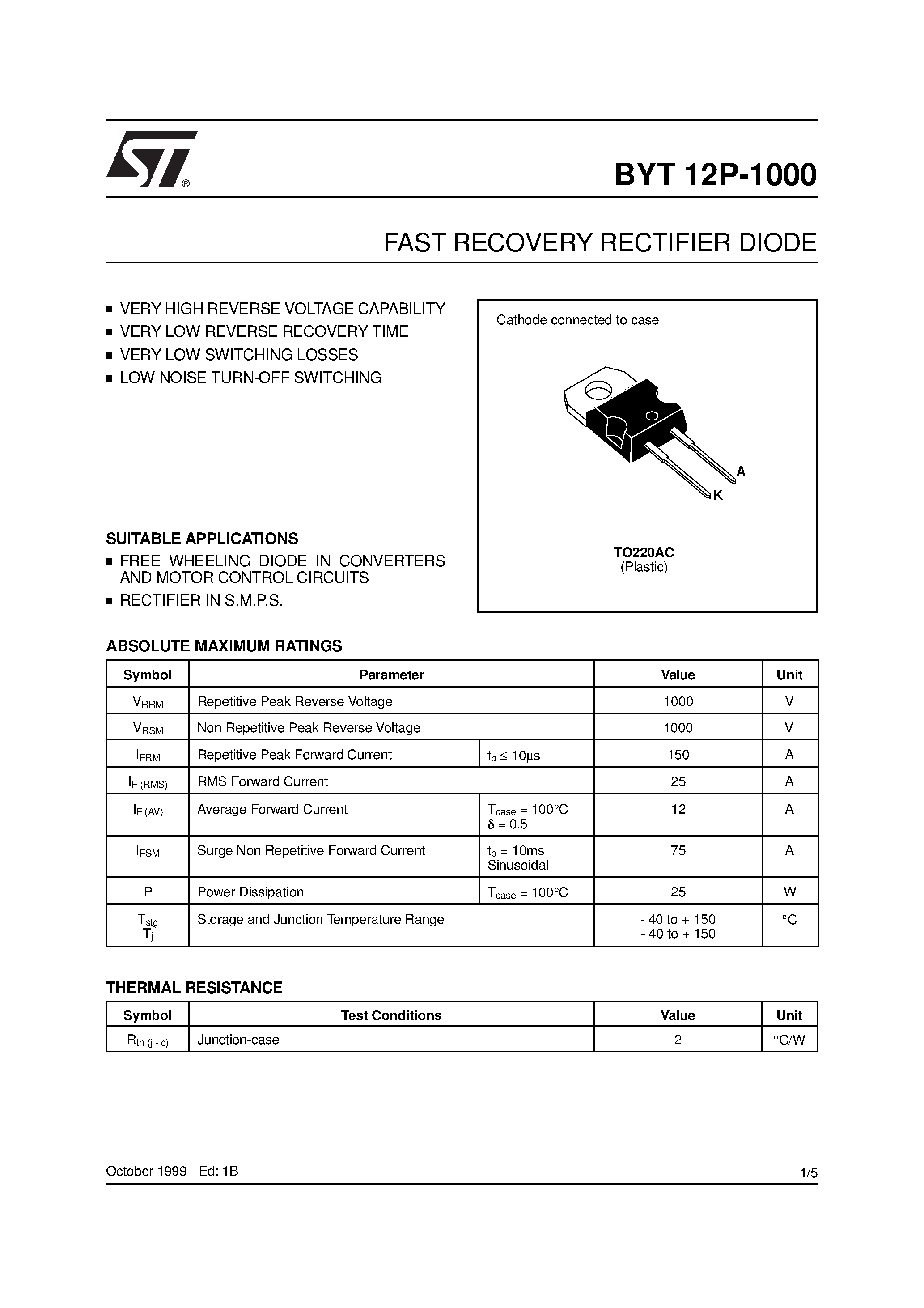

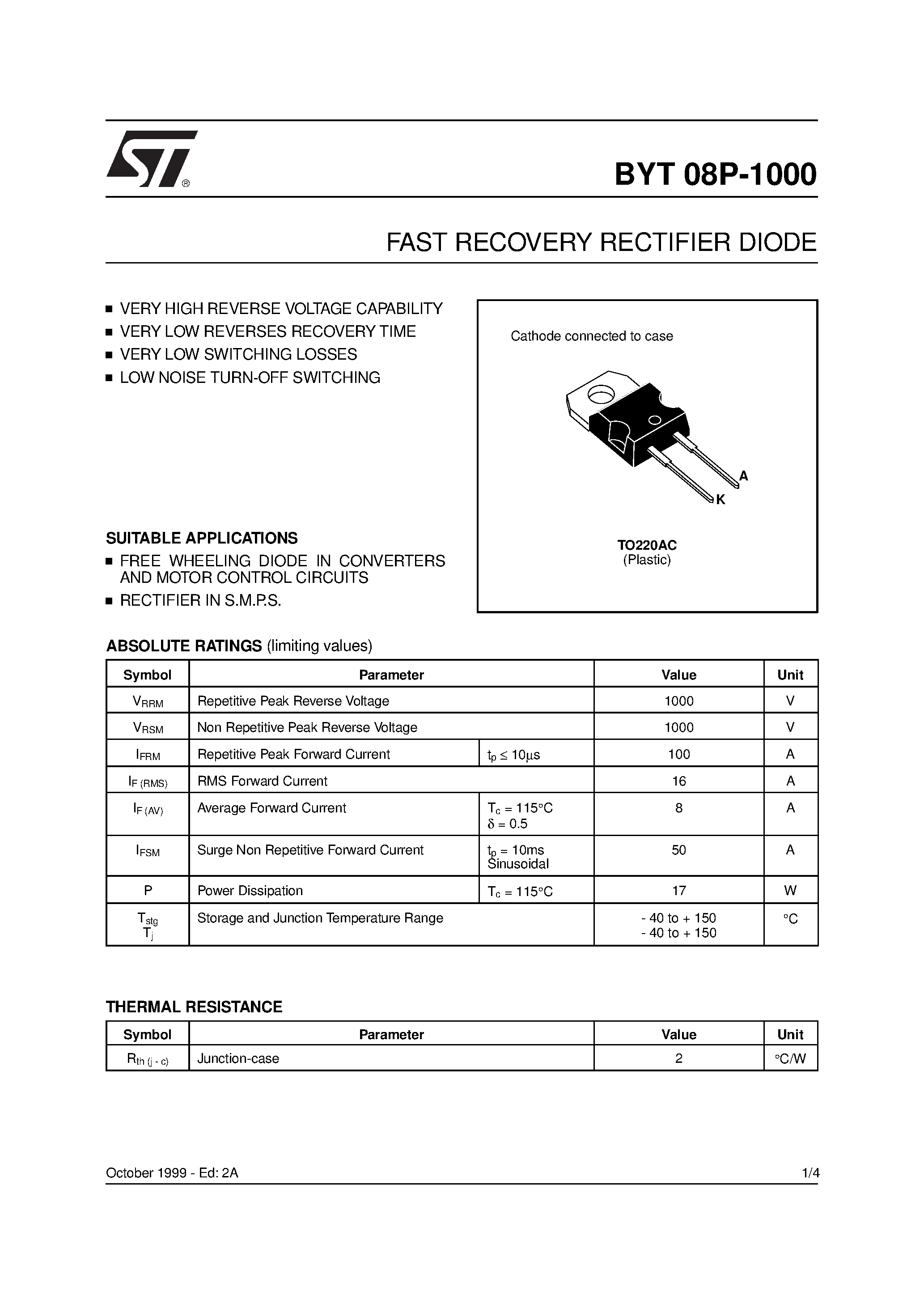

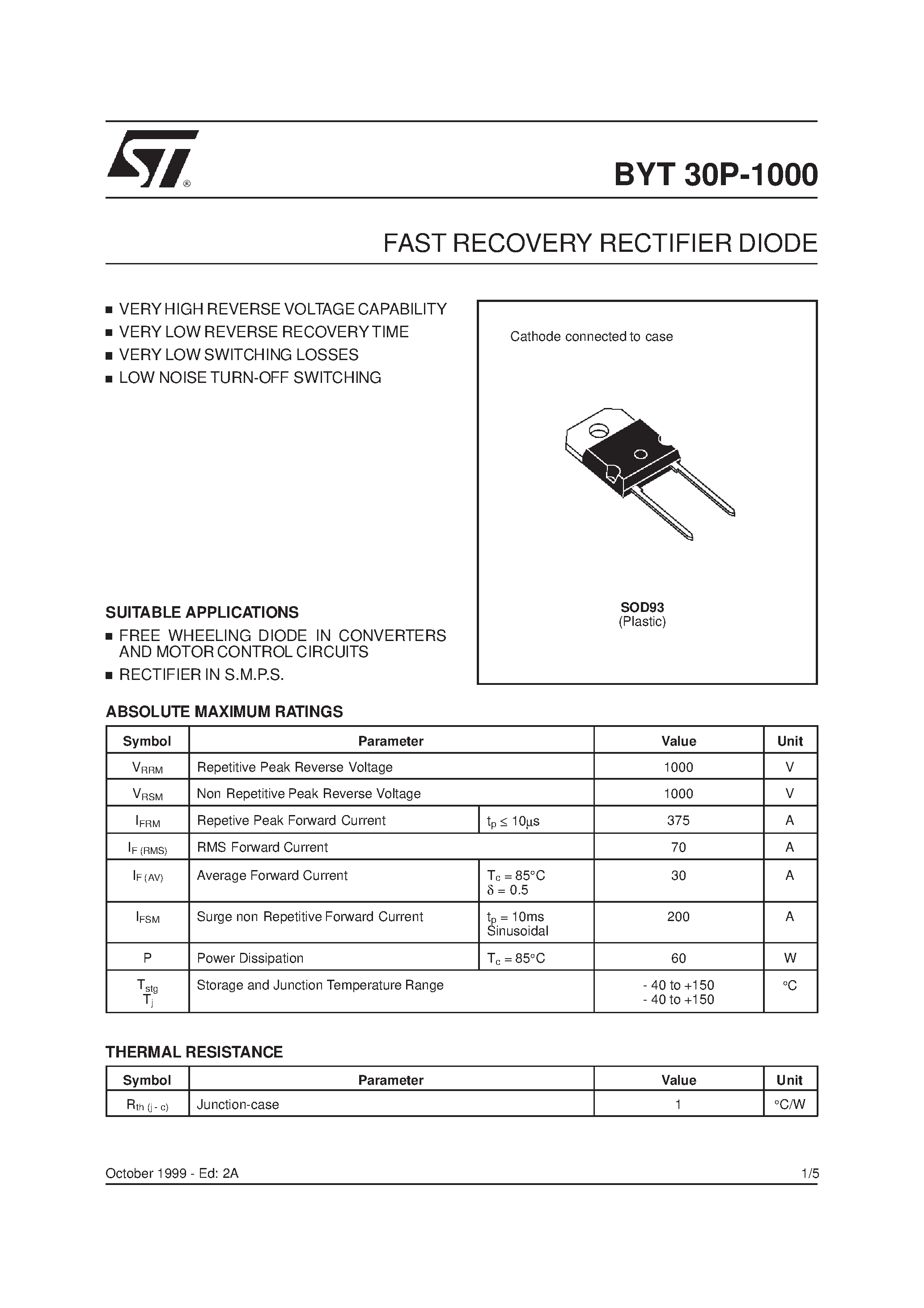

BYT08P-1000-FAST RECOVERY RECTIFIER DIODE
Producer:STMicroelectronics
Description:FAST RECOVERY RECTIFIER DIODE
Others with the same file: BYT08P-1000
Datasheet BYT08P-1000 - FAST RECOVERY RECTIFIER DIODE page 1
Datasheet BYT08P-1000 - FAST RECOVERY RECTIFIER DIODE page 2
