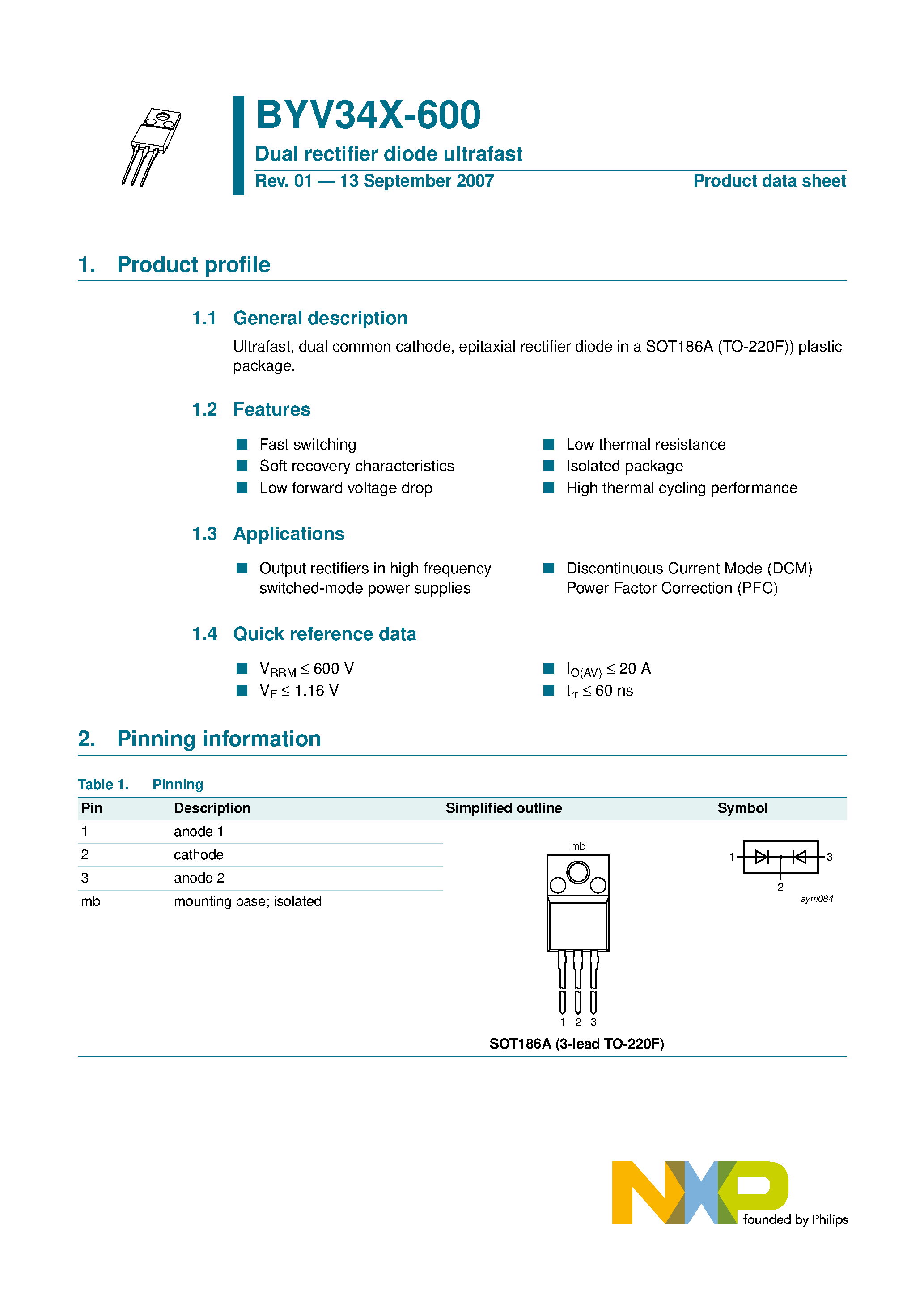

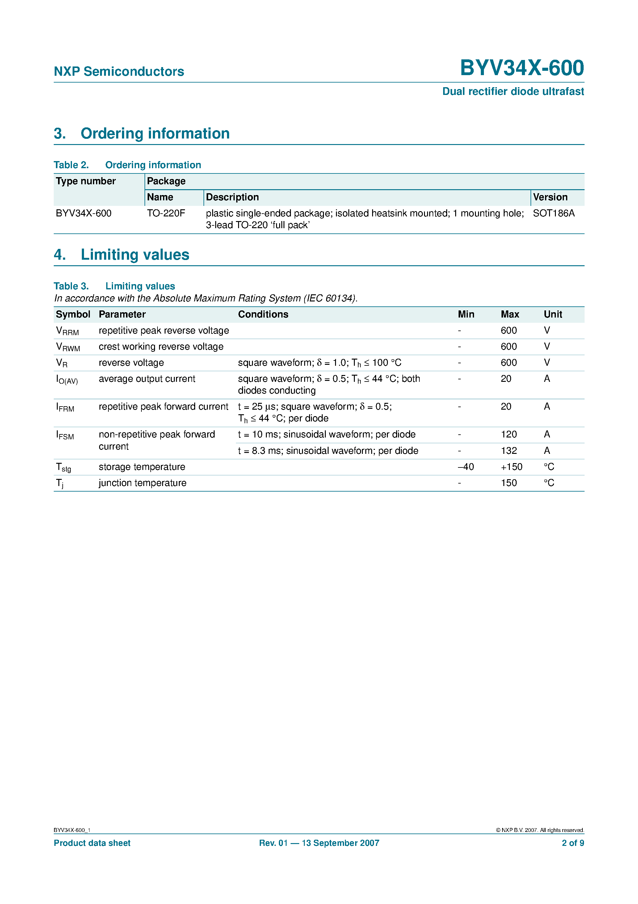

BYV34X-600-Dual rectifier diode ultrafast
Description:Dual rectifier diode ultrafast
Others with the same file: BYV34X-600
Datasheet BYV34X-600 - Dual rectifier diode ultrafast page 1
Datasheet BYV34X-600 - Dual rectifier diode ultrafast page 2
