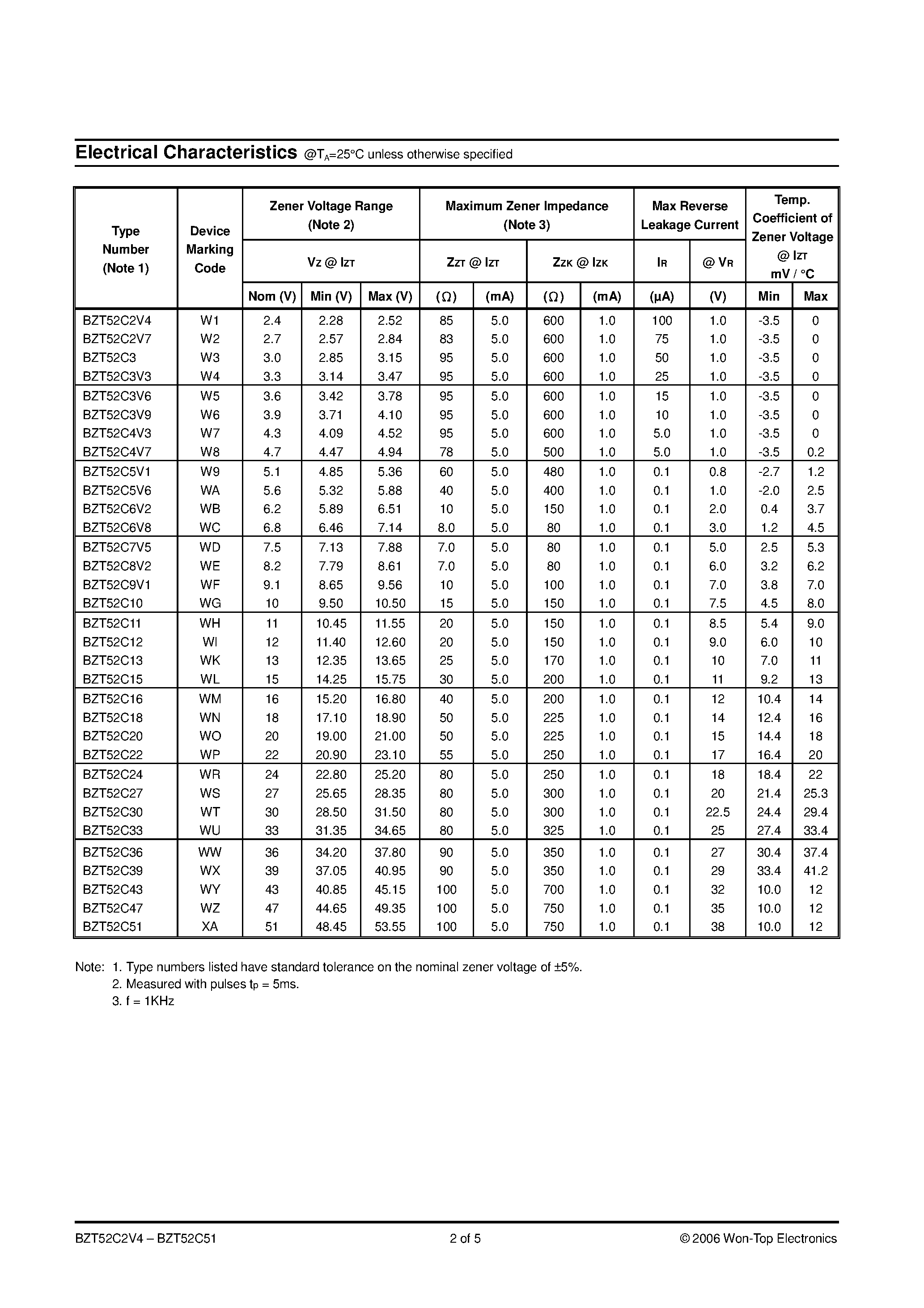

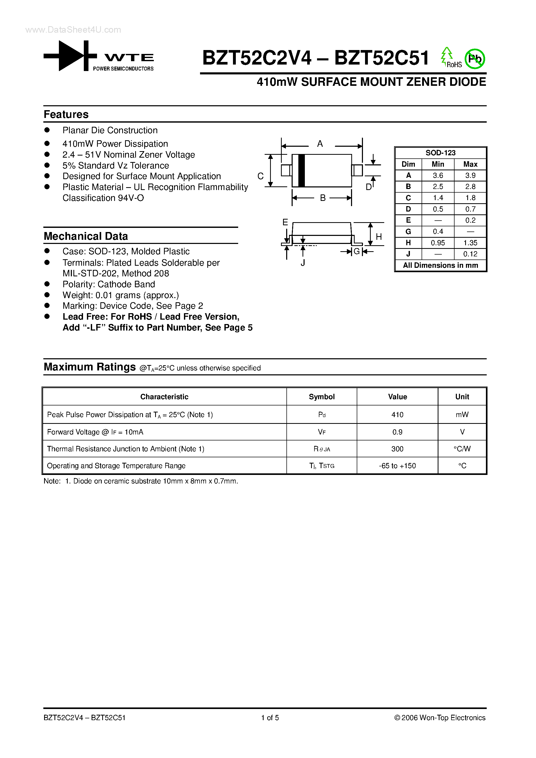

BZT52C10-(BZT52C2V4 - BZT52C51) SURFACE MOUNT ZENER DIODE
Producer:Won-Top Electronics
Description:(BZT52C2V4 - BZT52C51) SURFACE MOUNT ZENER DIODE
