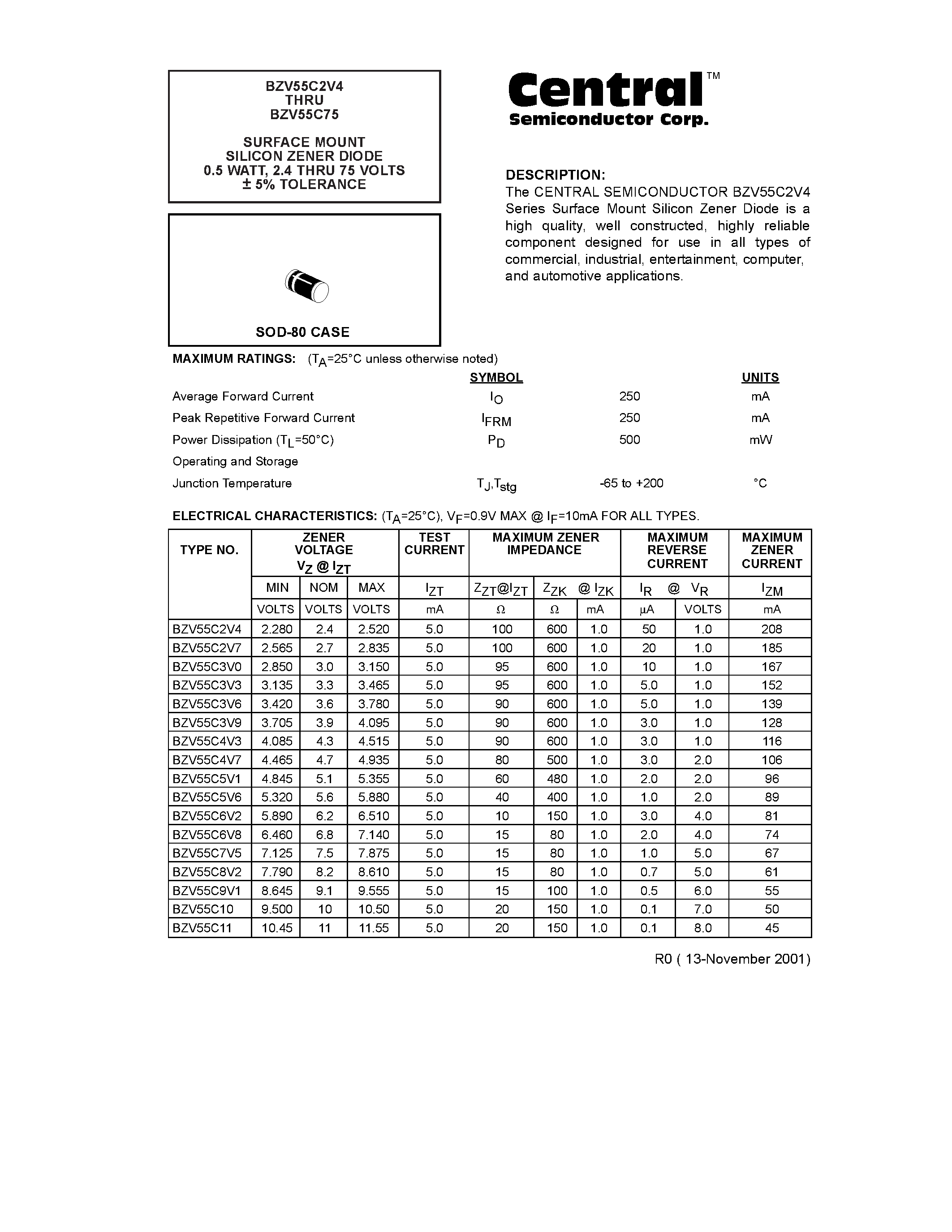

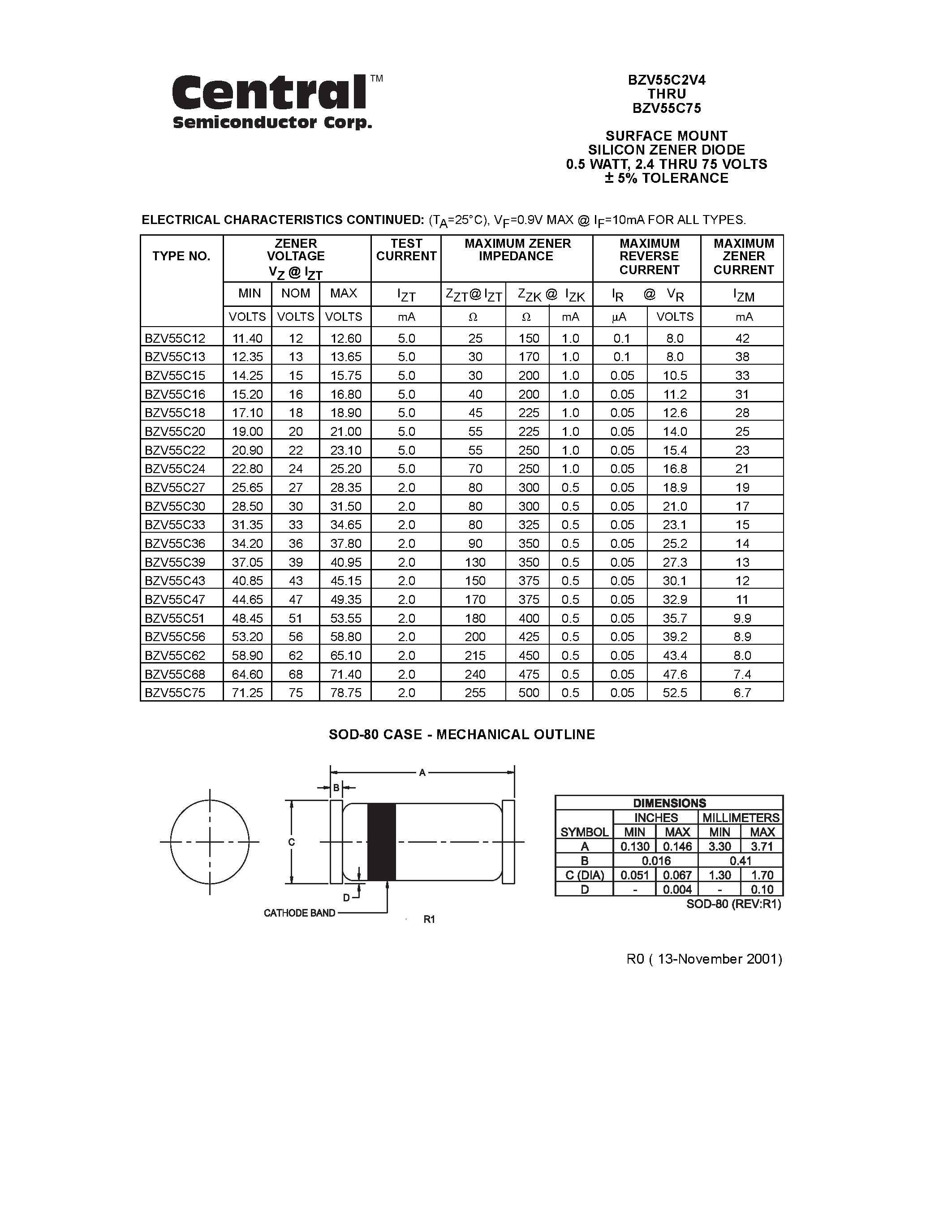

BZV55C2V4-SURFACE MOUNT SILICON ZENER DIODE 0.5 WATT/ 2.4 THRU 75 VOLTS 5ANCE
Producer:Central Semiconductor Corp
Description:SURFACE MOUNT SILICON ZENER DIODE 0.5 WATT/ 2.4 THRU 75 VOLTS 5ANCE
Others with the same file: BZV55C2V4
Datasheet BZV55C2V4 - SURFACE MOUNT SILICON ZENER DIODE 0.5 WATT/ 2.4 THRU 75 VOLTS 5ANCE page 1
Datasheet BZV55C2V4 - SURFACE MOUNT SILICON ZENER DIODE 0.5 WATT/ 2.4 THRU 75 VOLTS 5ANCE page 2
