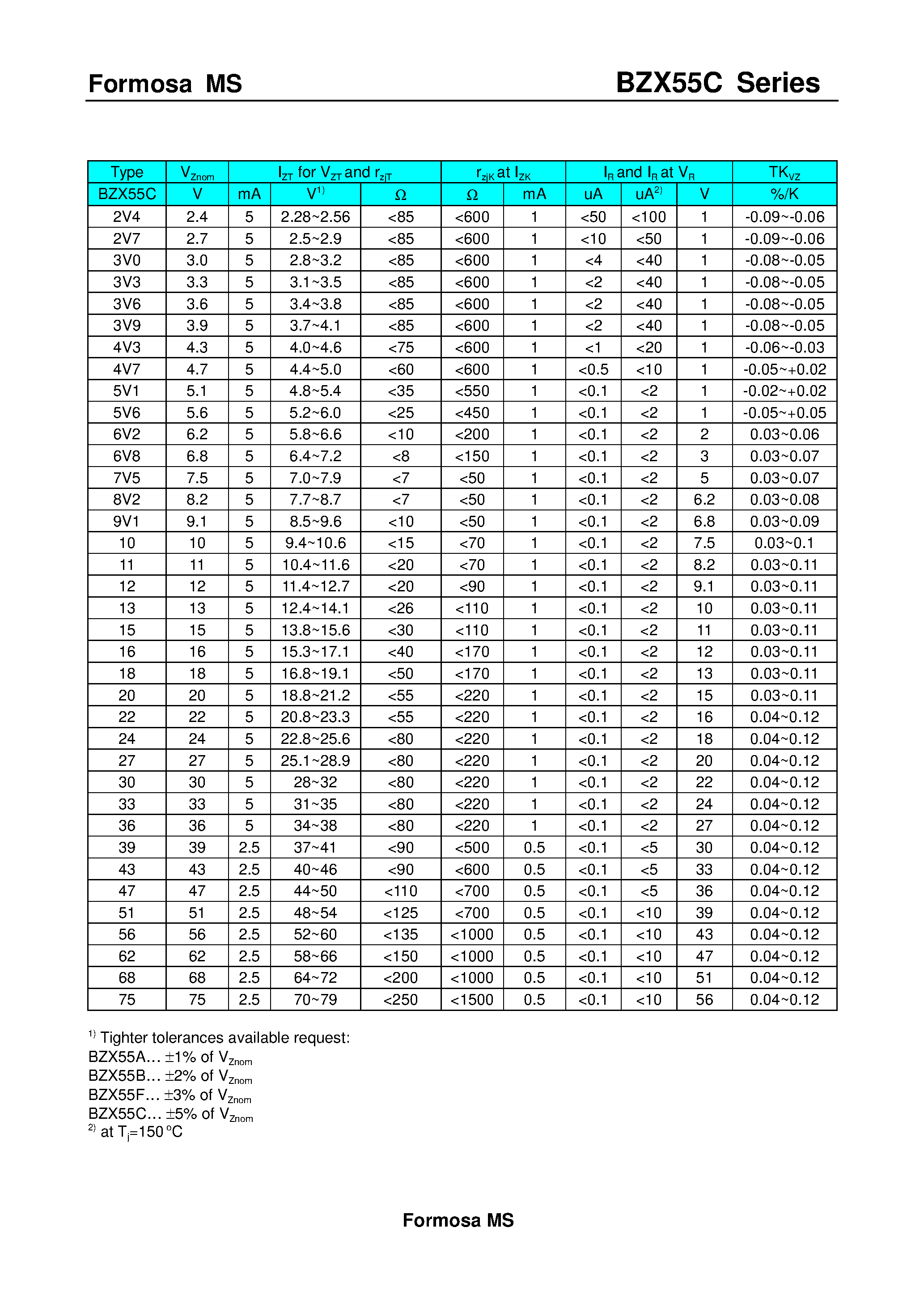

Datasheet BZX55C - Zener diode page 1

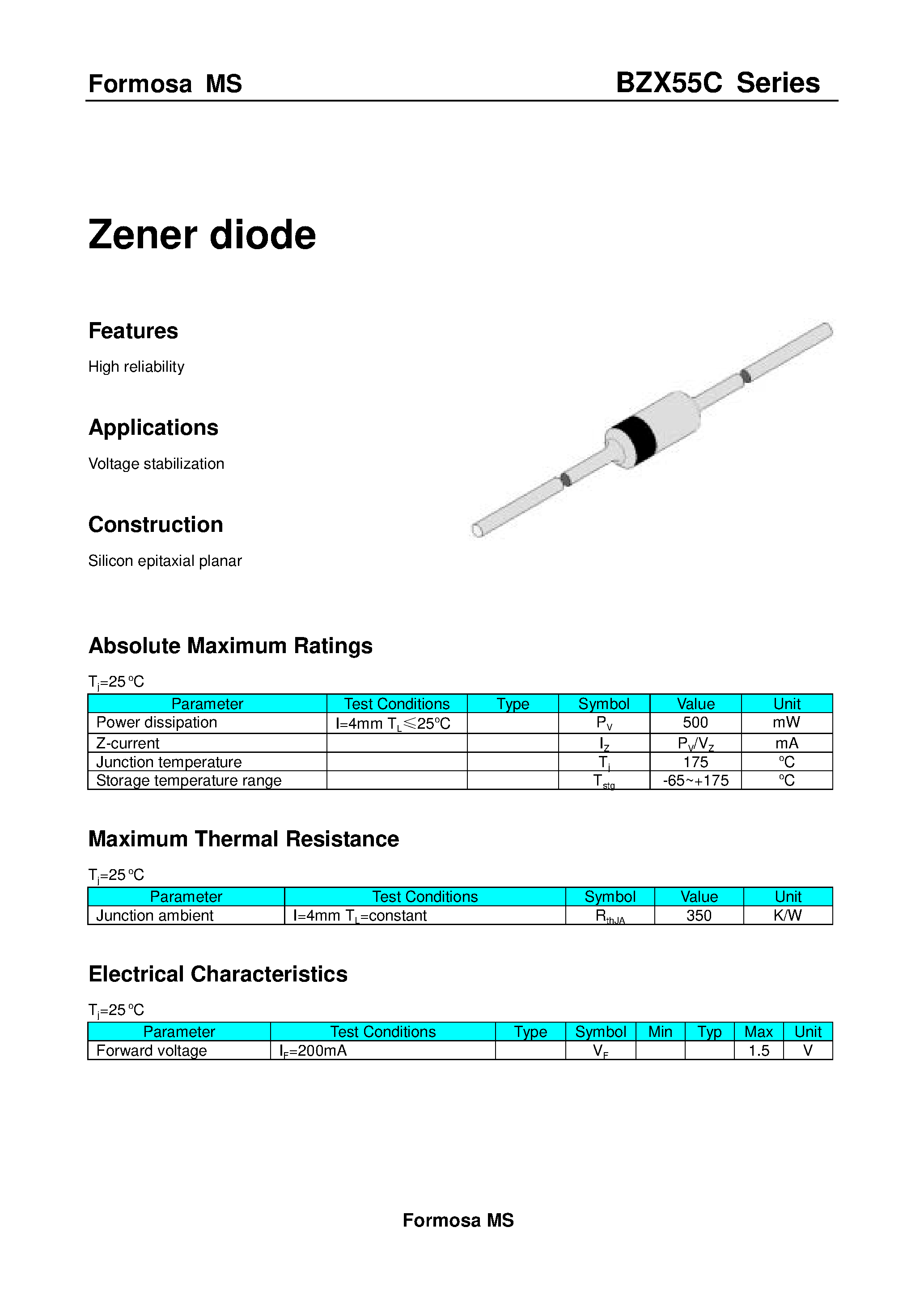

Datasheet BZX55C - Zener diode page 2
