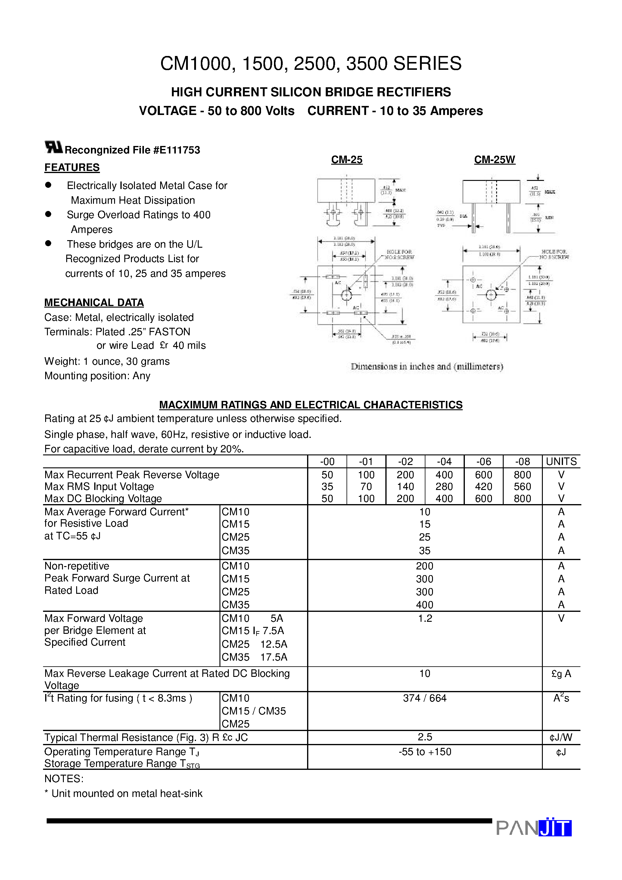

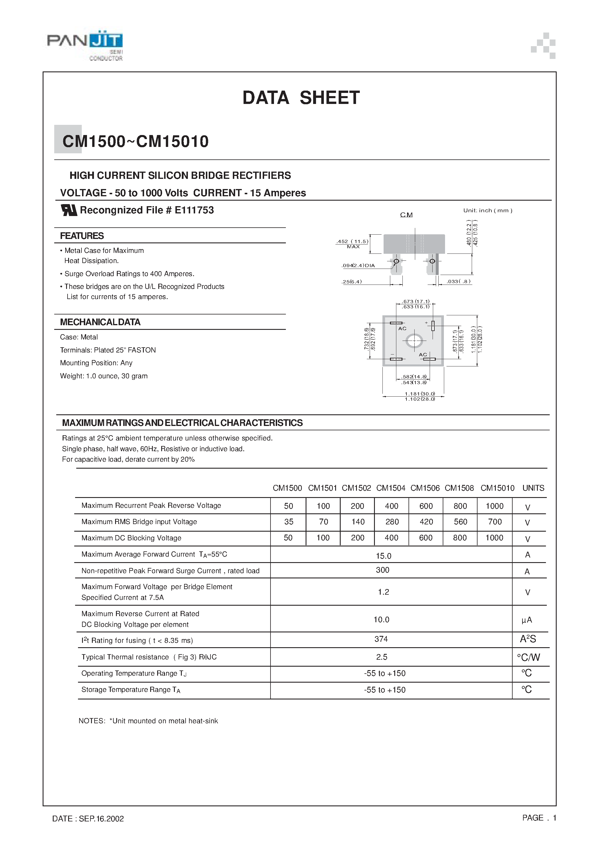

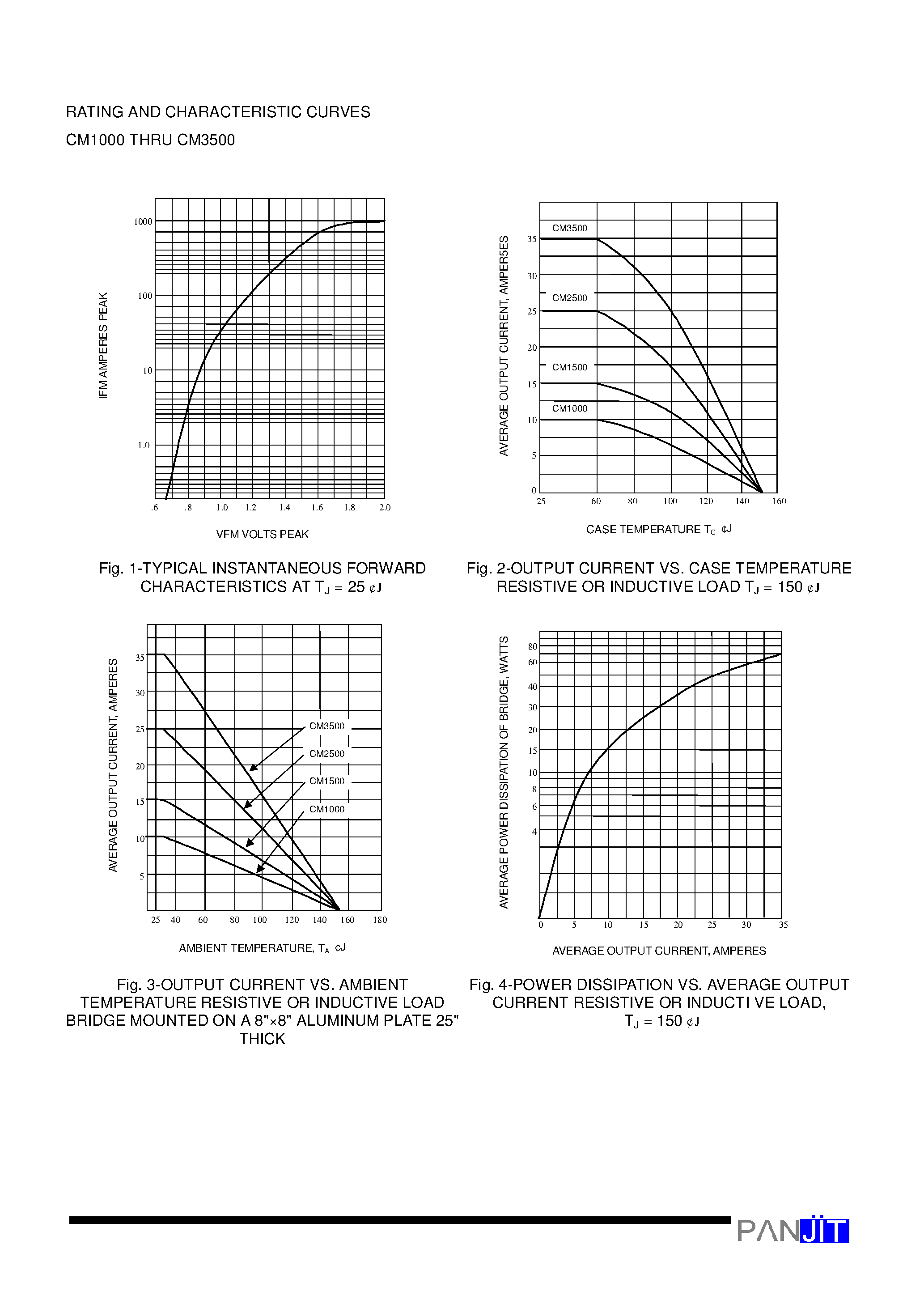

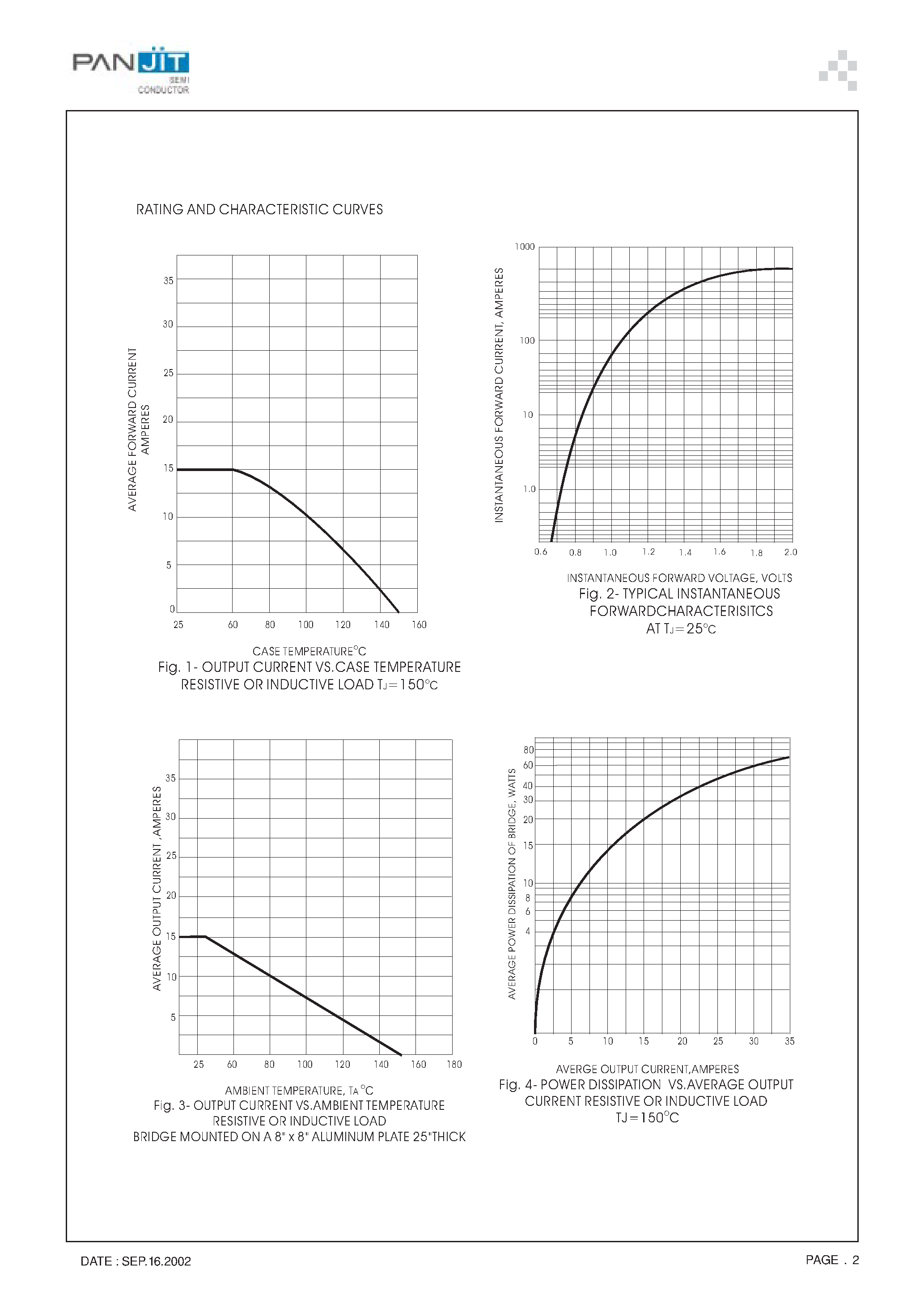

CM15010-HIGH CURRENT SILICON BRIDGE RECTIFIERS(VOLTAGE - 50 to 1000 Volts CURRENT - 15 Amperes)
Producer:Pan Jit International Inc.
Description:HIGH CURRENT SILICON BRIDGE RECTIFIERS(VOLTAGE - 50 to 1000 Volts CURRENT - 15 Amperes)
Others with the same file: CM15010
Datasheet CM15010 - HIGH CURRENT SILICON BRIDGE RECTIFIERS(VOLTAGE - 50 to 1000 Volts CURRENT - 15 Amperes) page 1
Datasheet CM15010 - HIGH CURRENT SILICON BRIDGE RECTIFIERS(VOLTAGE - 50 to 1000 Volts CURRENT - 15 Amperes) page 2
