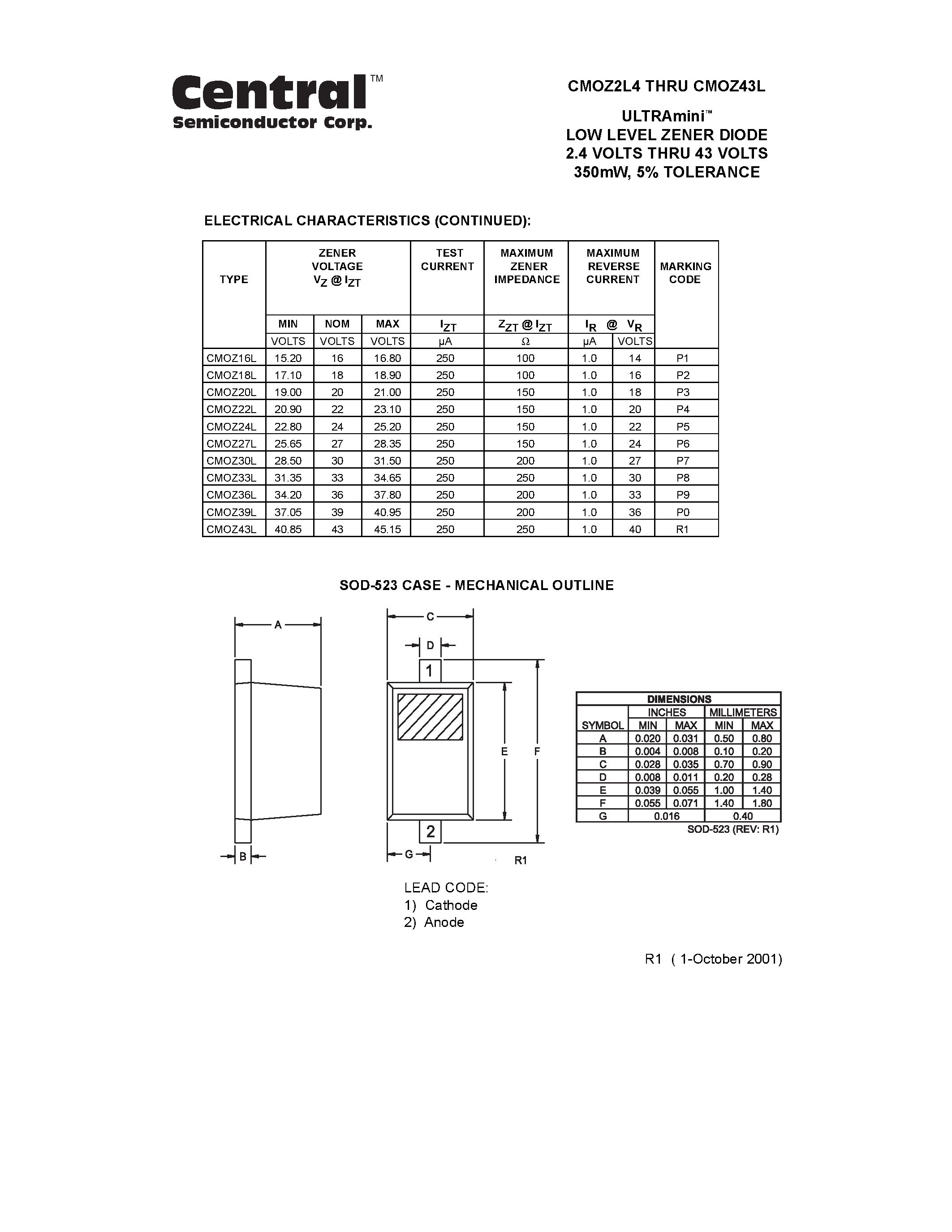

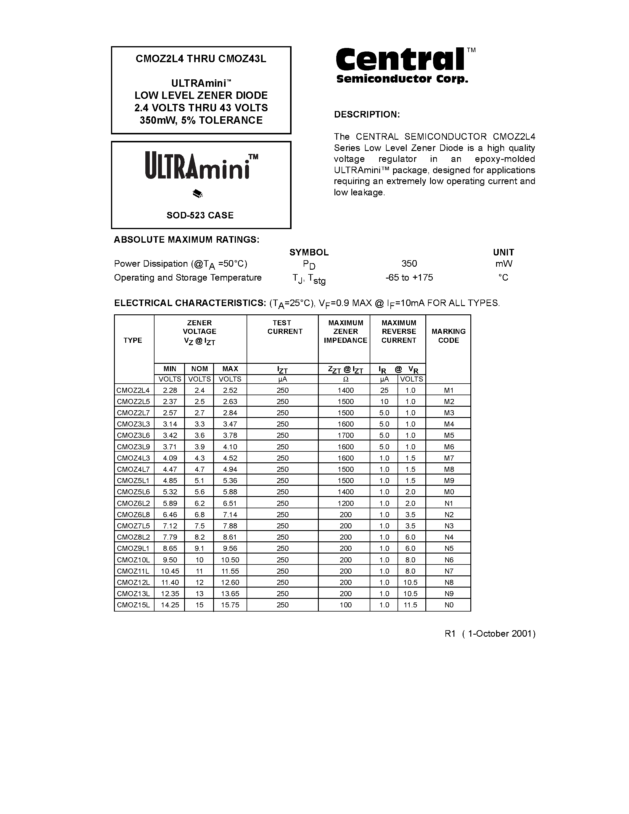

CMOZ10L-ULTRAmini. LOW LEVEL ZENER DIODE 2.4 VOLTS THRU 43 VOLTS 350mW/ 5% TOLERANCE
Producer:Central Semiconductor Corp
Description:ULTRAmini. LOW LEVEL ZENER DIODE 2.4 VOLTS THRU 43 VOLTS 350mW/ 5% TOLERANCE
Others with the same file: CMOZ10L
Datasheet CMOZ10L - ULTRAmini. LOW LEVEL ZENER DIODE 2.4 VOLTS THRU 43 VOLTS 350mW/ 5% TOLERANCE page 1
Datasheet CMOZ10L - ULTRAmini. LOW LEVEL ZENER DIODE 2.4 VOLTS THRU 43 VOLTS 350mW/ 5% TOLERANCE page 2
