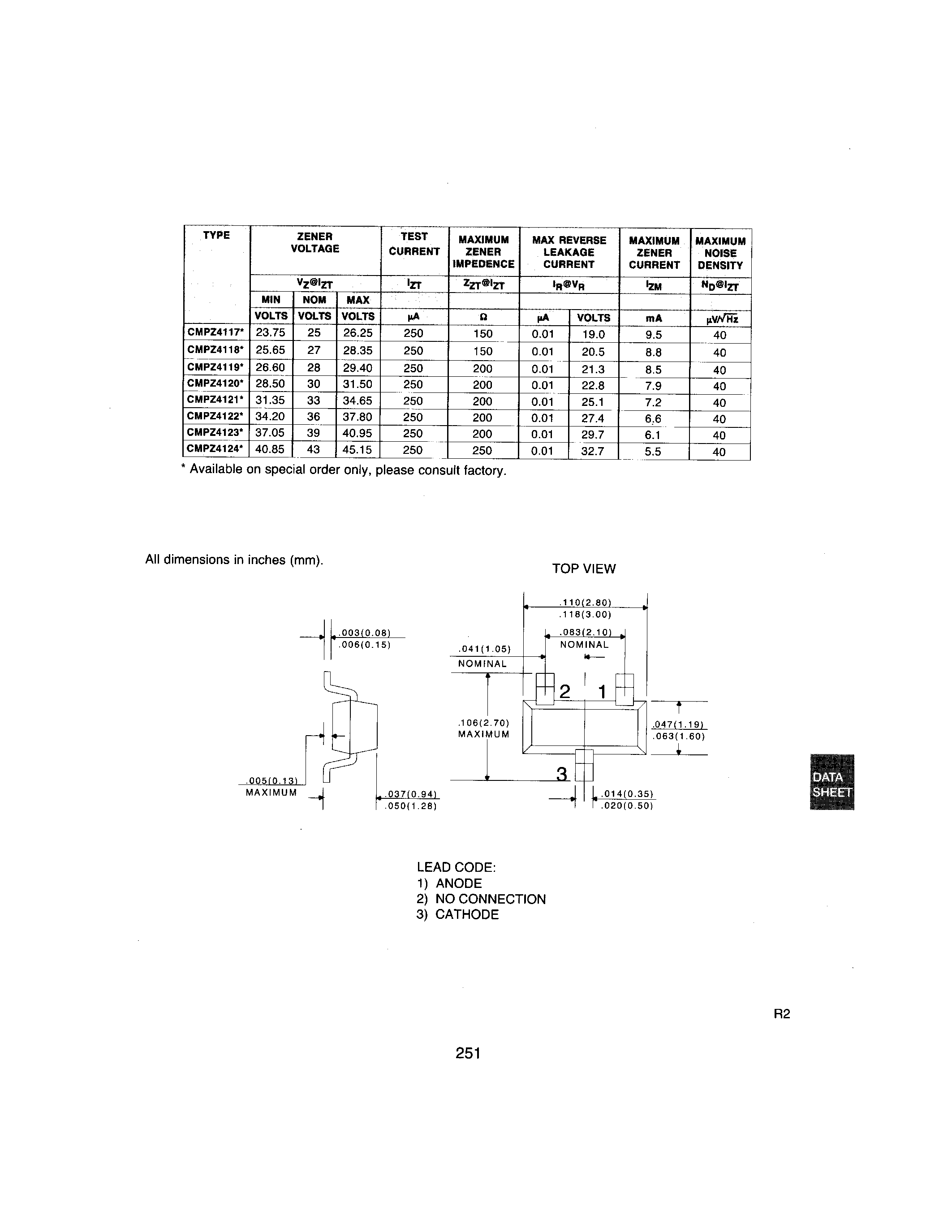

Datasheet CMPZ4099 - LOW NOISE ZENER DIODE 6.8 VOLTS THRU 43 VOLTS 350mW/5% TOLERANCE page 2
