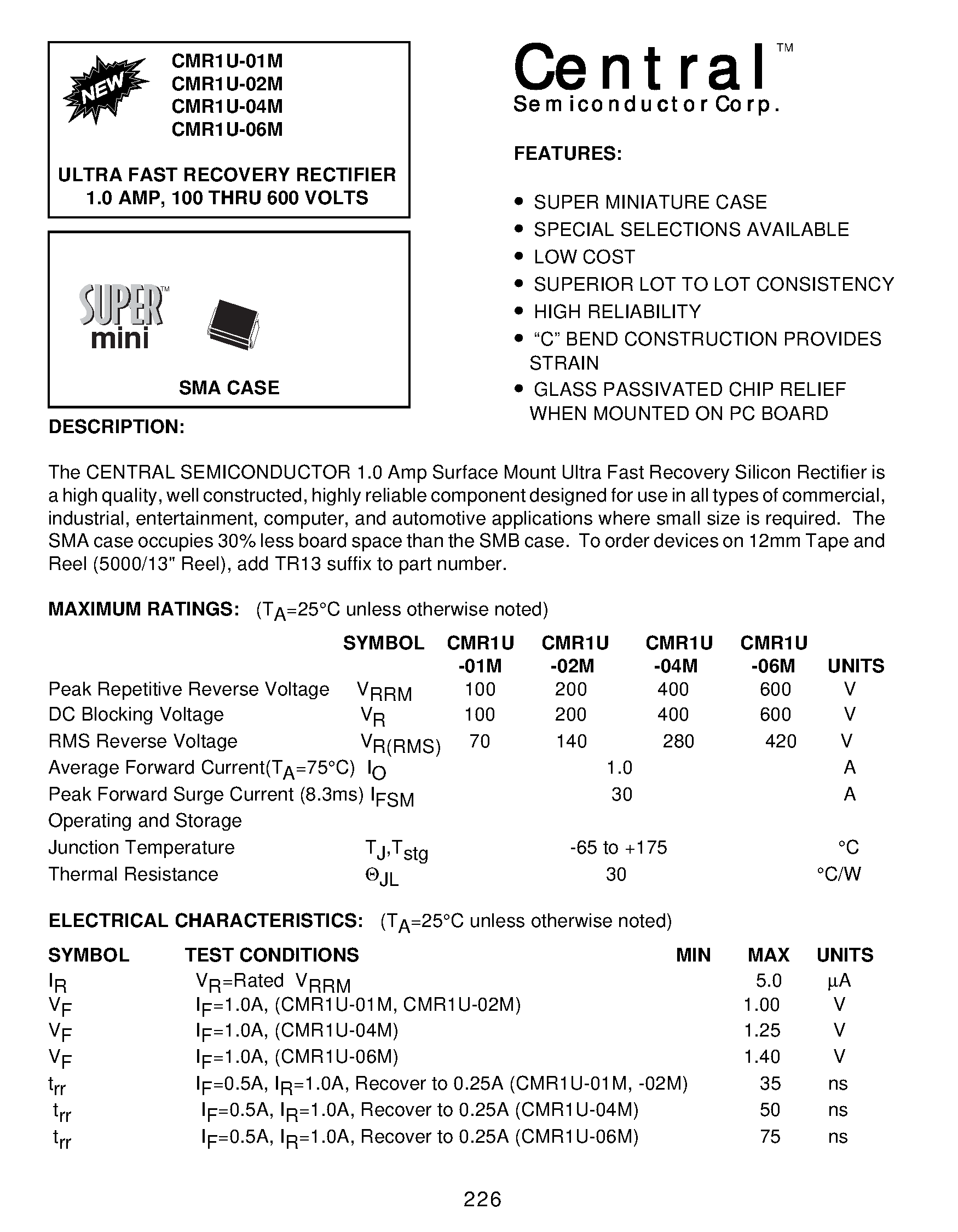

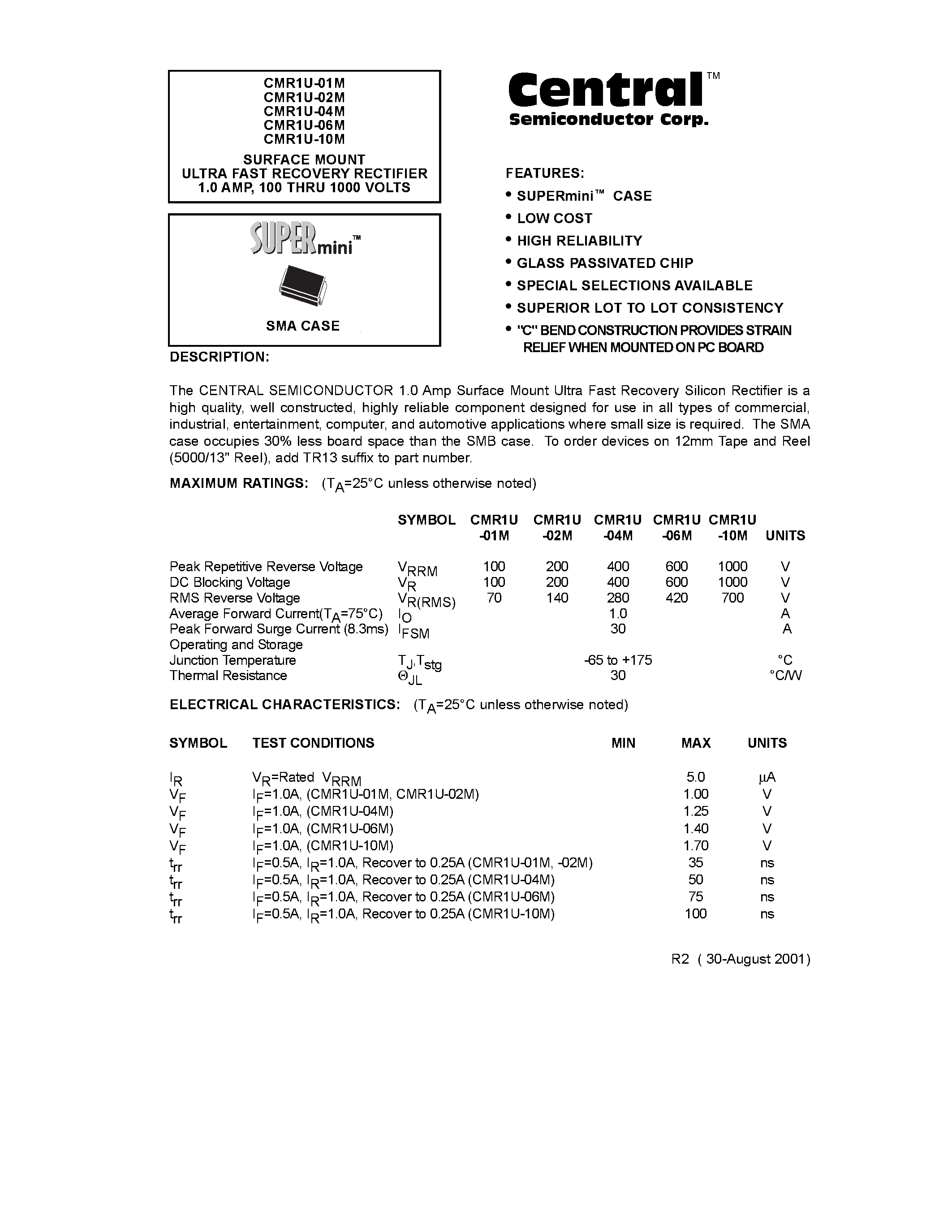

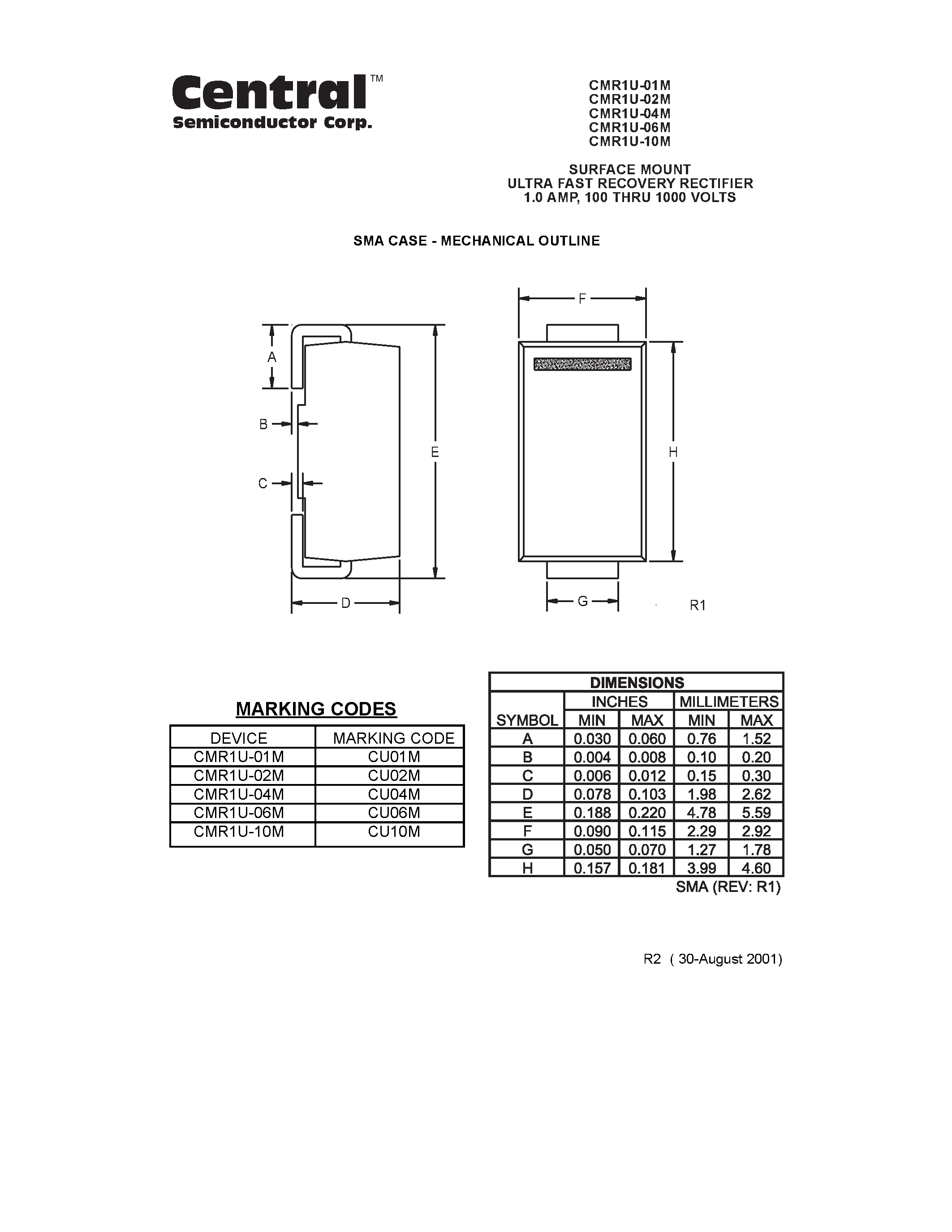

CMR1U-01M-SURFACE MOUNT ULTRA FAST RECOVERY RECTIFIER 1.0 AMP/ 100 THRU 1000 VOLTS
Producer:Central Semiconductor Corp
Description:SURFACE MOUNT ULTRA FAST RECOVERY RECTIFIER 1.0 AMP/ 100 THRU 1000 VOLTS
Others with the same file: CMR1U-01M
Datasheet CMR1U-01M - SURFACE MOUNT ULTRA FAST RECOVERY RECTIFIER 1.0 AMP/ 100 THRU 1000 VOLTS page 1
Datasheet CMR1U-01M - SURFACE MOUNT ULTRA FAST RECOVERY RECTIFIER 1.0 AMP/ 100 THRU 1000 VOLTS page 2
