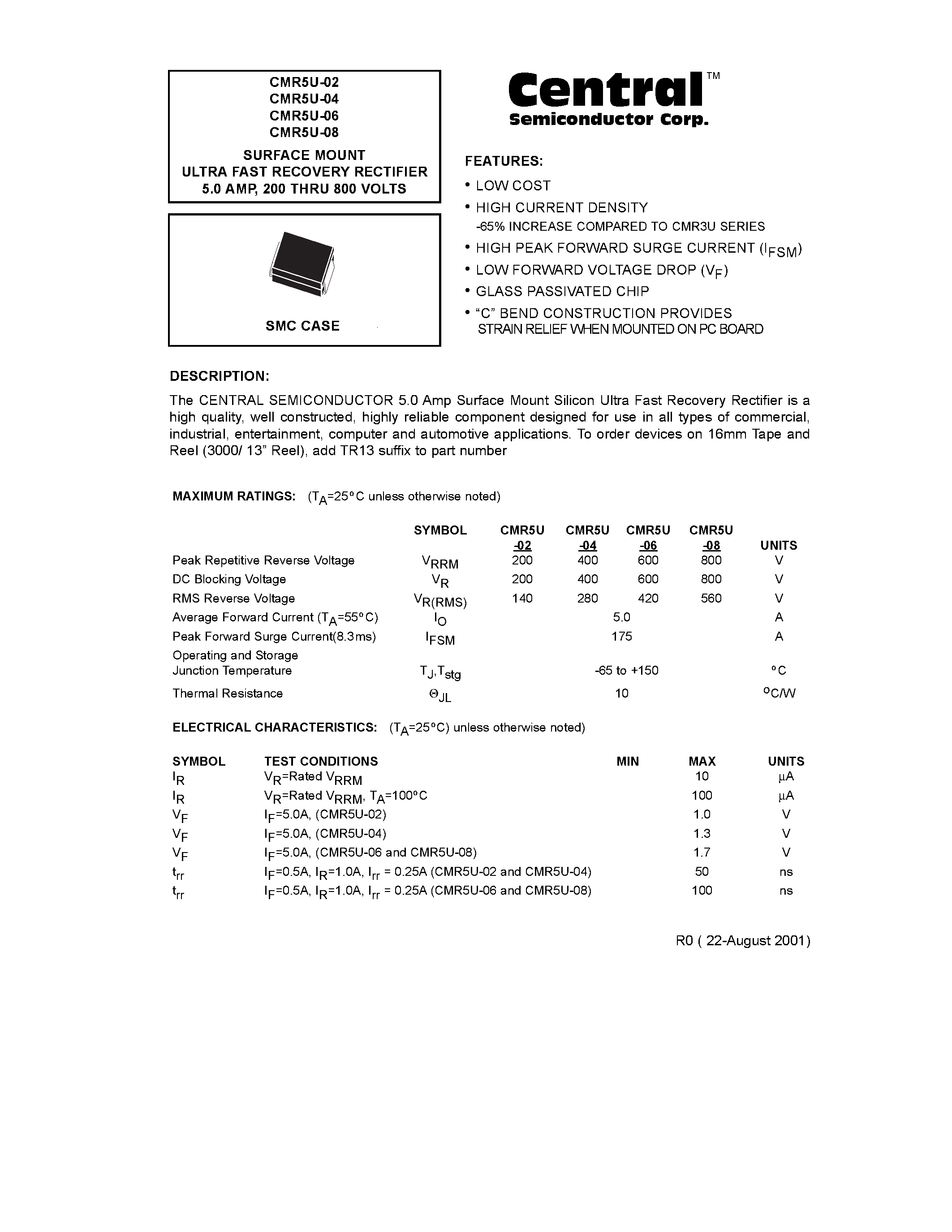

CMR5U-02-SURFACE MOUNT ULTRA FAST RECOVERY RECTIFIER 5.0 AMP/ 200 THRU 800 VOLTS
Producer:Central Semiconductor Corp
Description:SURFACE MOUNT ULTRA FAST RECOVERY RECTIFIER 5.0 AMP/ 200 THRU 800 VOLTS
Others with the same file: CMR5U-02
Datasheet CMR5U-02 - SURFACE MOUNT ULTRA FAST RECOVERY RECTIFIER 5.0 AMP/ 200 THRU 800 VOLTS page 1

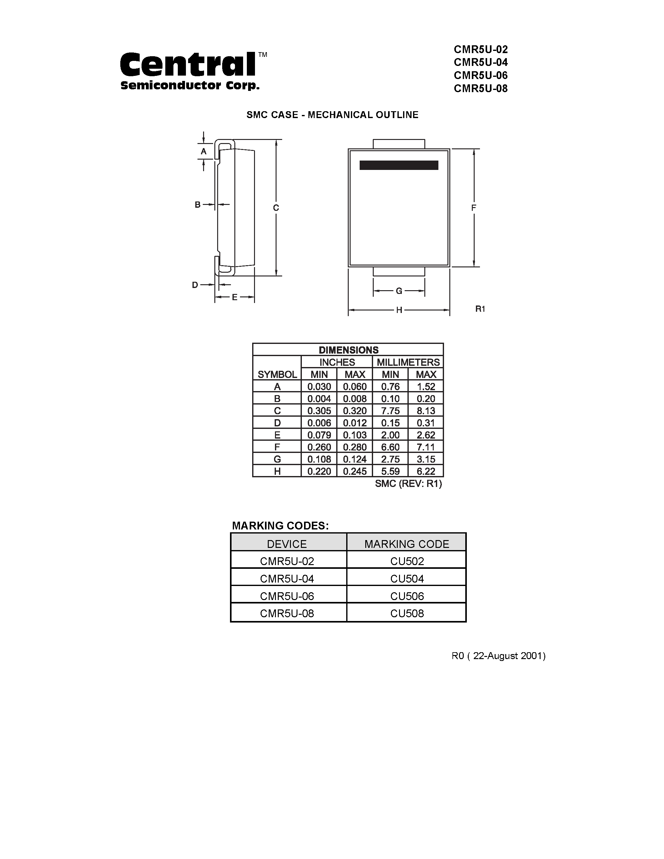

Datasheet CMR5U-02 - SURFACE MOUNT ULTRA FAST RECOVERY RECTIFIER 5.0 AMP/ 200 THRU 800 VOLTS page 2
