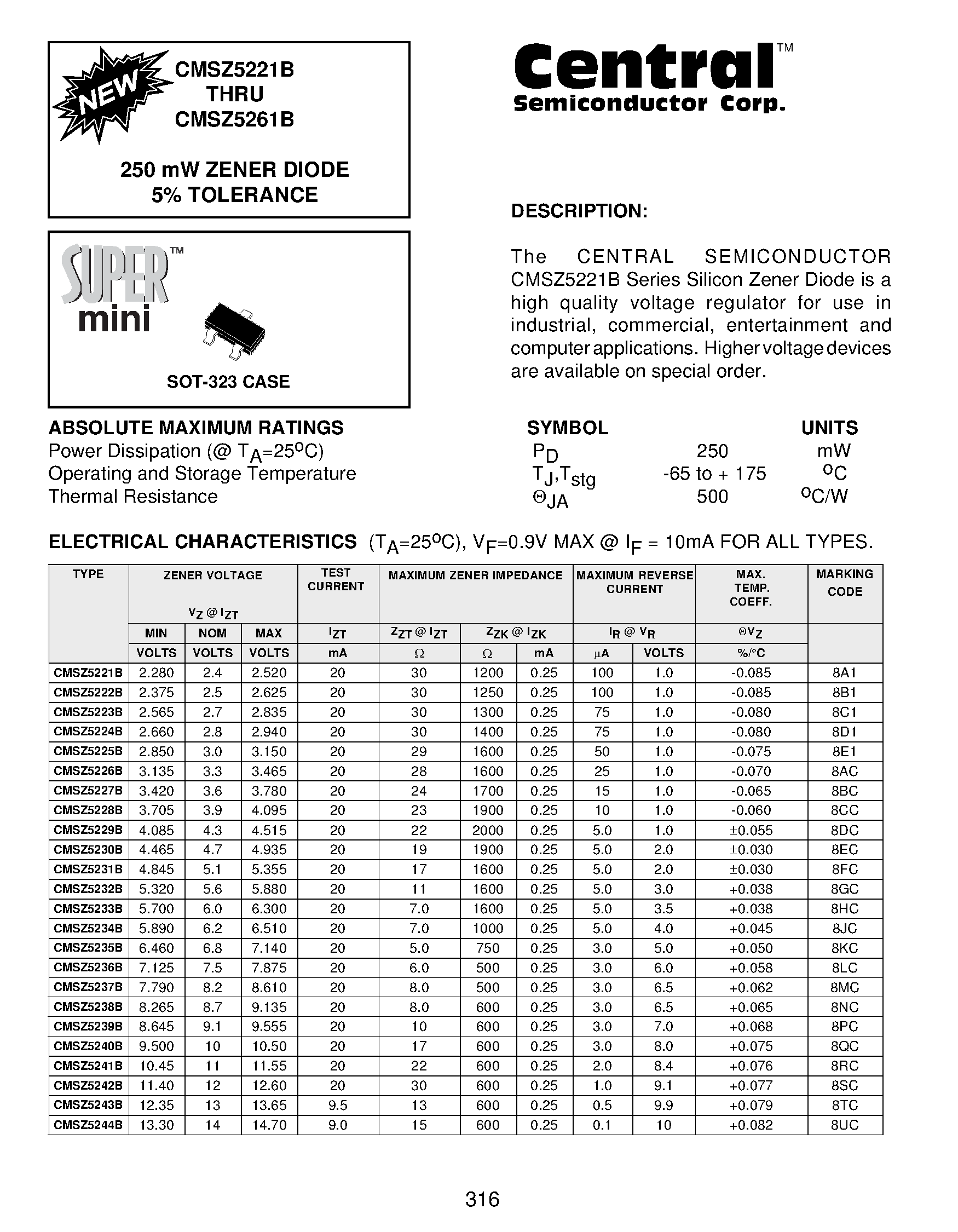

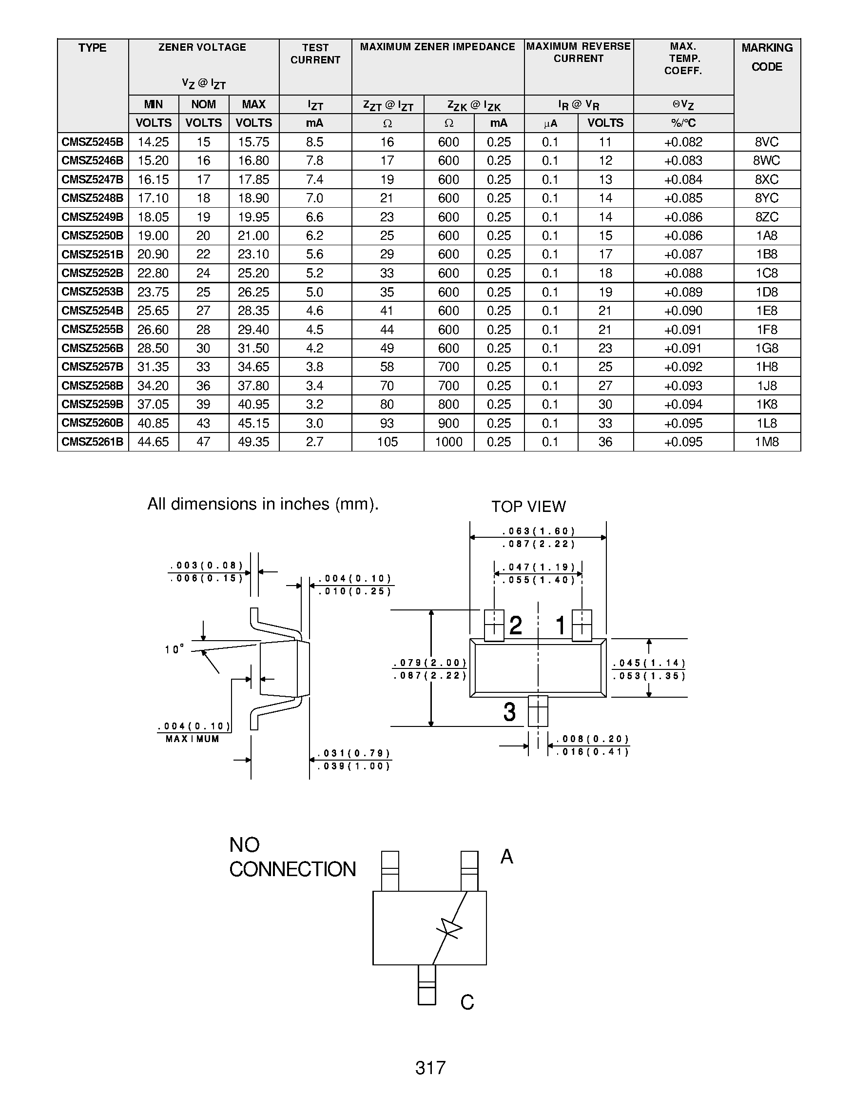

CMSZ5221B-250 mW ZENER DIODE 5% TOLERANCE
Producer:Central Semiconductor Corp
Description:250 mW ZENER DIODE 5% TOLERANCE
Others with the same file: CMSZ5221B
Datasheet CMSZ5221B - 250 mW ZENER DIODE 5% TOLERANCE page 1
Datasheet CMSZ5221B - 250 mW ZENER DIODE 5% TOLERANCE page 2
