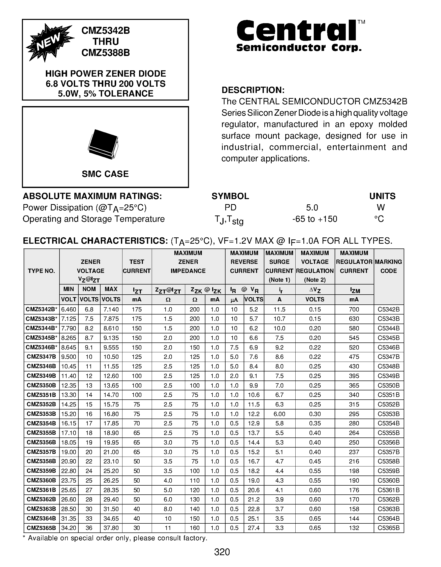

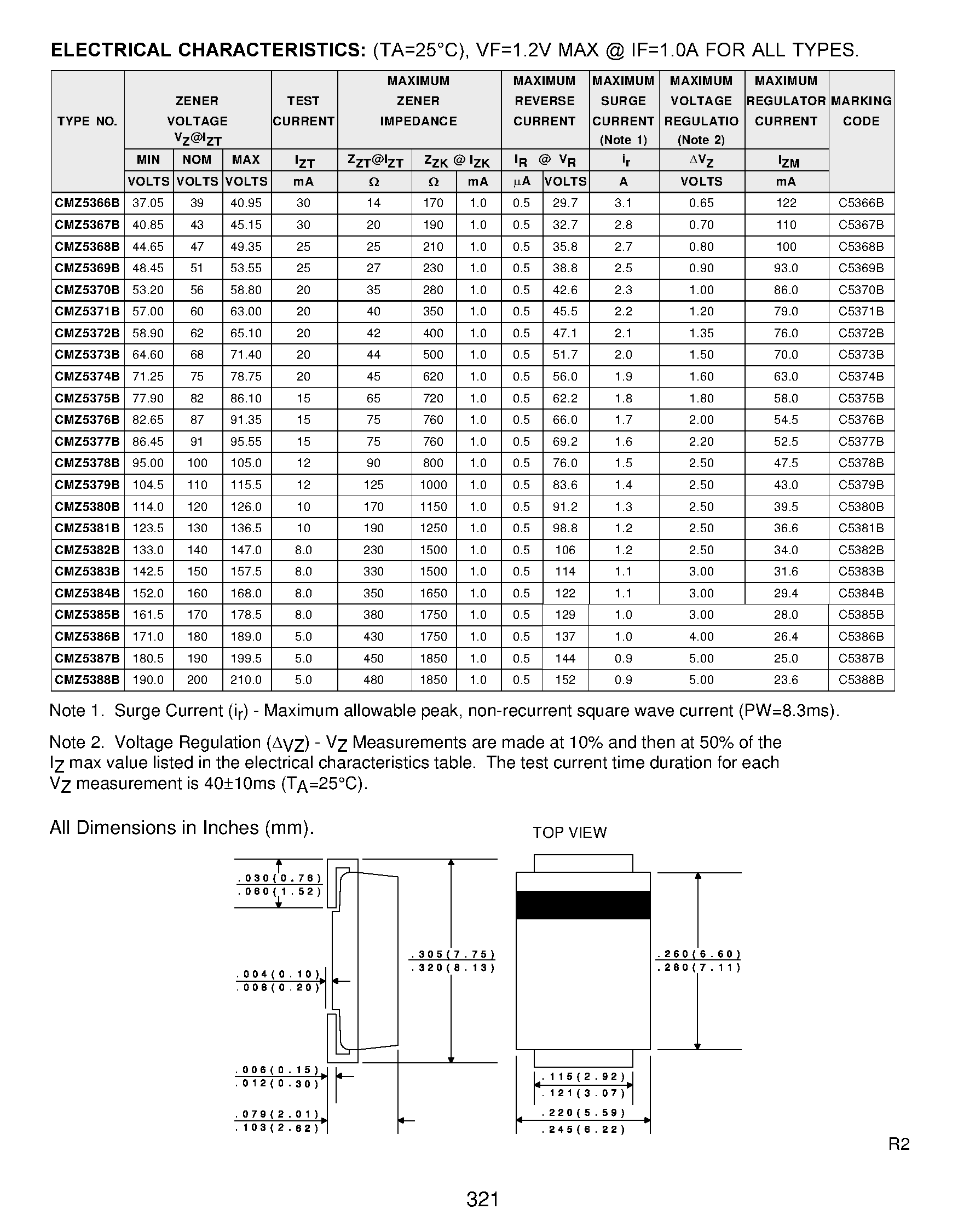

CMZ5342B-HIGH POWER ZENER DIODE 6.8 VOLTS THRU 200 VOLTS 5.0W/ 5% TOLERANCE
Producer:Central Semiconductor Corp
Description:HIGH POWER ZENER DIODE 6.8 VOLTS THRU 200 VOLTS 5.0W/ 5% TOLERANCE
Others with the same file: CMZ5342B
Datasheet CMZ5342B - HIGH POWER ZENER DIODE 6.8 VOLTS THRU 200 VOLTS 5.0W/ 5% TOLERANCE page 1
Datasheet CMZ5342B - HIGH POWER ZENER DIODE 6.8 VOLTS THRU 200 VOLTS 5.0W/ 5% TOLERANCE page 2
