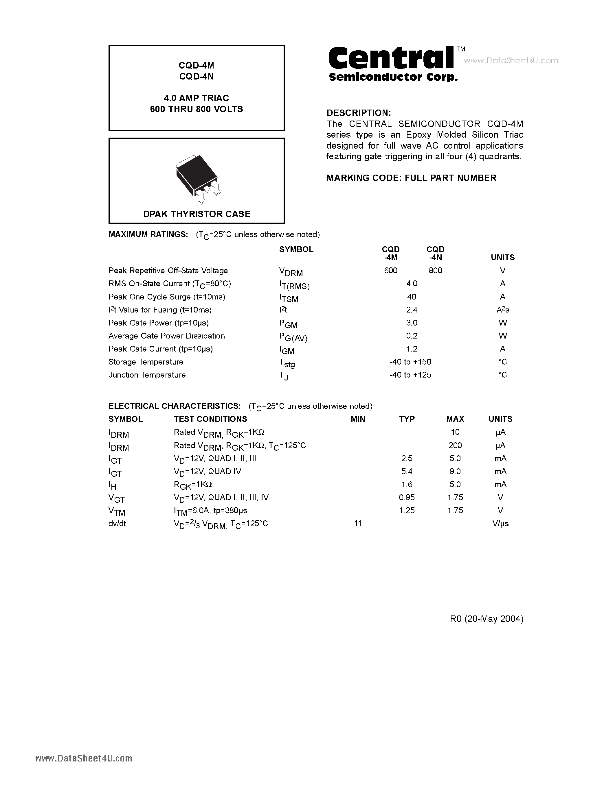

CQD-4N-4.0 AMP TRIAC 600 THRU 800 VOLTS
Producer:Central Semiconductor
Description:4.0 AMP TRIAC 600 THRU 800 VOLTS
Others with the same file: CQD-4N
Datasheet CQD-4N - 4.0 AMP TRIAC 600 THRU 800 VOLTS page 1

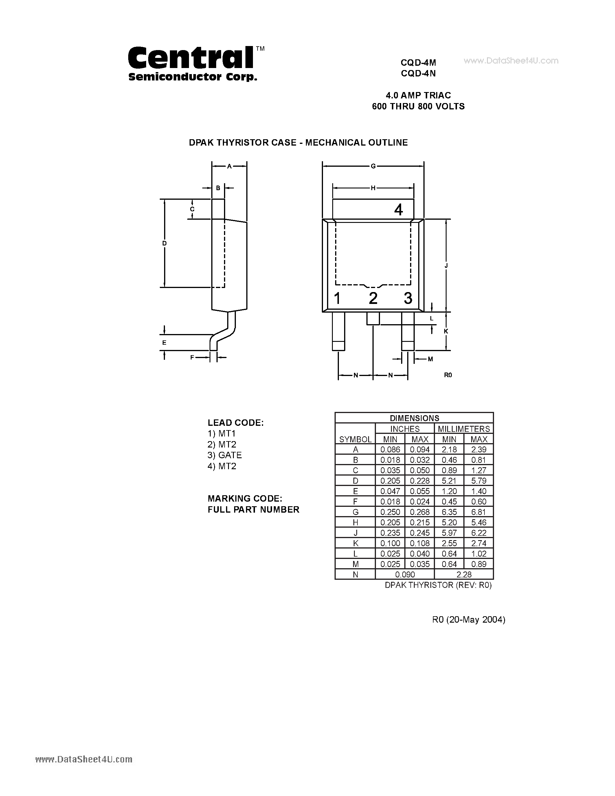

Datasheet CQD-4N - 4.0 AMP TRIAC 600 THRU 800 VOLTS page 2
