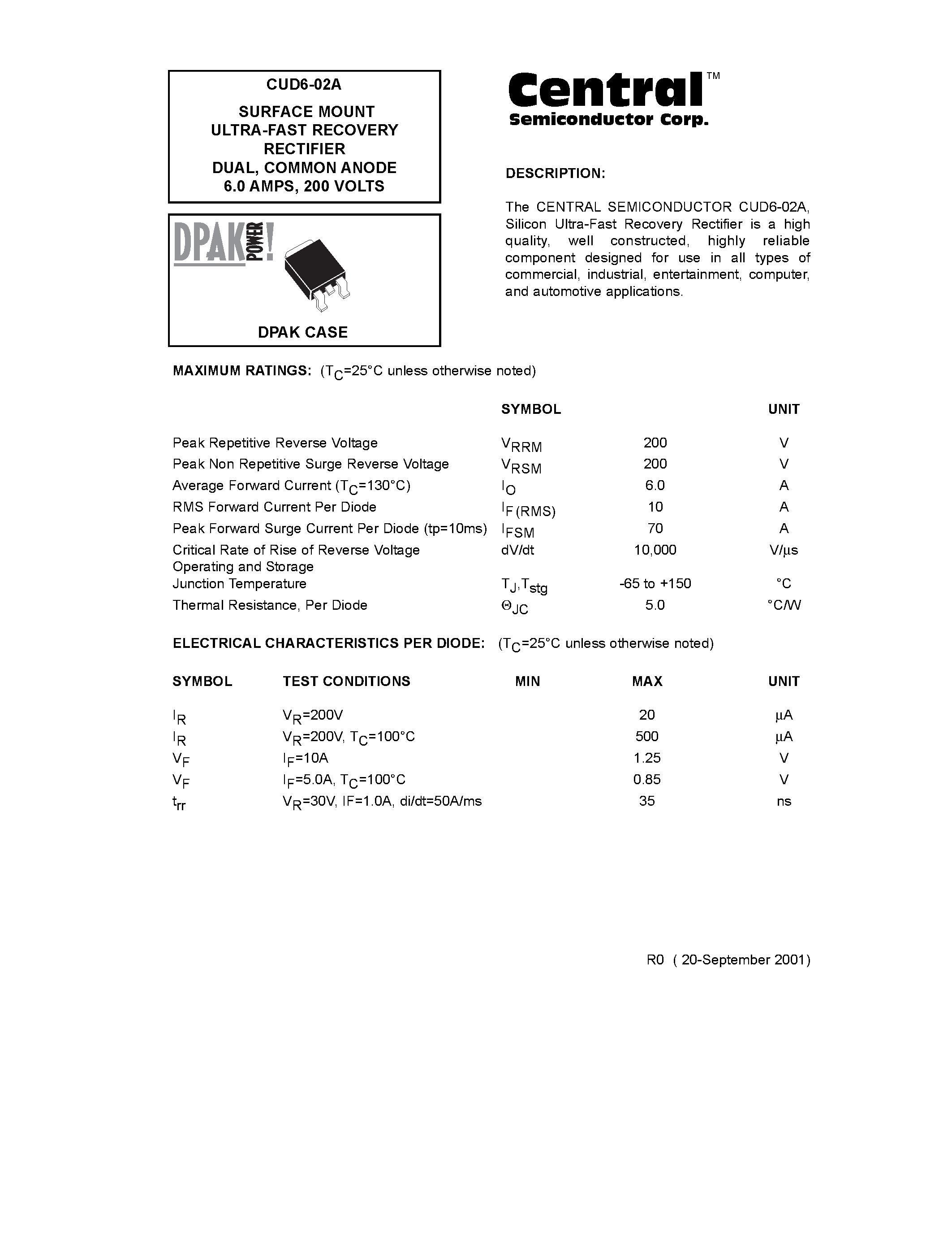

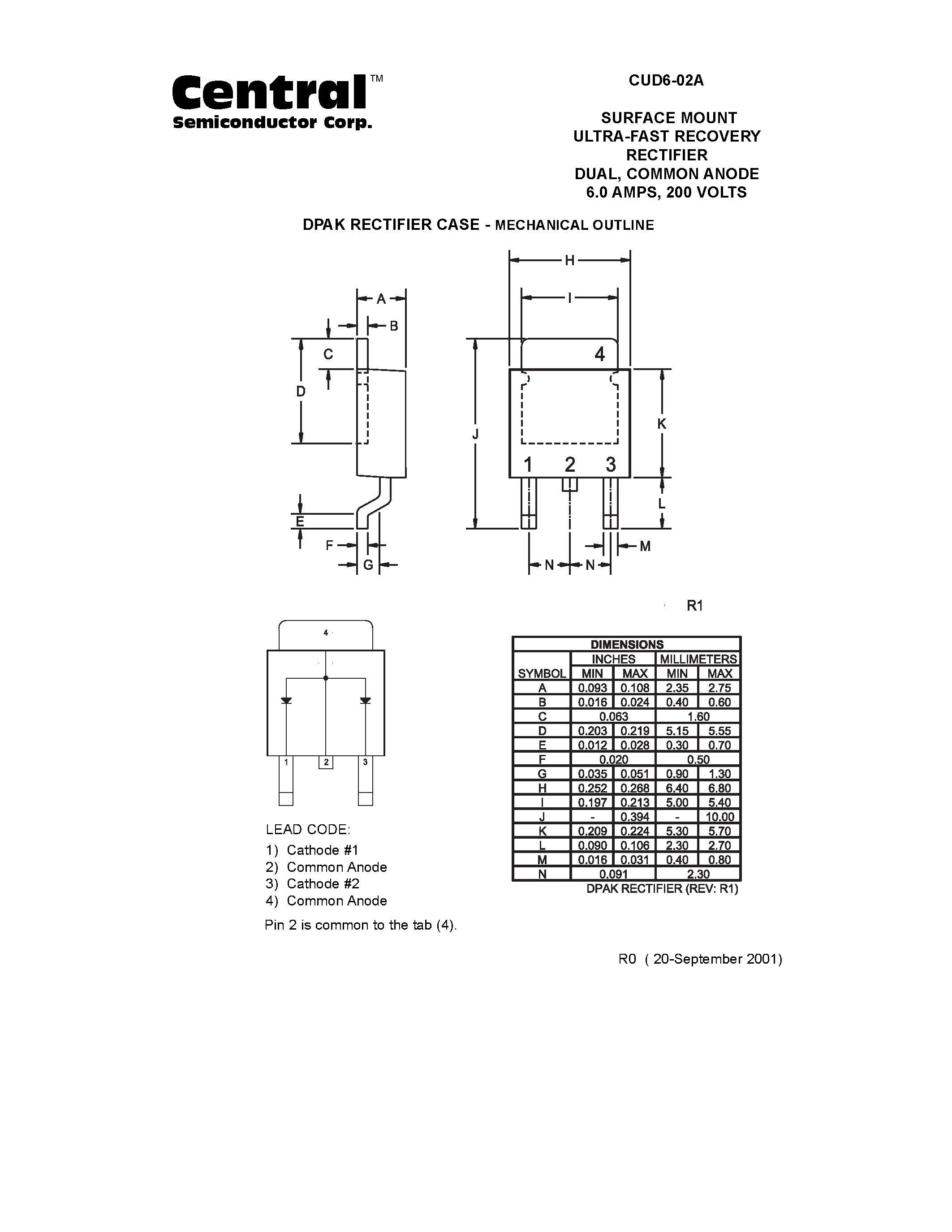

CUD6-02A-SURFACE MOUNT ULTRA-FAST RECOVERY RECTIFIER DUAL/ COMMON ANODE 6.0 AMPS/ 200 VOLTS
Producer:Central Semiconductor Corp
Description:SURFACE MOUNT ULTRA-FAST RECOVERY RECTIFIER DUAL/ COMMON ANODE 6.0 AMPS/ 200 VOLTS
