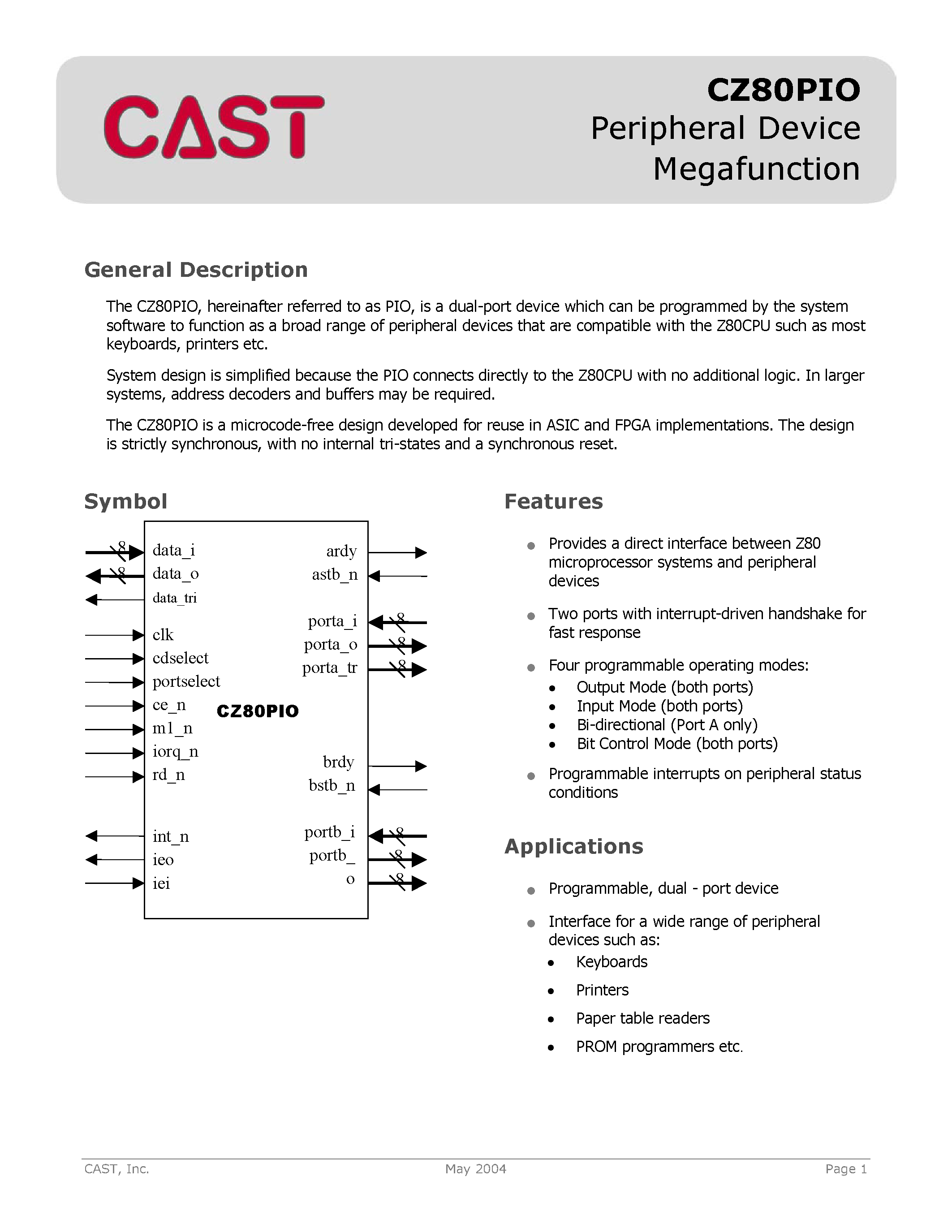

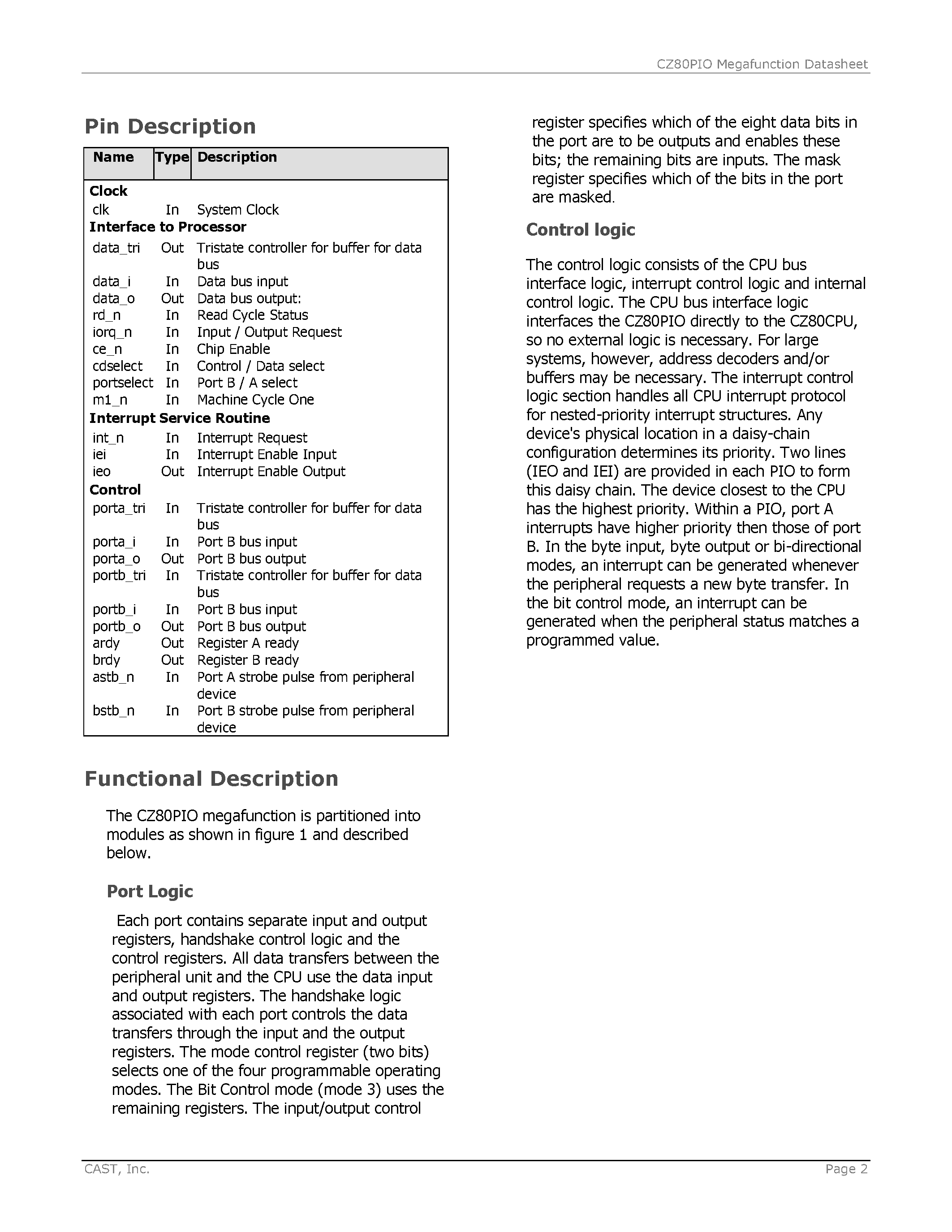

CZ80PIO-Hereinafter Referred to As PIO is a Dual-Port Device
Producer:CAST
Description:Hereinafter Referred to As PIO is a Dual-Port Device
