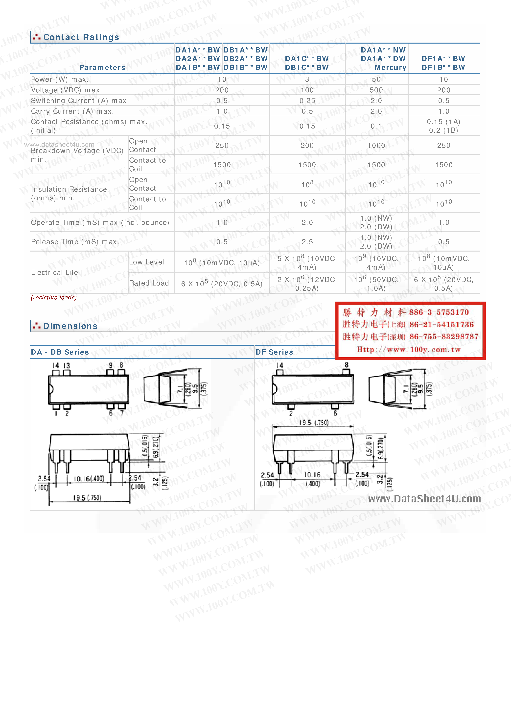

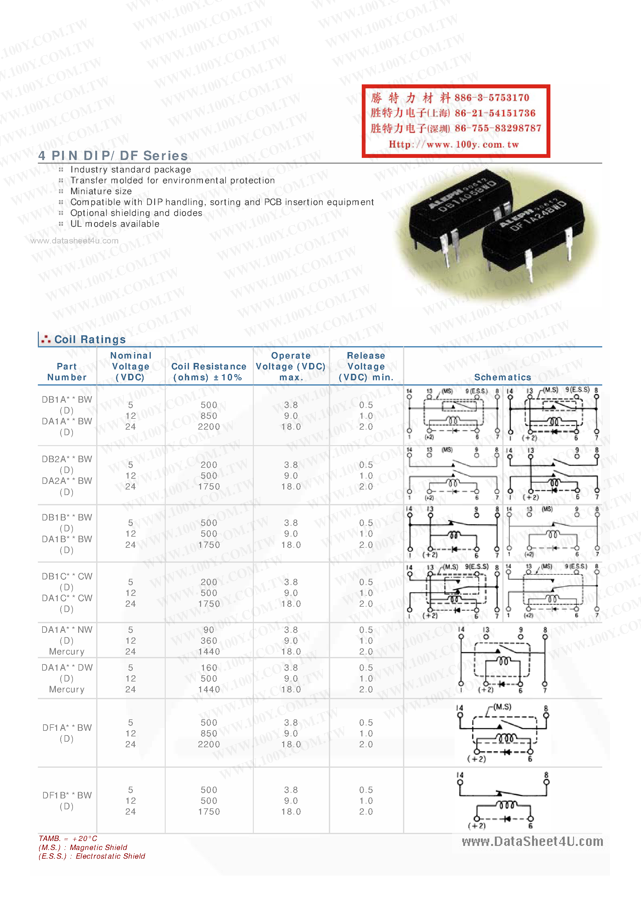

DB1C05CW-4 Pin DIP/DF
Producer:ETC
Description:4 Pin DIP/DF
Others with the same file: DB1C05CW | DB1C12CW
DB1C24CW
Datasheet DB1C05CW - 4 Pin DIP/DF page 1
Datasheet DB1C05CW - 4 Pin DIP/DF page 2
