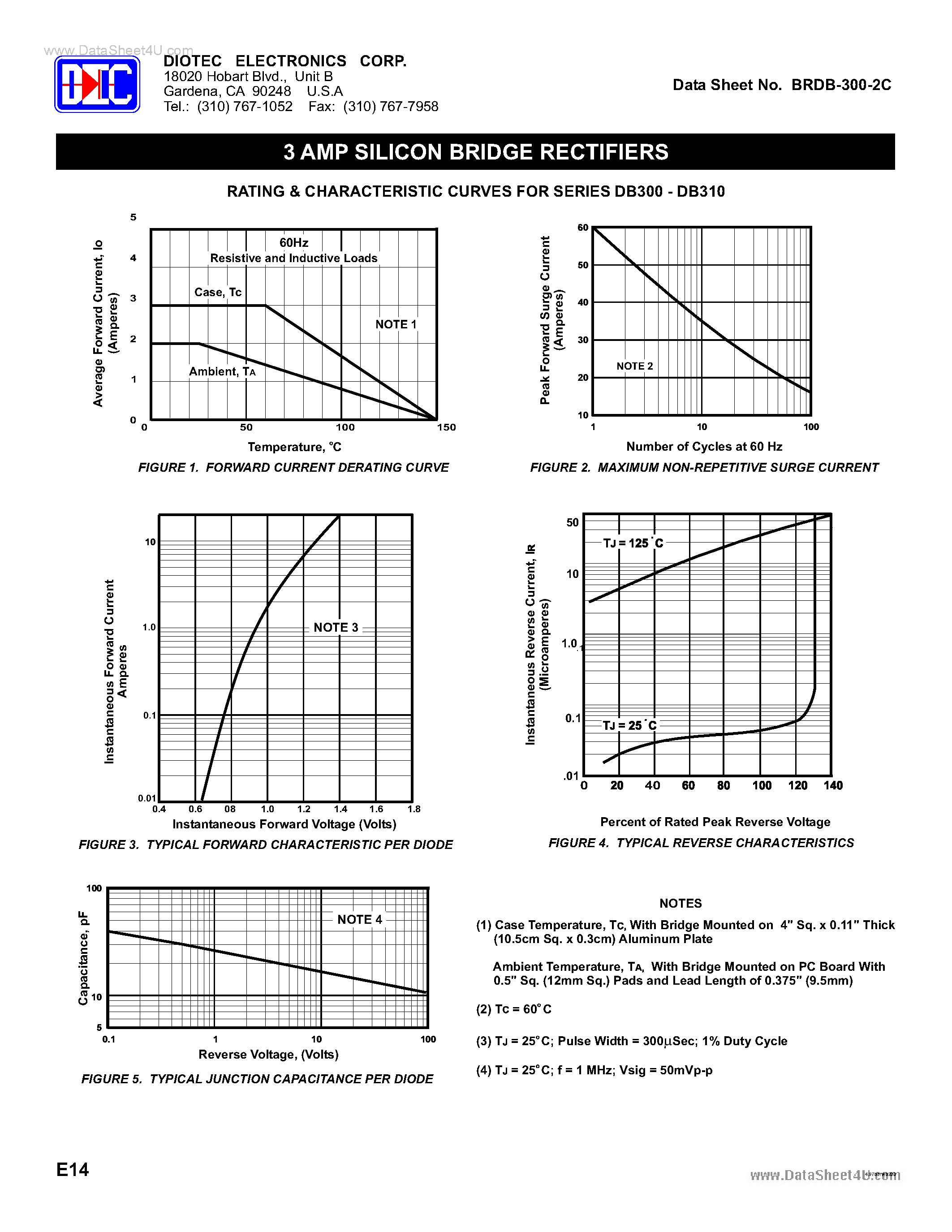

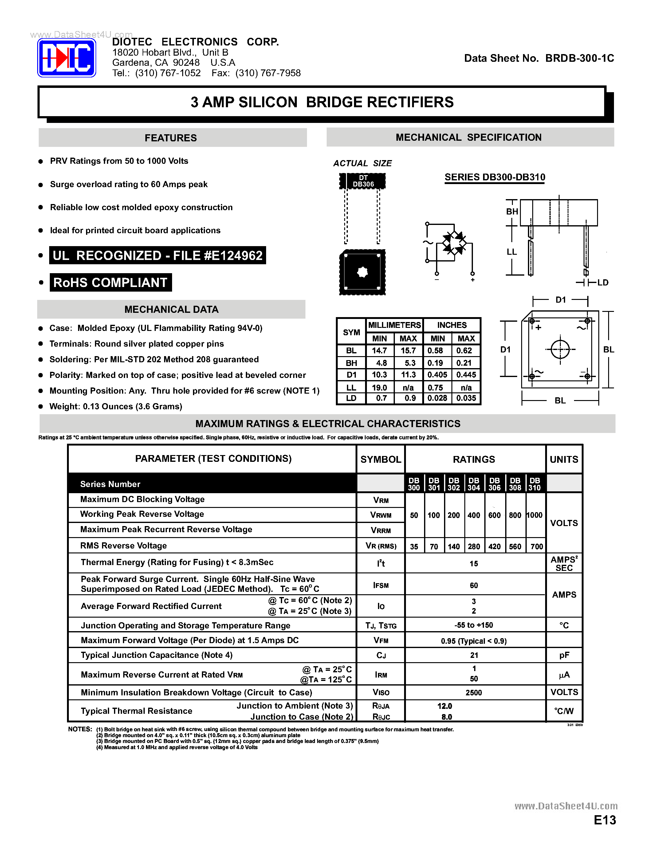

DB300-(DB300 - DB310) 3 AMP SILICON BRIDGE RECTIFIERS
Producer:Diotec Semiconductor
Description:(DB300 - DB310) 3 AMP SILICON BRIDGE RECTIFIERS
Others with the same file: DB300 | DB301
DB302 | DB304
DB308 | DB310
Datasheet DB300 - (DB300 - DB310) 3 AMP SILICON BRIDGE RECTIFIERS page 1
Datasheet DB300 - (DB300 - DB310) 3 AMP SILICON BRIDGE RECTIFIERS page 2
