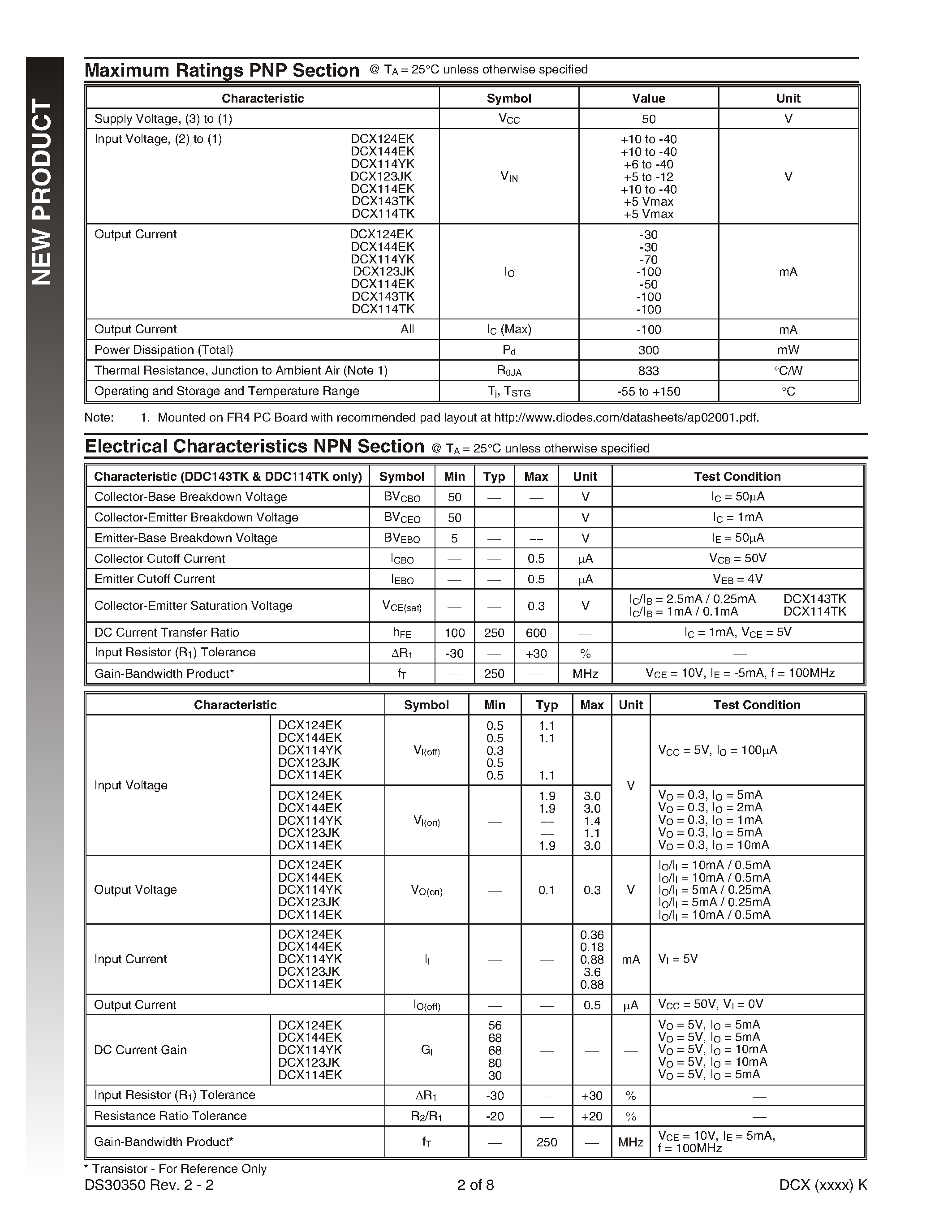

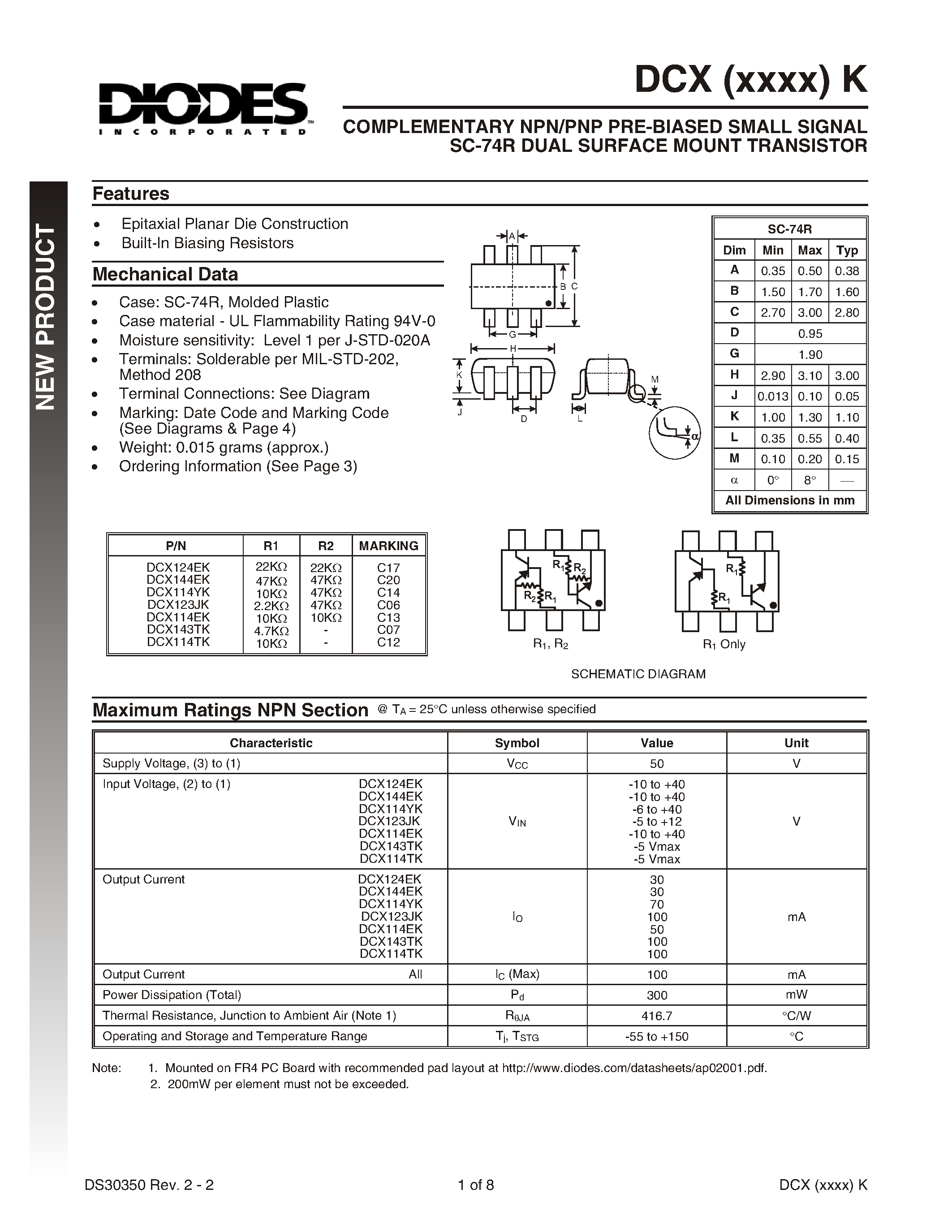

DCX114EK-7-COMPLEMENTARY NPN/PNP PRE-BIASED SMALL SIGNAL SC-74R DUAL SURFACE MOUNT TRANSISTOR
Producer:Diodes Incorporated
Description:COMPLEMENTARY NPN/PNP PRE-BIASED SMALL SIGNAL SC-74R DUAL SURFACE MOUNT TRANSISTOR
Others with the same file: DCX114EK-7
Datasheet DCX114EK-7 - COMPLEMENTARY NPN/PNP PRE-BIASED SMALL SIGNAL SC-74R DUAL SURFACE MOUNT TRANSISTOR page 1
Datasheet DCX114EK-7 - COMPLEMENTARY NPN/PNP PRE-BIASED SMALL SIGNAL SC-74R DUAL SURFACE MOUNT TRANSISTOR page 2
