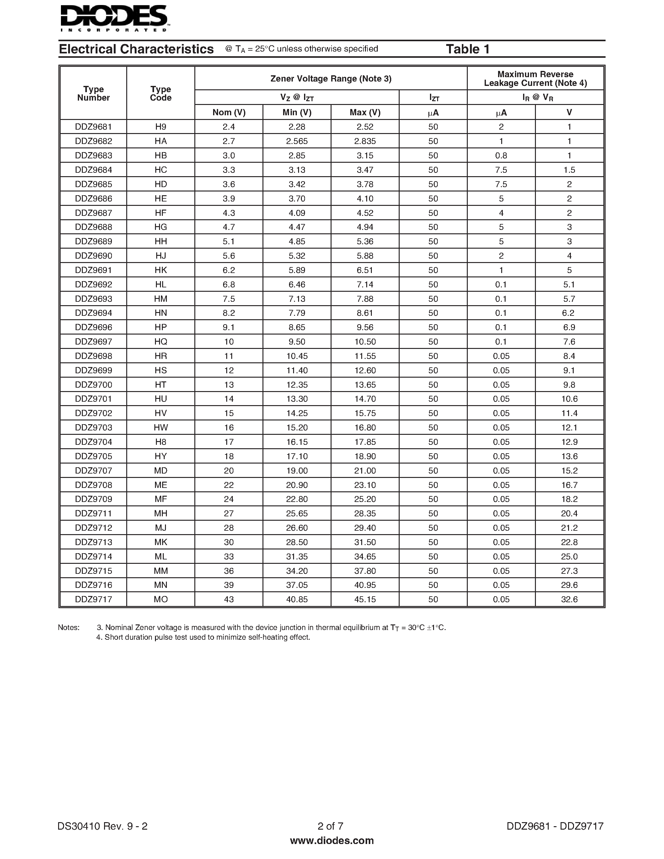

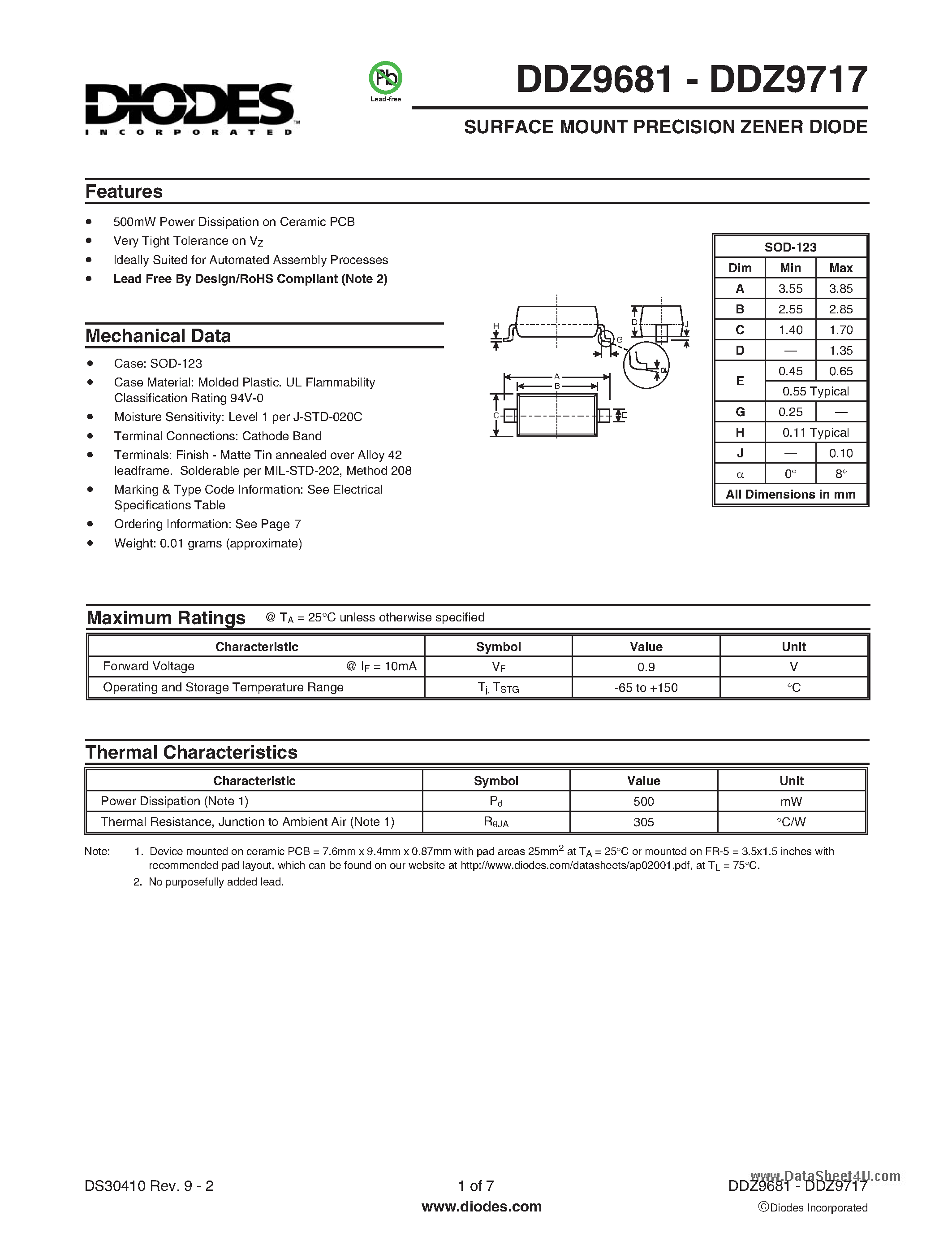

DDZ9681-(DDZ9681 - DDZ9717) SURFACE MOUNT PRECISION ZENER DIODE
Producer:Diodes Incorporated
Description:(DDZ9681 - DDZ9717) SURFACE MOUNT PRECISION ZENER DIODE
