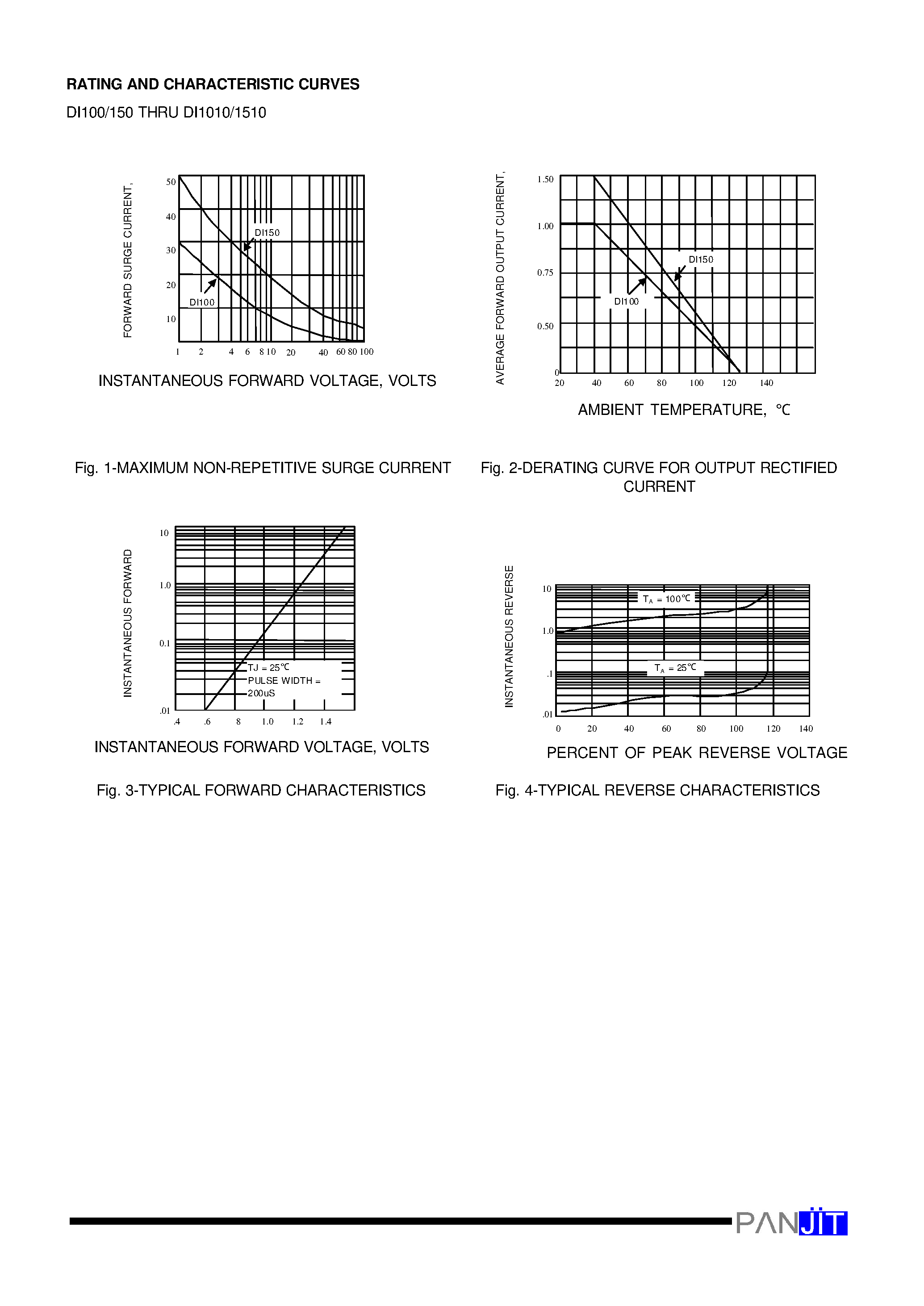

DI1010-DUAL-IN-LINE GLASS PASSIVATED SINGLE-PHASE BRIDGE RECTIFIER(VOLTAGE - 50 to 1000 Volts CURRENT - 1.0~1.5 Amperes)
Producer:Pan Jit International Inc.
Description:DUAL-IN-LINE GLASS PASSIVATED SINGLE-PHASE BRIDGE RECTIFIER(VOLTAGE - 50 to 1000 Volts CURRENT - 1.0~1.5 Amperes)
Others with the same file: DI1010
Datasheet DI1010 - DUAL-IN-LINE GLASS PASSIVATED SINGLE-PHASE BRIDGE RECTIFIER(VOLTAGE - 50 to 1000 Volts CURRENT - 1.0~1.5 Amperes) page 1
Datasheet DI1010 - DUAL-IN-LINE GLASS PASSIVATED SINGLE-PHASE BRIDGE RECTIFIER(VOLTAGE - 50 to 1000 Volts CURRENT - 1.0~1.5 Amperes) page 2
