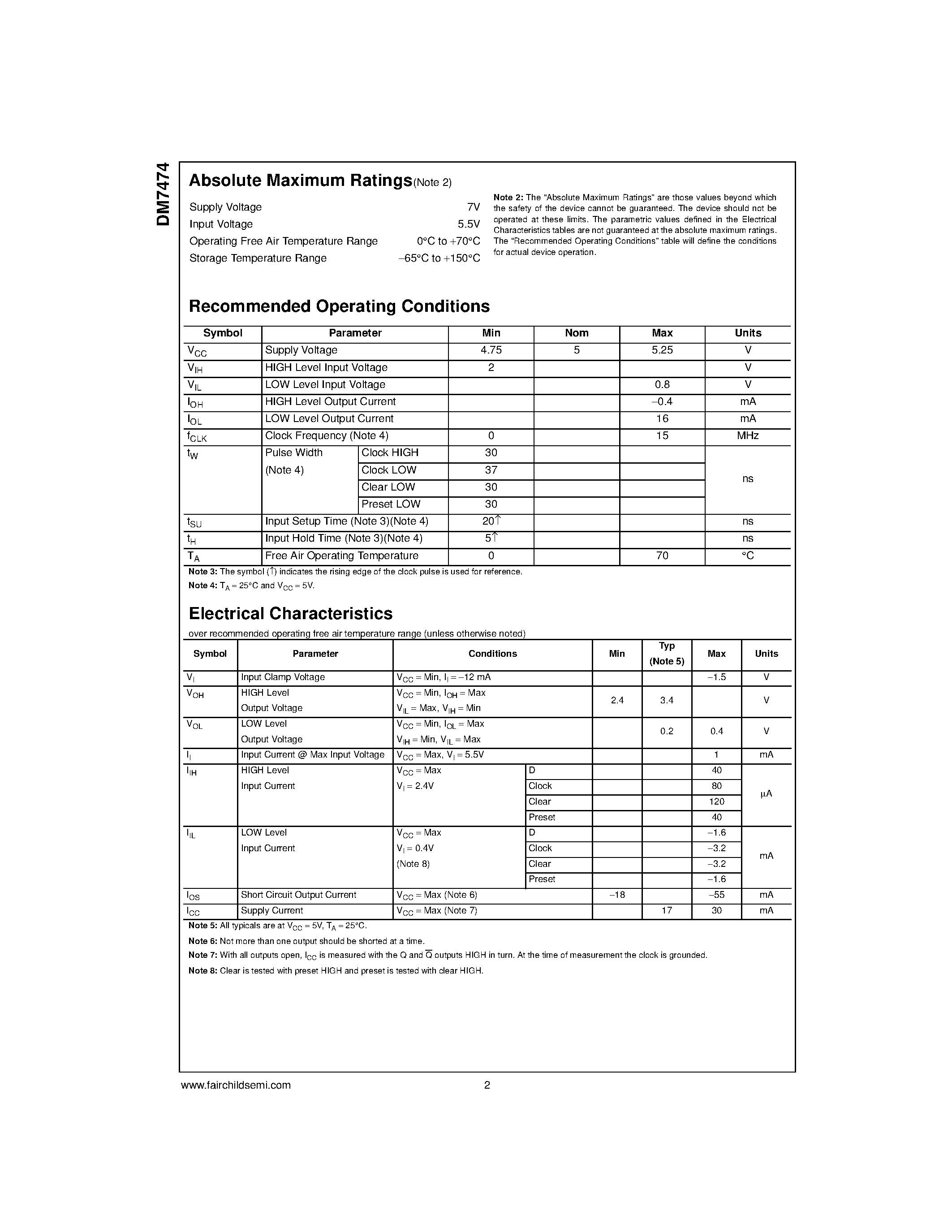

DM7474M-Dual Positive-Edge-Triggered D-Type Flip-Flops with Preset/ Clear and Complementary Outputs
Description:Dual Positive-Edge-Triggered D-Type Flip-Flops with Preset/ Clear and Complementary Outputs
Others with the same file: DM7474M
Datasheet DM7474M - Dual Positive-Edge-Triggered D-Type Flip-Flops with Preset/ Clear and Complementary Outputs page 1
Datasheet DM7474M - Dual Positive-Edge-Triggered D-Type Flip-Flops with Preset/ Clear and Complementary Outputs page 2
