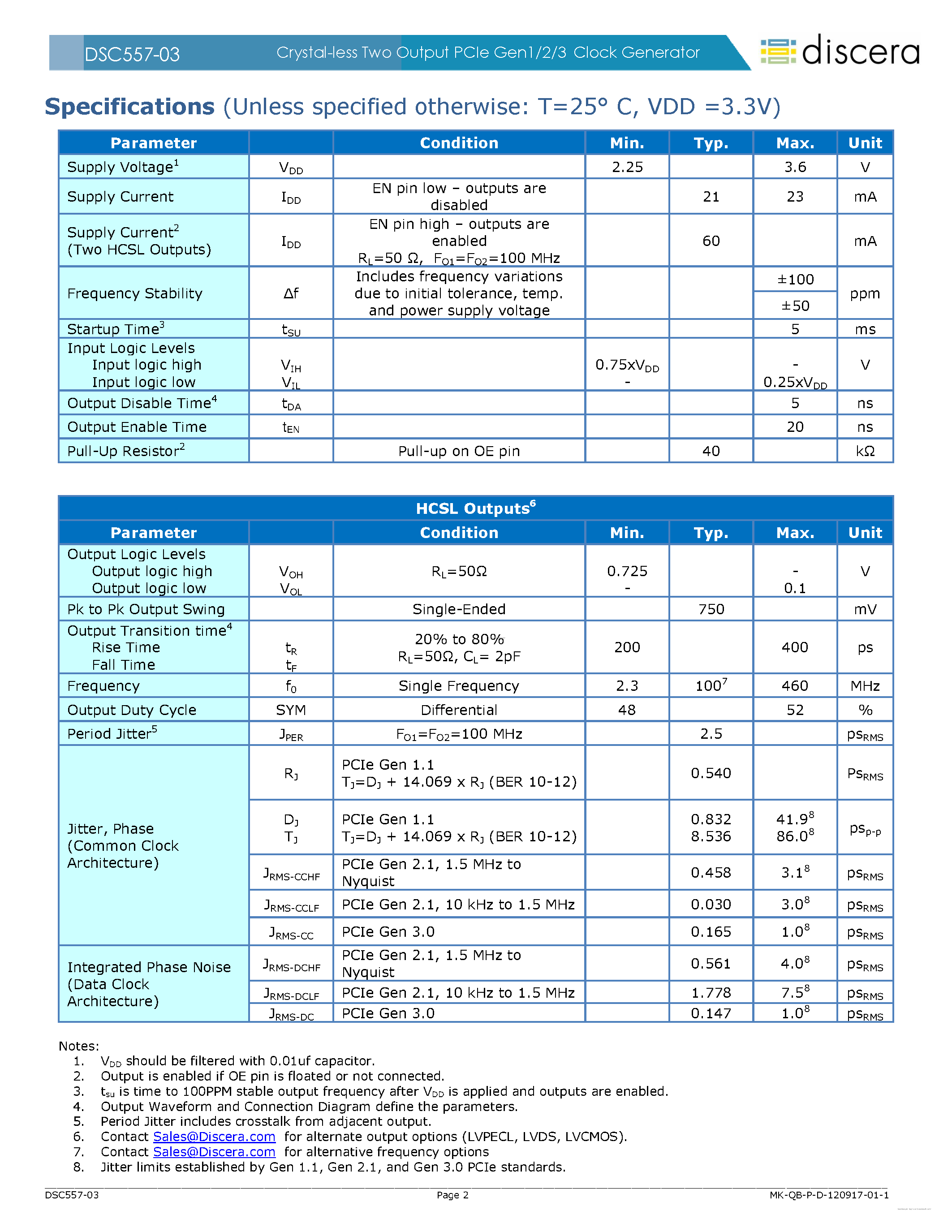

DSC557-03-Crystal-less Two Output PCIe Gen1/2/3 Clock Generator
Producer:Discera
Description:Crystal-less Two Output PCIe Gen1/2/3 Clock Generator
