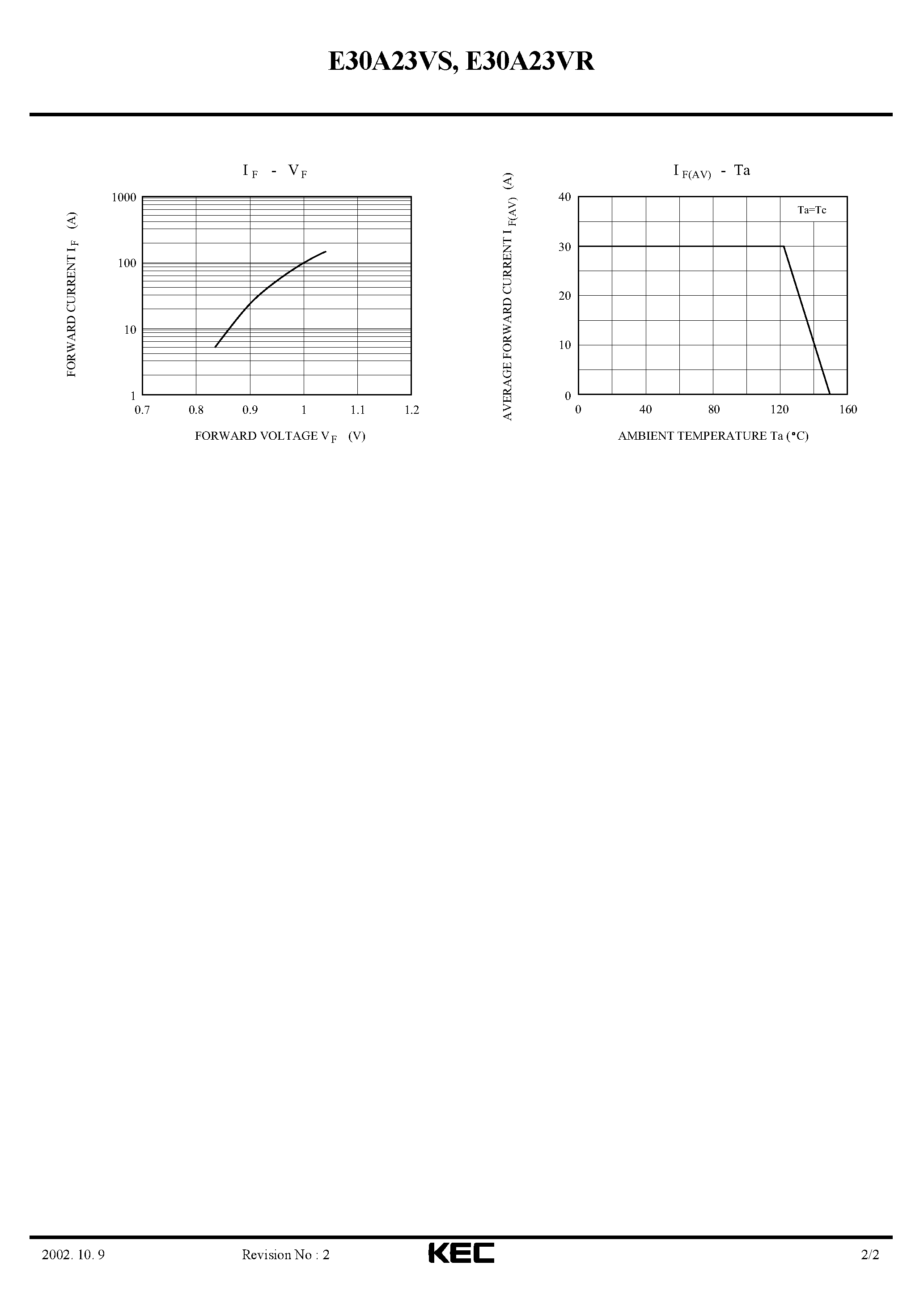

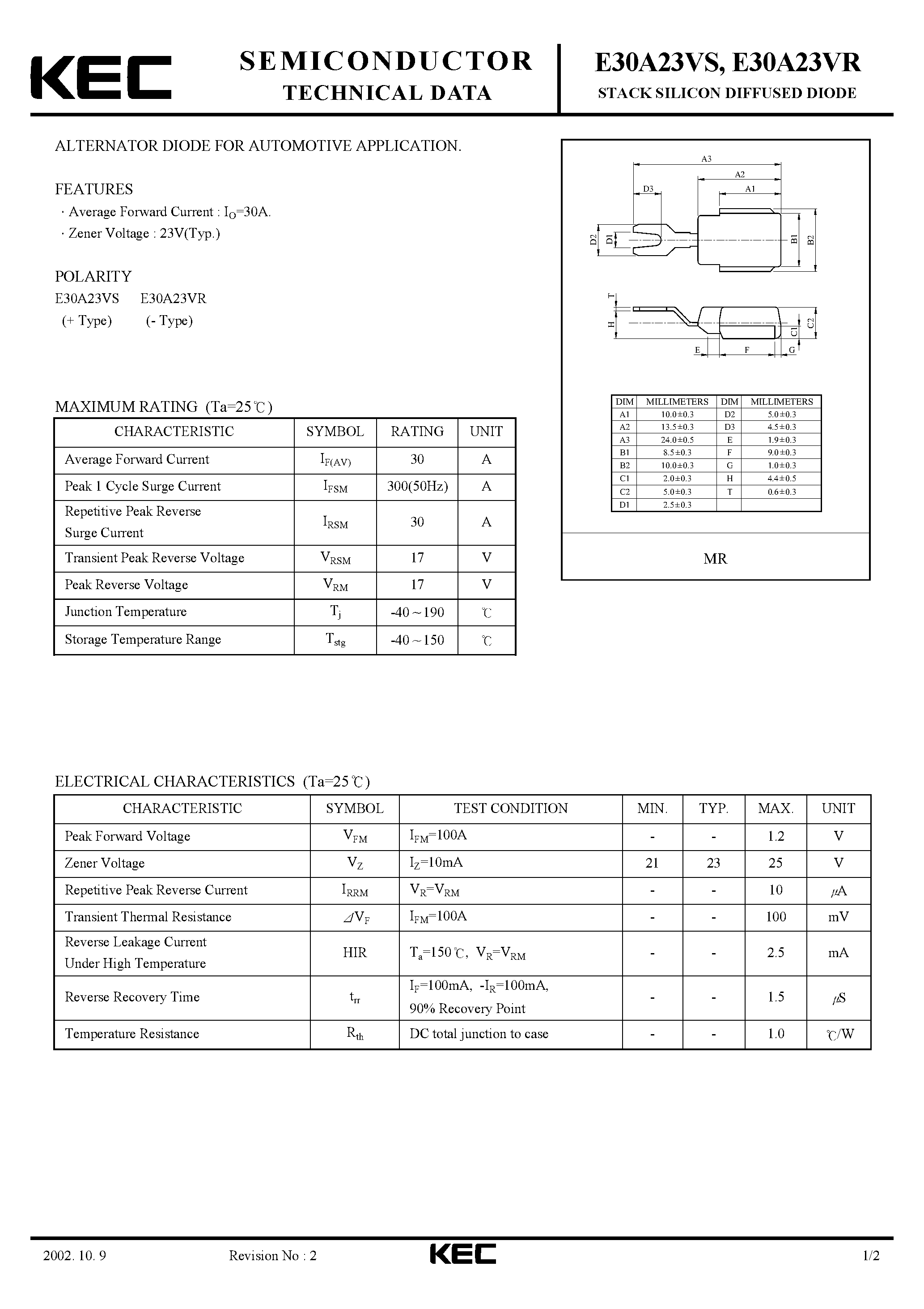

E30A23VR-STACK SILICON DIFFUSED DIODE (ALTERNATOR DIODE FOR AUTOMOTIVE)
Producer:KEC(Korea Electronics)
Description:STACK SILICON DIFFUSED DIODE (ALTERNATOR DIODE FOR AUTOMOTIVE)
Others with the same file: E30A23VR
Datasheet E30A23VR - STACK SILICON DIFFUSED DIODE (ALTERNATOR DIODE FOR AUTOMOTIVE) page 1
Datasheet E30A23VR - STACK SILICON DIFFUSED DIODE (ALTERNATOR DIODE FOR AUTOMOTIVE) page 2
